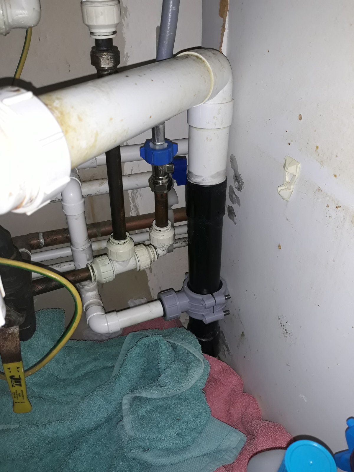

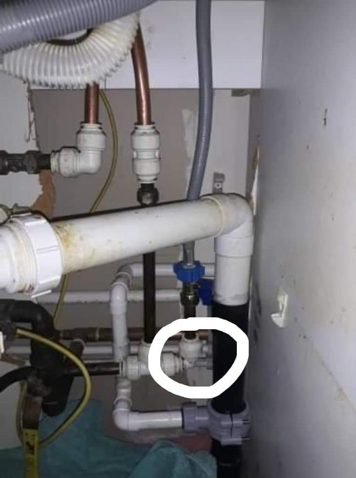

20191117_112926.jpg 20191117_112921.jpg Hi everyone, I am having a problem ( I think) with the pushfit fitting that my pipe and washing machine valve are plumbed in to. If I grab the pipe I can rotate it a little. Should j be able yo do this if the fitting is working? Also on the same pipe at the top is my washing machine valve fitting this gradually turns on the pipe over time and moves round due to the pipe moving at the bottom. Are this fittings supposed to let the pipe rotate?

The design of a pushfit fitting means the pipe can rotate but it's likely to end up leaking especially if they are old fittings.
They can rotate, but try and avoid moving them if you can. They may leak if constantly moved. If its an issue, fit a pipe clip or clips to prevent rotation.
Thank you so much. They wont automatically blow off will they? Where can I get the clips from? They are about 12 years old. I had a plumber out to look but he said they don't need replacing. My concern is, if its rotating when machine is on, one day it will just fall off.
You can use cable ties to secure them to other pipes etc to stop them moving, not ideal but easier than fitting clips in a confined space.
The fitting won't fall off don't worry about that
The problem you have because the washing machine inlet valve is floating and not against a wall it's going to be difficult to secure to stop it rotating
I would personally replace the pushfit street elbow with either an end feed/Yorkshire or compression street elbow or use a standard elbow , any of these options would stop your washing machine inlet rotating, save you struggling to secure your pipes somehow and stop you worrying!
It won't fall off it's got sharp stainless steel teeth digging into the pipe. The ring with the teeth and the oring are designed to cope with movement although pipes flapping around is never a good idea.
Although if someone left it like that there's a chance they didn't bother with inserts which are important to handle strain on the pipe.
