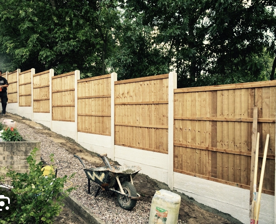

Concrete posts and gavel boards with quality wooden fence will last decades, nothing wrong with a weathered look, or with stepping if done in groups of four or so panels. Different sized gavel boards may help with the height difference.
That looks good?

It only really works with open timber fencing or brickwalls
Your only two options are
1) step the panels
2) close boarded timber fence and cut featheredge boards to follow slope
Personally I prefer the natural look of weathered timber, an oak close boarded fence looks lovely weathered grey
