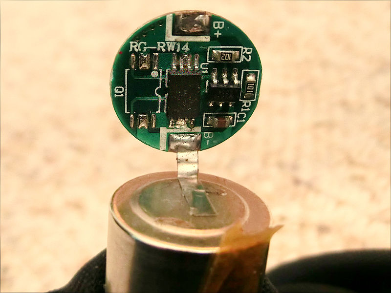

As we went to NiMh the ΔV did not work as well as with the old NiCad and today we have so many types, Li-Ion often had electronics built in upload_2022-1-11_0-59-37.png image from Wikipedia, and today it is near impossible to know how each type should be charged other than follow manufacturers instructions.
