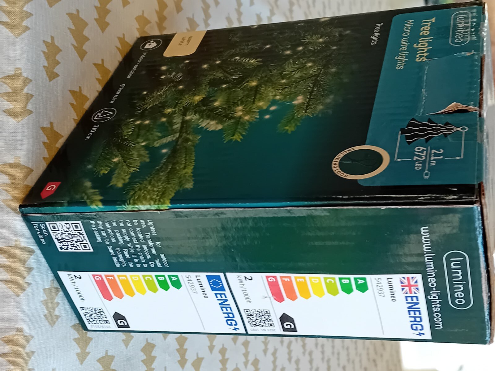

Can anyone explain why my 2 watt christmas tree lights only have a G rating?
I think they are rolling out these changes to all electrical appliances.
I think it makes sense for larger more complex appliances (white goods+TVs etc), maybe not so much for a string of christmas lights... But then common sense should apply and and you should not worry about it.
For more complex appliances, yeah I see how developments in technology will make old standards outdated and incentives companies to tweak a bit more to make things more efficient.
Because the ratio of electrical power in to visible light out falls into the range of values defined as band G.
Considering the way that some houses are adorned with thousands of these lights, sometimes for months, I think it's worthwhile to rate them.
"Why I light up my garden for more than half the year" : https://www.bbc.co.uk/news/articles/cdj8md80mkwo
"Man heats home with over 4000 Christmas lights" : https://www.bbc.co.uk/news/av/uk-25002201

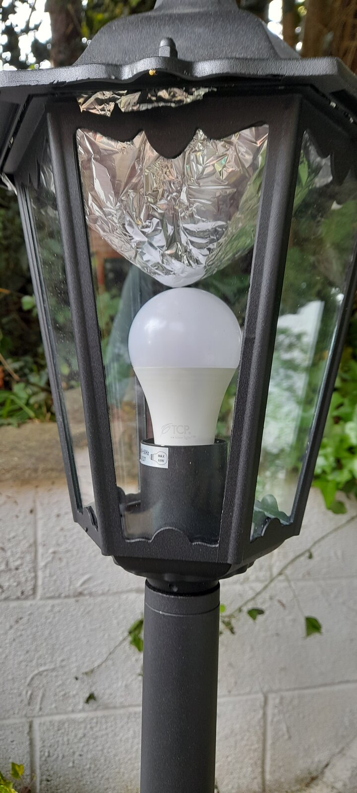

With LED lights, we also have a number of factors.
1) To stop lights remaining on dim, when switched off, due to capacitive or inductive linking either the lamps need to be DC or they need a bleed resistor.
2) To convert from voltage to current dependent, we can either use an electronic driver, or a simple resistor, the latter uses ¼ of the energy supplied, so that will reduce efficacy a lot.
3) In the main, we want to start at 12 volts, again it is how we get the 12 volt to start with.
Basically, the less power used, the larger percentage of the power is waisted.
But this does not include getting the light to the correct area, here 20230518_174342.jpg I was trying to reflect the light down onto the drive with silver foil, I could use the same foil inverted, or use a filament bulb, or use the old folded fluorescent tube, or a integral lamp with all the LED's in the top, so light starts out being directed down. I want the floor illuminated, not the trees, and I only need enough to see my way down the drive.
So yet another option is loads of little lights, following the wall up to the road, the latter in spite of being very inefficient light output wise, they are super efficient watts used to see the way to the front door.
But if the same lights are used to just decorate, then 100% loss, so how can anyone say how efficient. All the manufacturer can say is lumen per watt, rest is down to how used.
