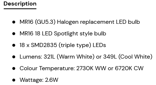

Both at 12 to 24 volt DC, and both have a lumen output over 100 times the watts used, they will work 10 to 30 volts smooth DC and odd neither show the energy rating. They are designed for caravans and boats, where it is important not to use too much battery.

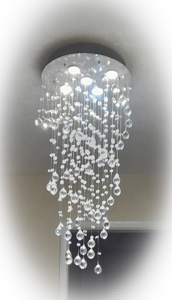

However the main problem with MR16 format (not really MR16 as no reflector) is often the light was directed to a dark surface, but in a chandelier the light is directed to a white ceiling, Lindas Light.jpg which spreads and reflects the light far better than when aimed at a darker floor. Illuminated area matters, so a 9 inch down light works better to a 2 inch down light, of the same lumen output. But it is swings and roundabouts, many of the larger units are integral, so when they fail you have to change the lot.

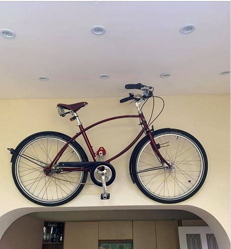

Same here Kitchen bike.jpg original was one 22 watt LED tube in a fluorescent fitting, the down lights look better, but more like 50 watt to do the same thing, not sure the bike is really good decoration, but does show how high the ceiling is, so the spread of light is better with high ceiling.

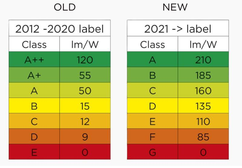

Not sure I’m any closer to understanding this, in layman speak. If according to the last answer (table), it’s that lumen output per watt is expected to be higher now under the new rules rather than the old period?
Exactly that. Since the original system, lamps efficiency just got better by such a large factor that the old system of displaying it couldn't easily be adapted.
