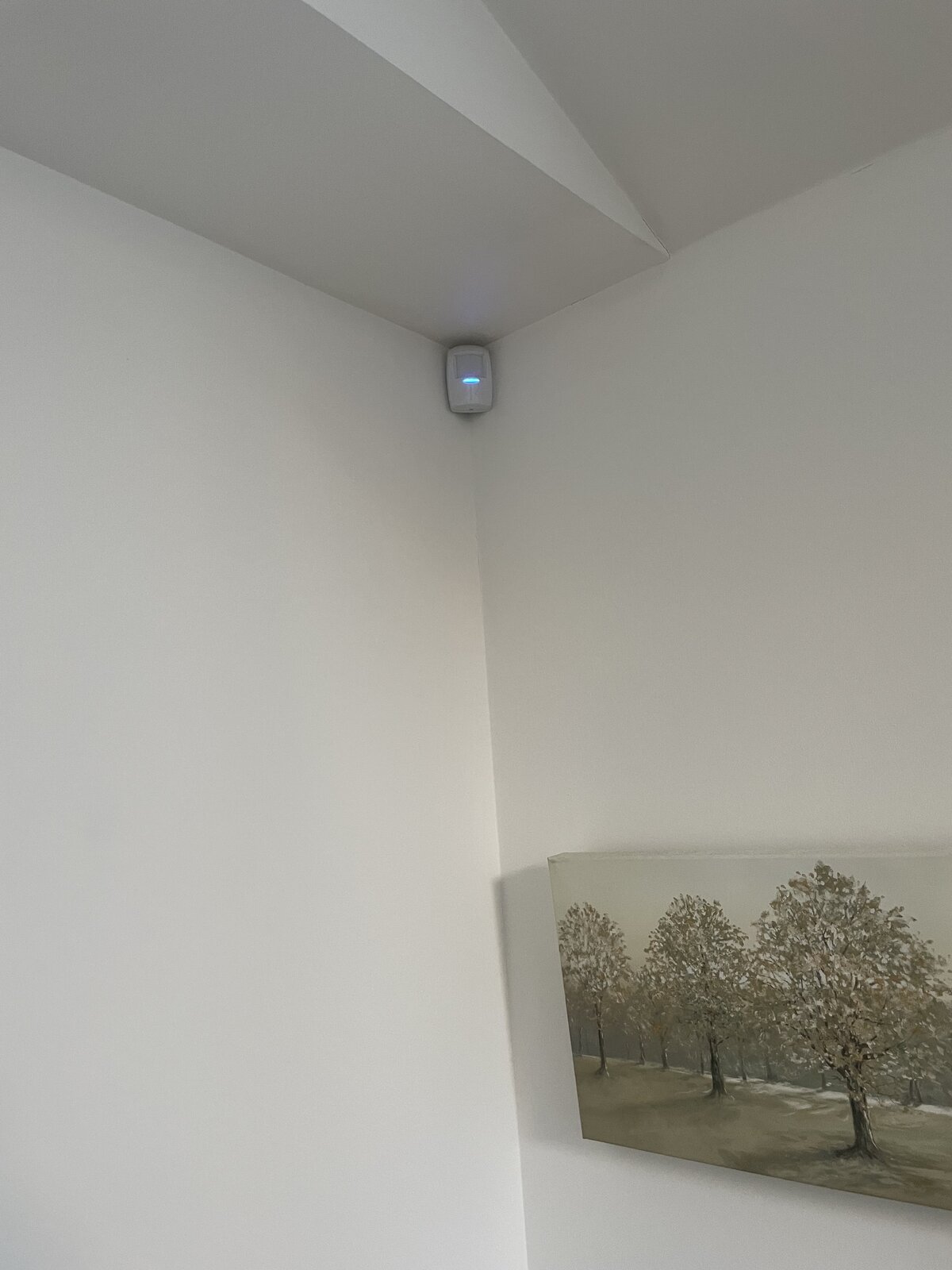

I have a Pyronix Euro 46 V10 alarm system which was installed in my new build 5 years ago. It was maintained by Chubb for the first year but I did not renew the maintenance contract. It has not been set for the 4 years since we stopped the maintenance contract.
All has been well until this morning at 3am when the alarm bell suddenly came on. There was no intrusion to the property.
I keyed in the "4 digit code" which was followed by the fault description "Garden Room Tamper on Input". I then pressed the "No" button twice.
The alarm sound went off but the yellow light on the left hand side of the unit continues to flash and won't go off.
I would be grateful for any advice for dealing with this.

Tamper fault on Garden Room sensor.
Post photo of device in that room.
Are devices all hardwired or do you have any wireless sensors ?
It was a new build house 5 years ago. I'm not very techy but think it is hard wired.

Take cover off sensor, adjust spring by pulling spring gently to adjust. Put cover back on a d reset alarm with code.

Garden room sensor tamper would suggest that the fault is on the movement sensor. I attach a post of the the spring to show you what you need to adjust.

The thing with the blue light in the garden room is the movement sensor. I would reccomend that you contact a local friendly alarm company to check your system over as tamper faults very rarely go away on their own.
