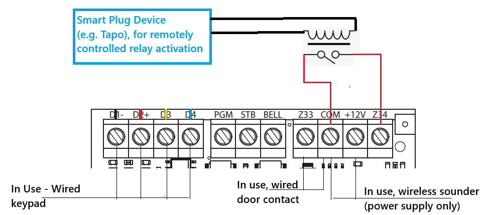

Edit2: Looks like my only option might be to use some of that spare wire to my external sounder, to hook up a 12v feed directly to the piezo, and just control it via a remote smart plug. Just not sure I trust the smart plugs enough... imagine it went on without my explicit say so. No auto-off. No notification. No timeouts.... Just lots of annoyed neighbours. That sounds like a bad plan, so would have to build some redudancy into it somehow with a timed burst or something, which means its all getting more complicated. Probably easier at this point, to just hook the smart plug up to a light, TV, music system etc... and make the house noisy that way (home alone style).
It will work on V11 enforcer …..you will need a small relay and have a spare input on the 2 zone input card inside the enforcer ….
Ah, I see what you mean. I think.
There are 2 inputs on my enforcer (Z33/Z34) and one of them is available.
I'm only using a Wired Keybad Input (D1-4), a 12v/Com out to the wireless sounder, and a single wired input for my front-door contact.
All the other PIR and detectors in use are wireless.

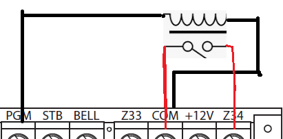

I *think* you are suggesting something like the following:
And of course, it would mean configuring Z34 as a panic type input which immediately sounds the alarm.
Of course, this wont get it inside the HomeControl+ app, but then I'm not sure that is possible.
However, it does mean that it benefits from all the other 'controls' around an alarm sound, such as maximum time, notifications, allowing someone to disarm it etc.
That makes sense to me, but obviously means using some outside tech.
Still, if I am understanding your suggestion correctly, I think its entirely doable. I'll just need to buy a 240v relay and wire in as above to a nearby socket.
Can you confirm this is what you mean?
Initially, I had been trying to solve it by seeing the alarm as a potential 'manual output' - which is doable with the key-fob, but I can't see any way to do it remotely via the HomeControl App, unlesss I create a new input trigger (with some other type of smart device).
Please confirm I'm not misunderstanding, and if not, I'll solve it this way. Thanks.

OK, I'm with you. PGM supplies a voltage, so it would be PGM & 0v to relay, and then I'm good on the other side of the relay (as per my drawing).

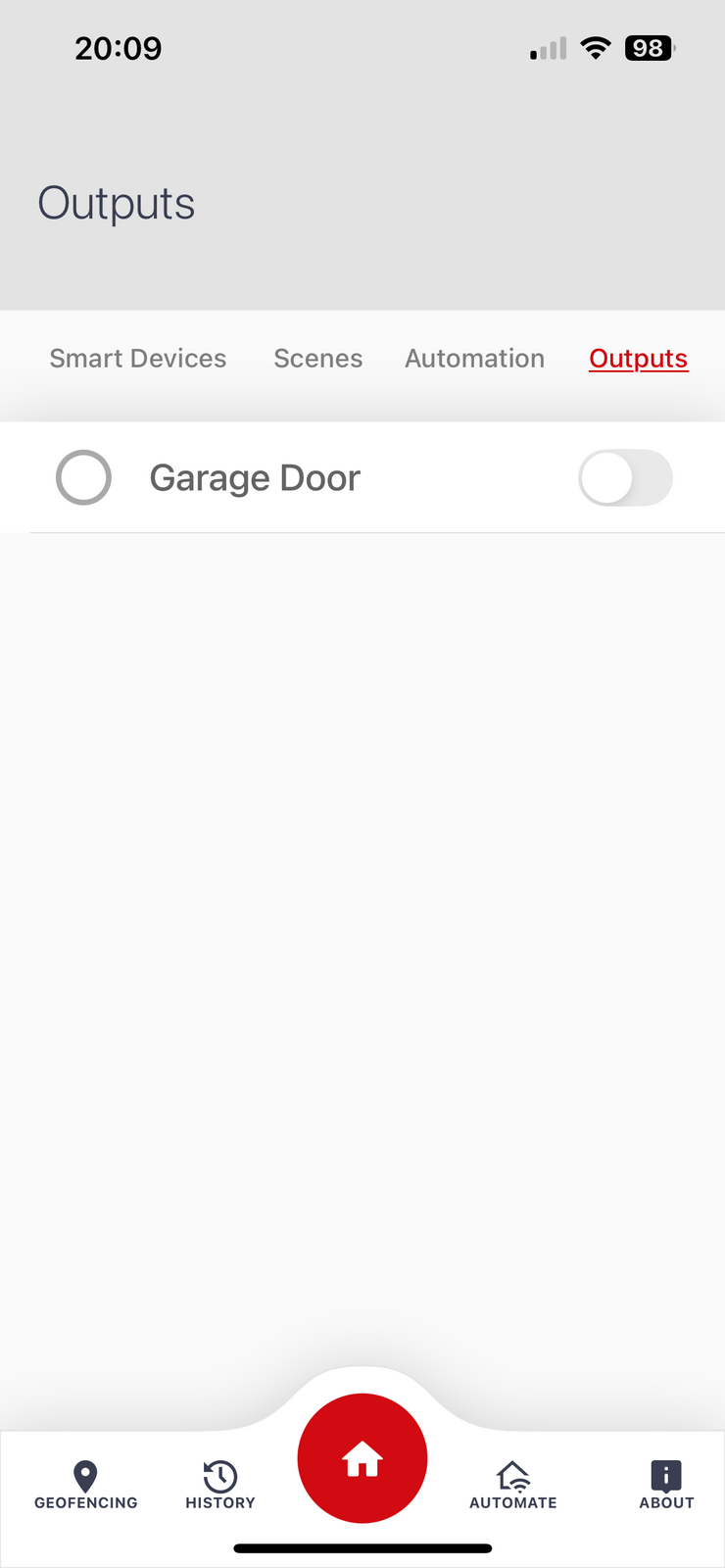

Go to output ..endstation ouput …PGM op set this to 170 user defined 1….then go to user output 01 ..output type 1 for timed….user output time …set at 02 ….name it panic ….put relay on ( PGM 0v ) 12v + ….in app in automate you should now have slider….as per picture

Holy mackrel... It worked.
Somhow, changing the output type from 'Latched' to 'Timed', pushed everything through. I now see it in the App, and can work on hooking up a relay once I order one. :) With any luck, I can find a micro one that fits neatly inside the enforcer case.
I'm not sure *why* that part made the difference. I had already set PGM to 170 already, and had a user output called 'test' setup on 01. I just had it set to 'Latched' and it didn't seem to come through.
I have since set it back to 'Latched', and it is now 'sticking'... so I'm unsure what happened there. Toggling it seemed to push it through to the app - unless it happened with some overnight sync and I just hadn't noticed.
Timed is obviously the more appropriate operation anyway for a relay based alarm signal, so, I'll leave it as timed.

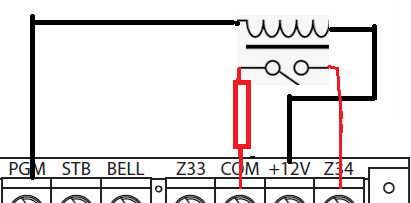

Oh - this is my updated drawing then based on your earlier reply:
I'm showing +12V to relay (and then back to PGM)... I hope that is right, but can test it now fairly easily.
I also figured that the Z34 input, via the relay, might also need a resistor on it?
It doesn't need tamper protection, obviously... so maybe not - but thought I'd check if you had a view. I'm not sure you can configure it per input, and I know my Z33 door contact, is set up with an eol resistor as part of the contact.
Either way, I'll figure out the rest now I'm sure. Tyvm.
4.7k across the closed relay and 2.2k from one side of the relay to a wire back to the common and one wire from the other side of the relay to zone 34
