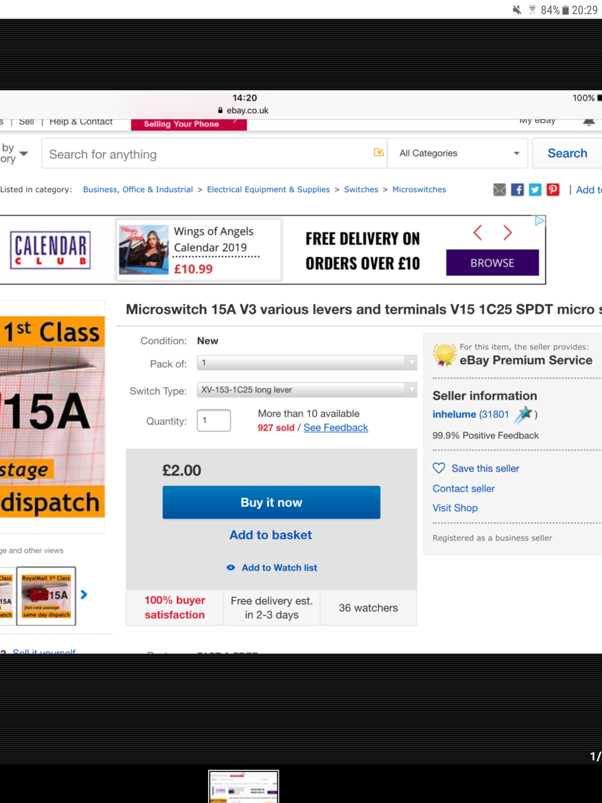

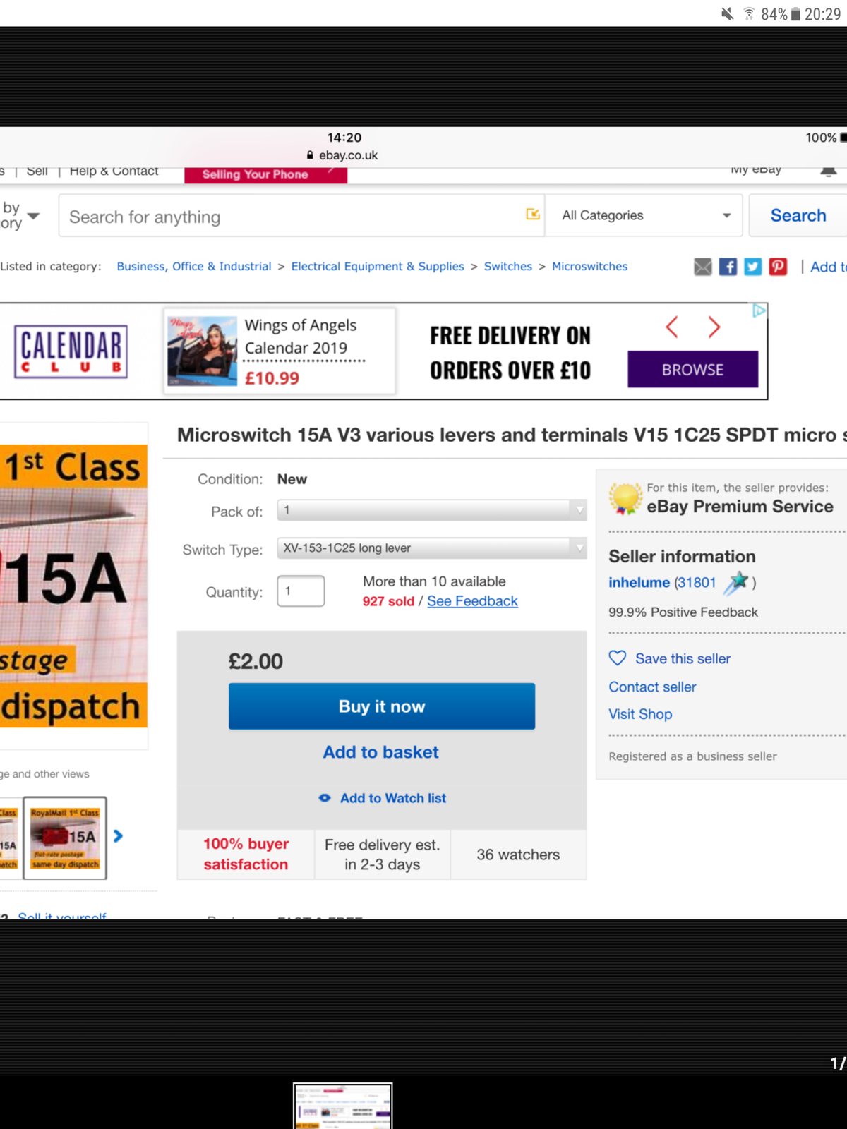

Simple to change just take spare connectors of old micro switch and fit on new one and adjust lever
Open bell box lid
Take faulty micro switch out
Disconnect spade connects on old switch
Put spade connects on new switch
Fit microswitch back
Adjust lever
Close lid
Test bell box.
