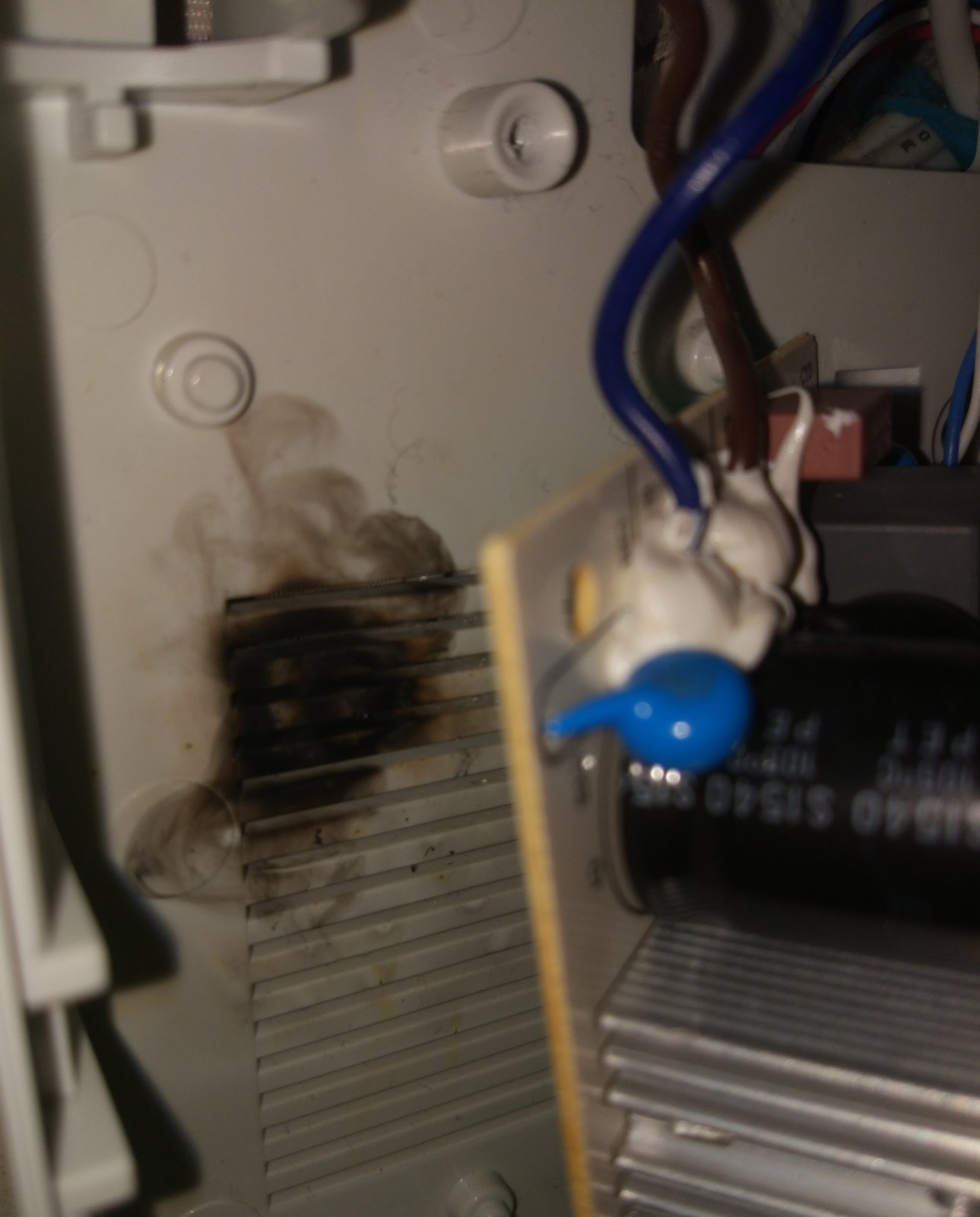

Hi everyone.
The alarm has stopped working. It came up with an alert saying there is a mains fault then about 12 hours later a low voltage alert came up now it is off. Nothing on the screen, have tried switching off at the mains leaving it for a while and powering back up but nothing.
Can someone please help?

Just check that the switch mode psu inside the panel hasn't melted does it feel hot at the top left corner of the panel ?

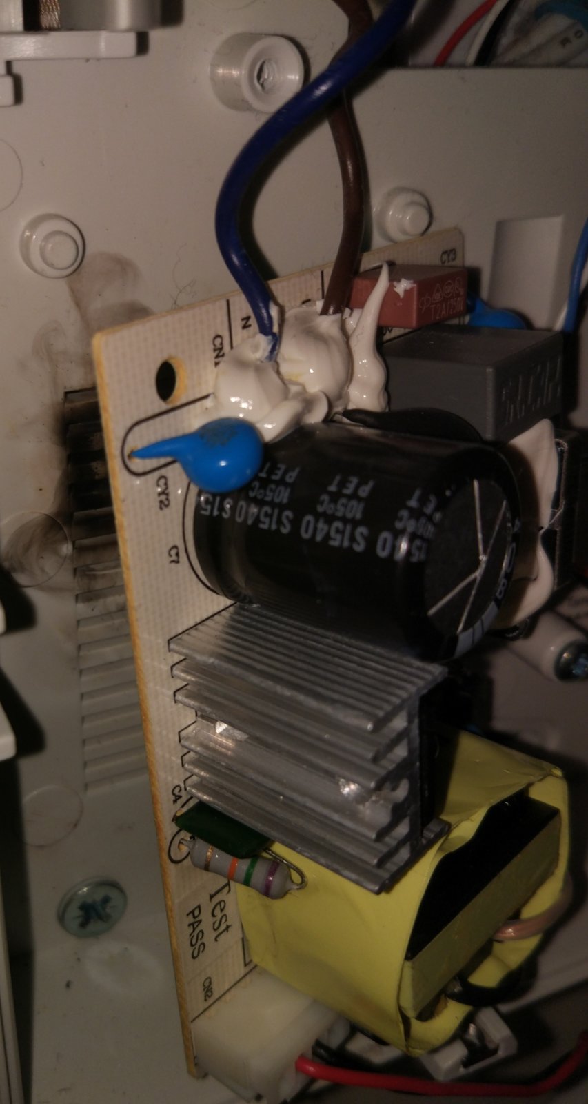

So I took a look and that panel is cool. Fuses looked okay too. It looks like the psu is fried?
Any thoughts and ideas how to fix this? I've seen a psu online https://www.cts-direct.net/pyronix-...spjju2OJG9jyf83KV2knG7qn7mj6uDCIaAuyVEALw_wcB
Please let me know your thoughts. Thank you!

That's not looking good ! I would put the psu cover on and check with a multimeter input ( 240 v AC ) input and 12v DC output
Thanks for the reply. Where should I connect the ends of the multimeter to?
I'm not trying to be rude, but, if you have to ask that question, you need to get someone in.
As a precaution, you don't want to hurt yourself, or the panel.
