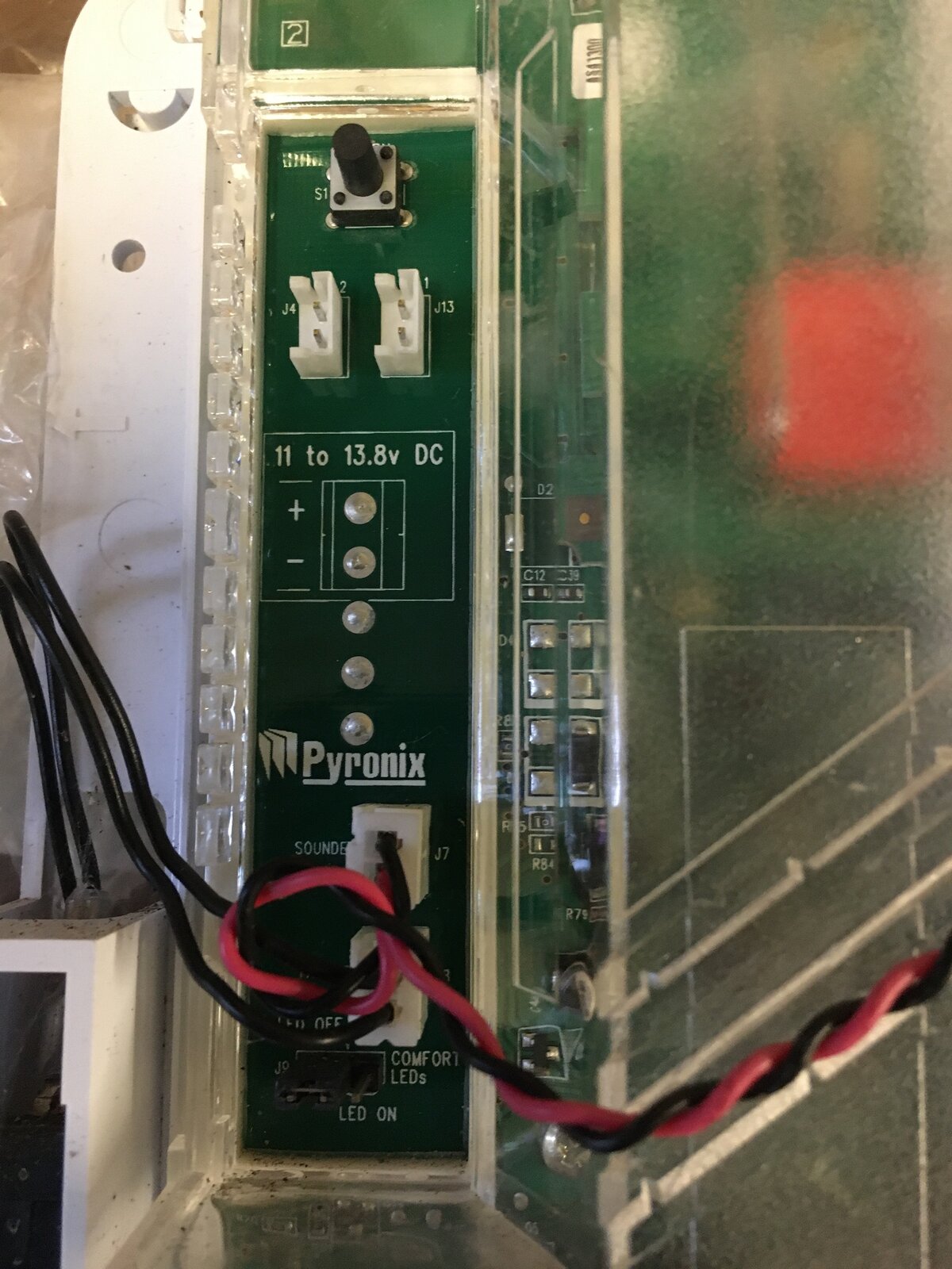

Is it a MK 2 Unit ? Two flat batteries and NO ....input for power supply ? Would need picture of bellbox pcb with the internal cover open ....if so you need to replace it ...

I do ! So in layman’s terms .....since you have replaced the bellbox batteries....the siren doesn’t ring when you activate the alarm , the strobe works and the leds but no siren ....

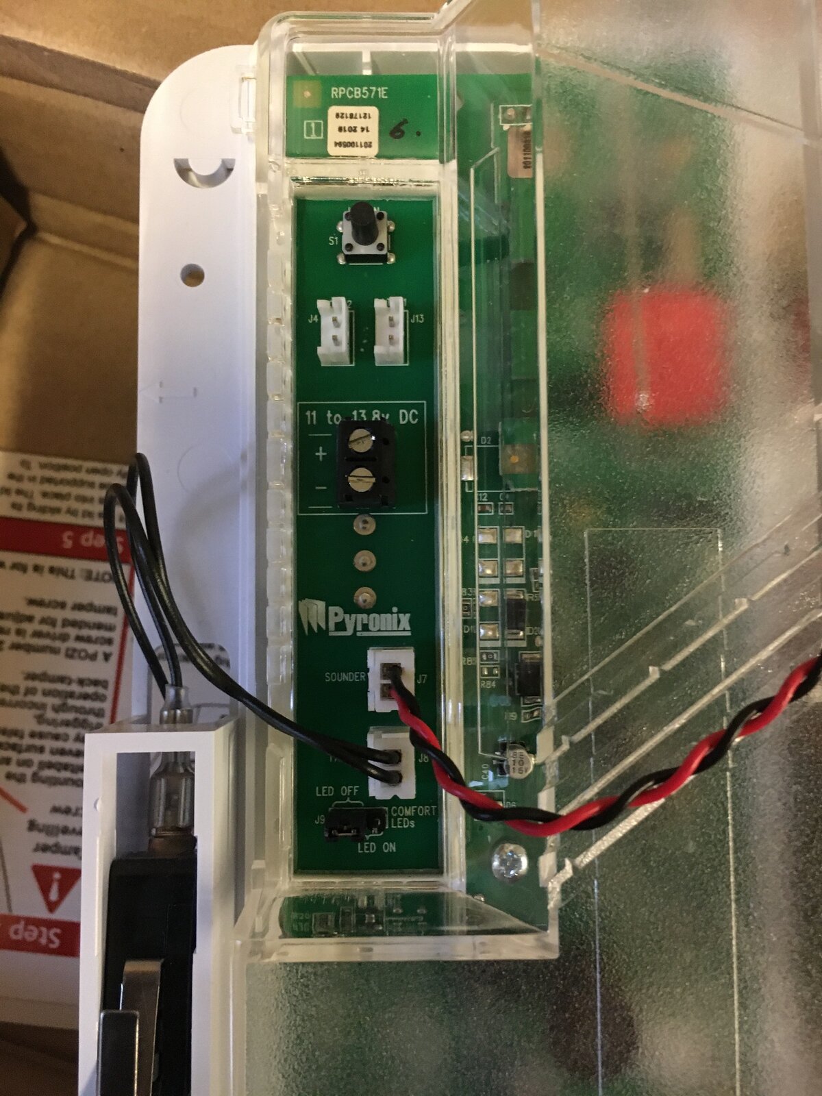

DB0AA831-7A26-42CF-8142-0D90AC6255B1.jpeg Mk3 with power input terminals
Thanks for the pics, when you say with and without power input terminals does that mean one is wired up the mains? The one I have is not
apologies if that isn’t what it means
Where is the connector for actual siren in the casing?
