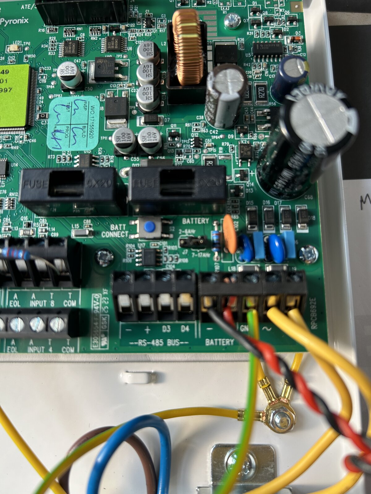

also i noticed when changing the battery there was a glass type fuse lying in inside the panel lid, so this must have fell out from somewhere
also just wondering the battery that was ordinally in the panel is quite small and slim i remember looking at my parents a few years ago and it was alot bigger
im just thinking maybe i need a bigger battery as i have two live bell boxes etc
I've ordered a replacement fuse but does anyone know where in the panel this has to go?

i didnt check the battery fuse im sure i could get a multimeter
i did notice a glass fuse lying inside the panel it must have come out from somewhere would that be causing the issue ?

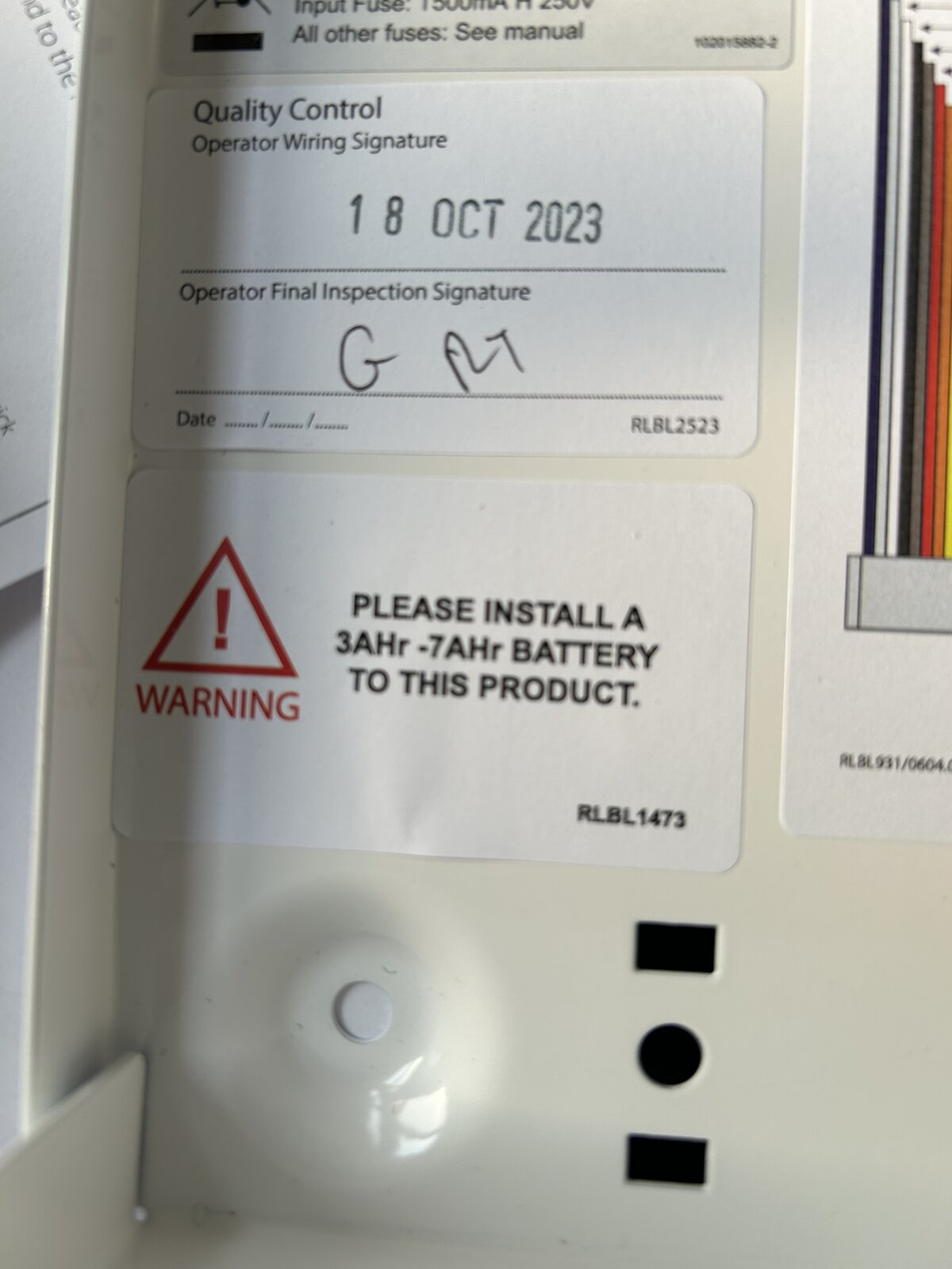

its a slim type battery i thought it looked quite smaller considering my parents system scantronic 9752 i think is much bigger
wondering if i need a bigger one saying that my panel looks smaller so unsure bigger one would fit in it, i have two live bells one front and one back maybe i need more back up power ?
7.0 is the largest in a small case version
Below location of battery fuse
the battery i have is 12v.21ah maybe this is the problem then? i just typed in pyronix alarm battery and the one i have was suggested
ive found
Yucel 12v 7.0Ah Sealed Lead Acid Battery would this do ?​
