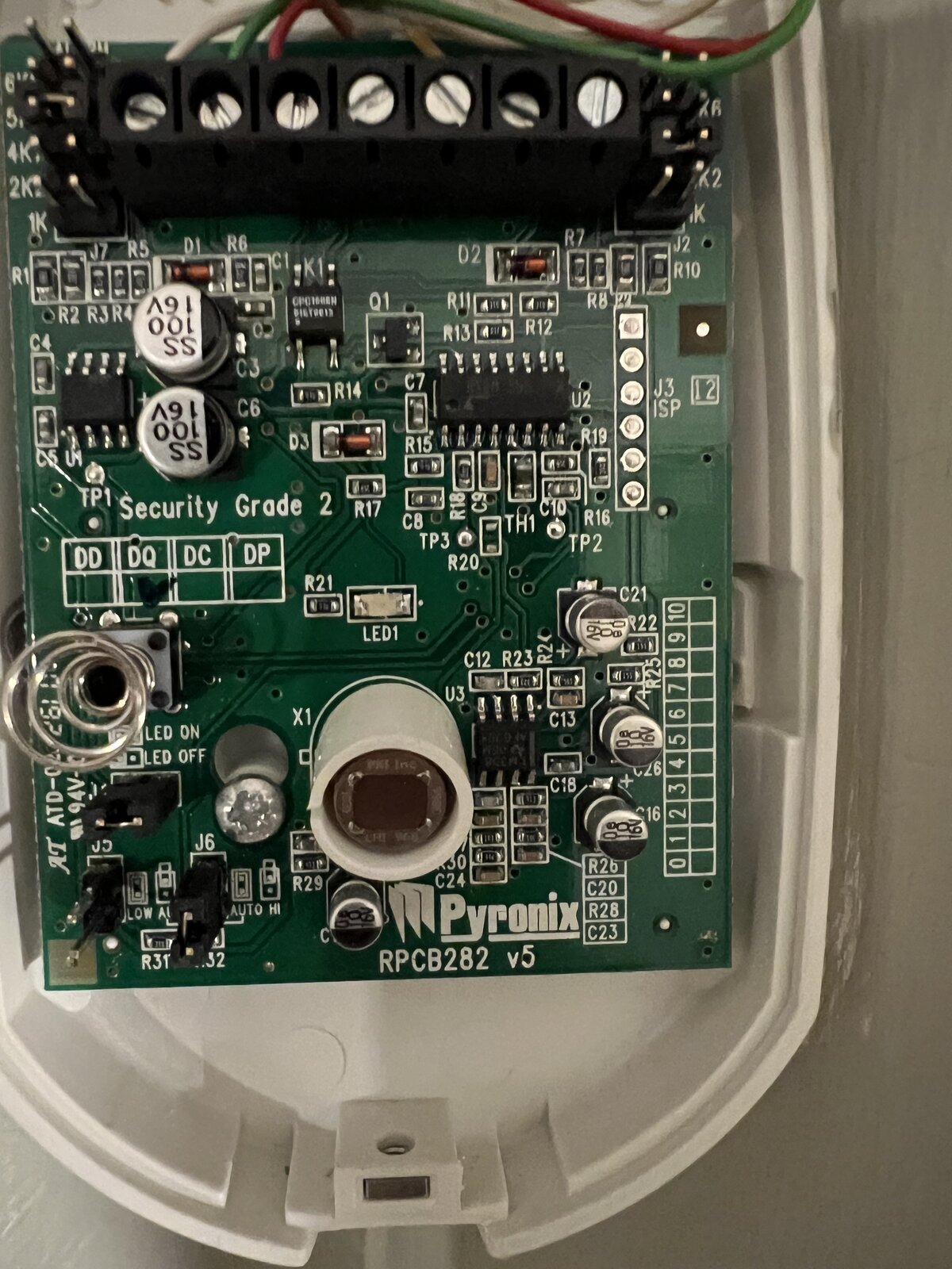

Hi, trying to identify what pyronix PIRs I have to check if they are pet friendly. Opened one up and only code I could see inside was RPCB282. Anyone know what PIR model this could be?

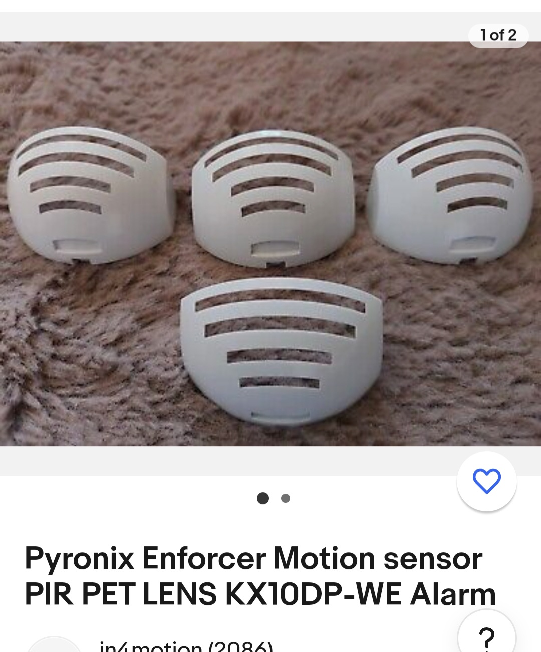

The only difference with the pet one is the lense filter. If u got cats then wouldnt bother

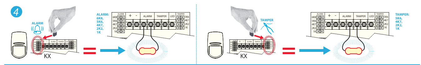

I got the Bosch PIRs as recommended by @sparkymarka. Trying to work out how to replace the KX15DQ which has jumpers to set resistance whereas on the Bosch I think I need to use inline resistors.

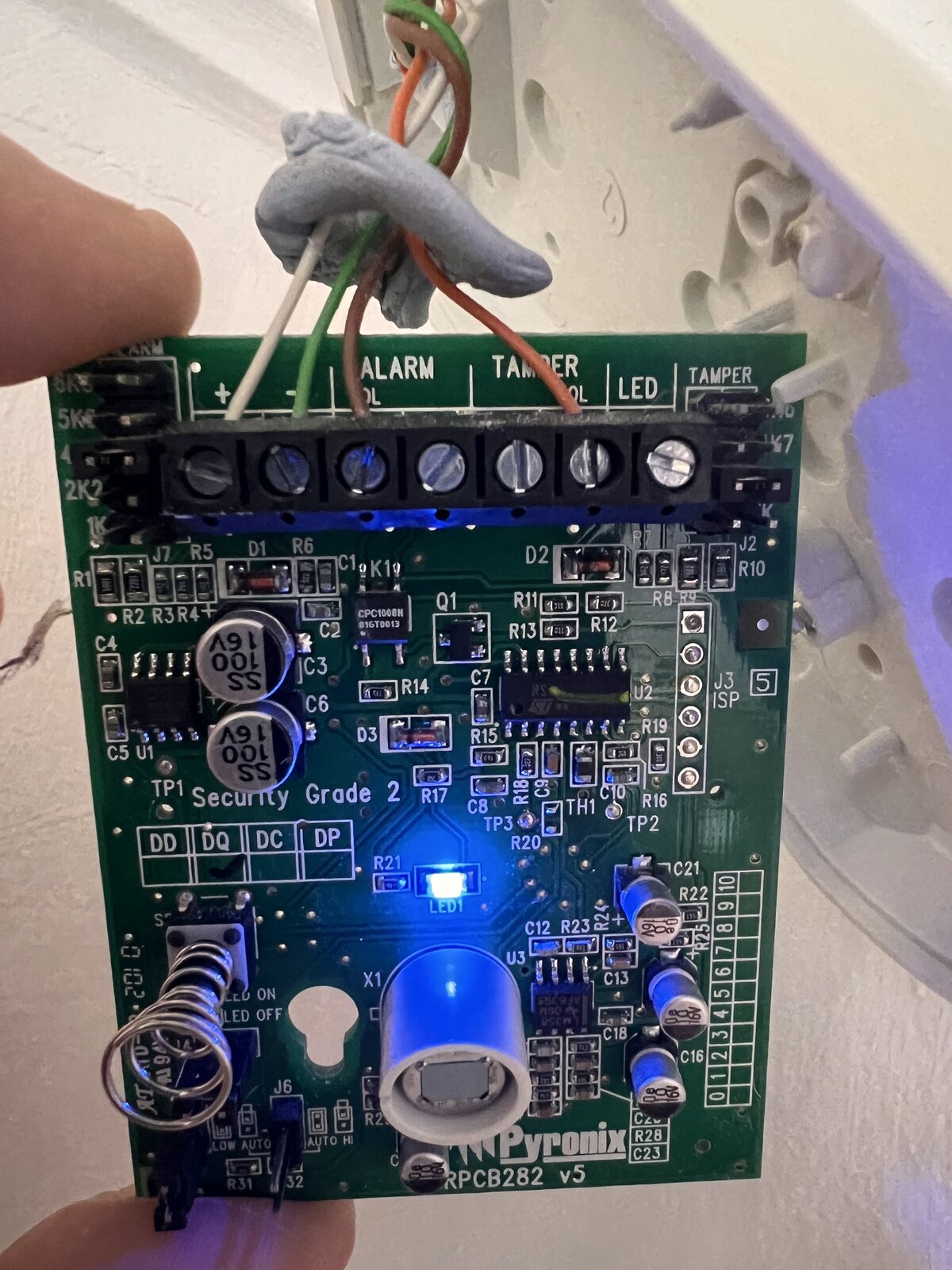

Here is a photo of the KX15DQ. Resistance jumpers are set as 4K7 on Alarm and 2K2 on Tamper

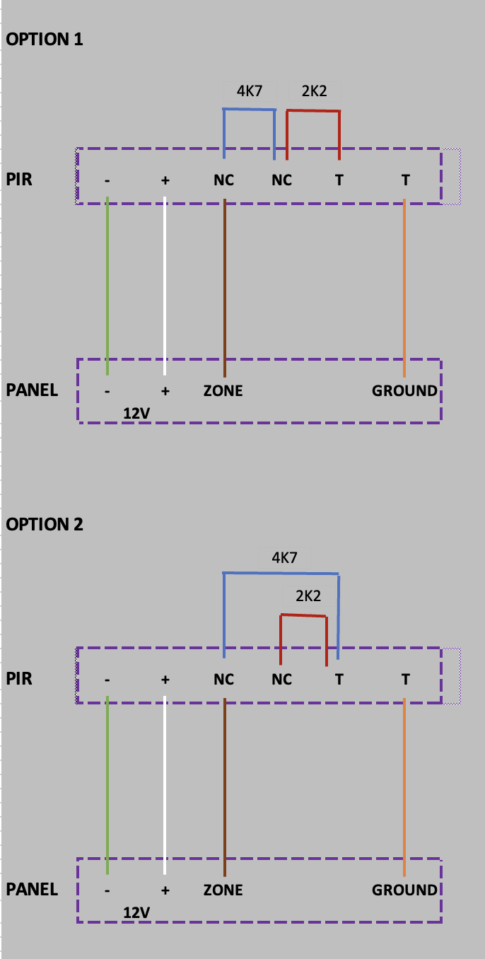

Do either of these wiring options make sense for the Bosch PIR? If neither, would appreciate any pointers.
Just to close the loop, new PIRs installed and working. Definitely a fair bit less sensitive of humans than the previous non-pet-friendly ones. Hopefully will be ok with the cat. Thanks all for the input
