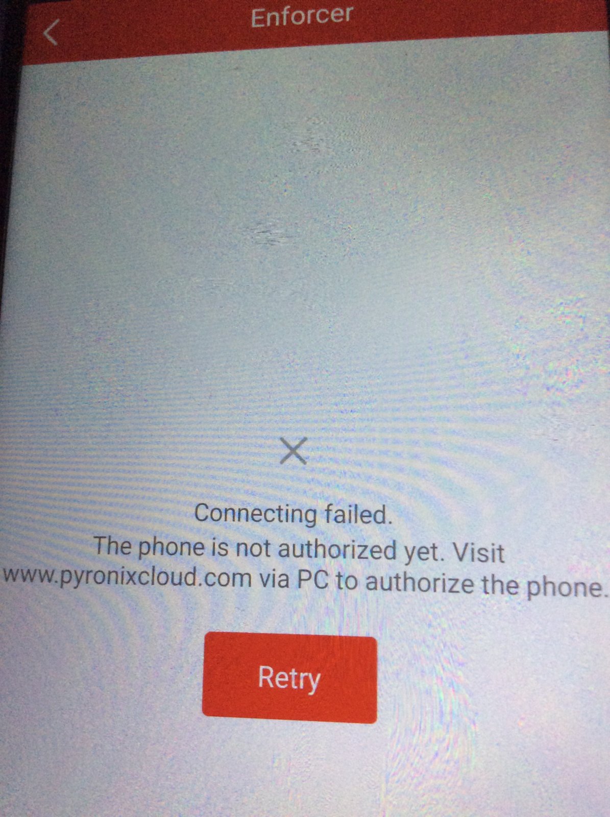

Hi Guys
Can anyone please help? This alarm is driving me nuts!
How do I find/ create the user code for the Pro Control App on the enforcer panel?
I’m entering my user code, and the password I entered at the panel for the app but I keep getting “connecting failed. The phone is not authorised yet. Please visit Pyronixcloud.com via PC to authorise the Phone” but when I go to the cloud it doesn’t tell you how to do this. Do you have any idea?

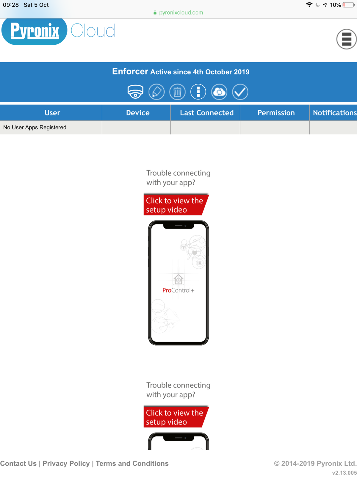

Have you created a pyronix cloud account to register the system
Then set up by entering unique app I'D
You tube shows you how to do this .

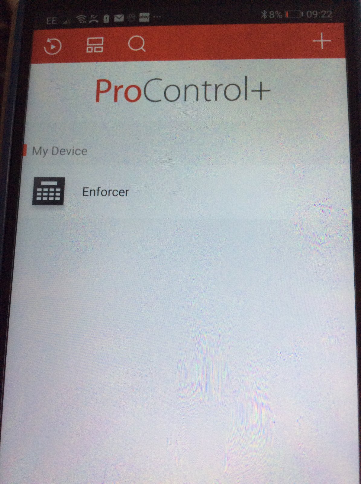

Thx for reply’s guys. I’ve created cloud account and enforcer is on there from 4/10/19 (see pic) but under User shows no user app registered. Enforcer shows on app but when I double click it I get the error message about phone not registered..... can’t see a way to register phone on the cloud site. During setup I entered codes sent to my phone by pyronix so it should be registered. Is there anything else that could be set wrong?
Log out of the cloud account and then log back in ....now see if your phone is there , if so slide the permission bar ...
