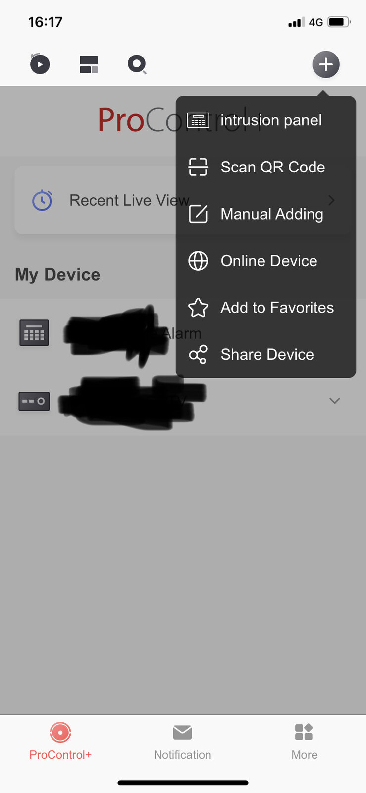

Your not getting this option when you tap the + symbol?

yes, I get the pull down menu but when I select top option for intrusion panel , the next screen has 3 lines
line 1 Adding Type Pyronix (selectable)
line 2 Alias New device 1
line 3 serial number numerics or upper case letters
if you touch on the
Adding line it opens window with 2 options
1 Procontrol+domain
2 IP/Domain
the IP domain is certainly to add a camera to the app as I did connect mine to it, the second option option just prompts you for a serial number.
I gather the first option should be similar the home control app where it asks you for the System ID and app password to connect to the panel

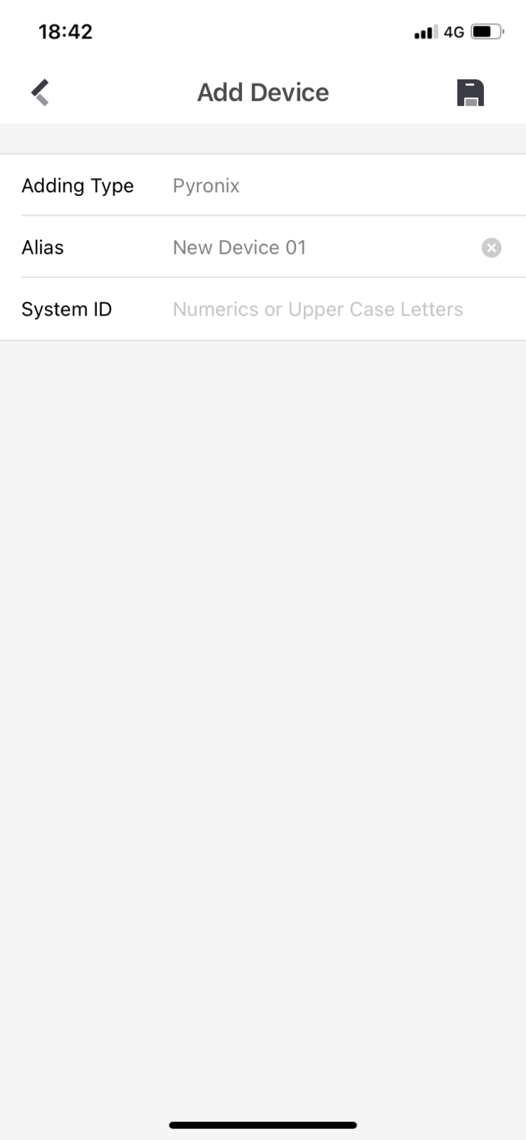

You only need to enter the system ID. Simple as.

Put system id where it says serial number. for some reason it comes up as serial no on android devices and system id on apple
Thanks Gibbies, works fine now:D:D:D, youre a star!. must admit I hadnt used any lateral thinking to put in a system ID when it was asking for a password although given the gaps in some of the Pyronics documentation I shouldnt be too surprised.
