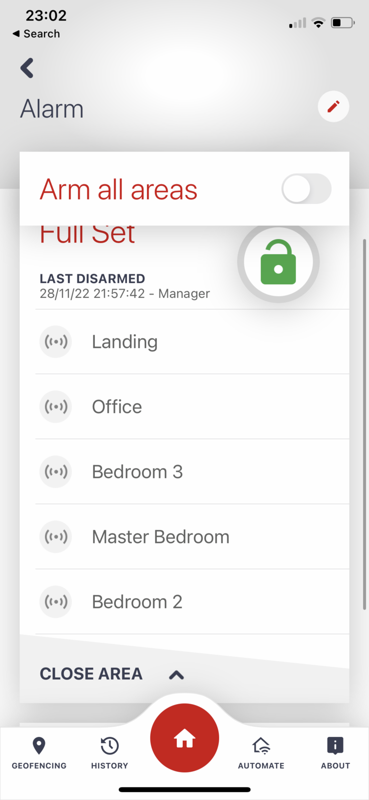

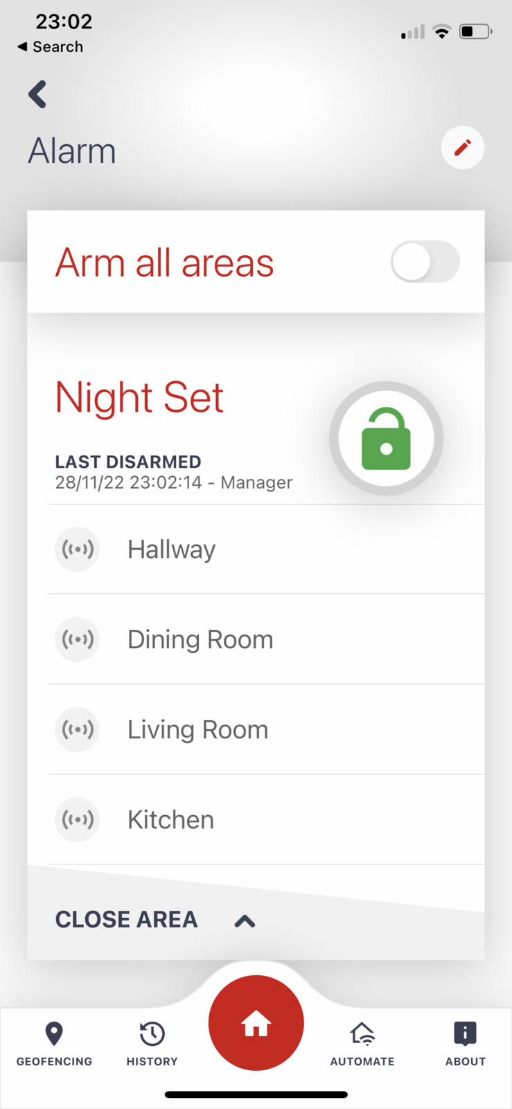

Hi All,
During the weekend I installed and programmed my pyronix as follows but It doesn’t want to set when arming the whole house (AB) it just says exit via hallway ( which I had set to entry, exit and then tried
FX(Area ER)
At this point im just not sure what the hallway which is my exit and entry point should be, it sets fine in the app when I press arm all areas ( the hallway starts a countdown from 30) but keypad it just says exit and keeps has a tone.
Input 1 - hallway B
Input 2 - dining room B
Input 3 living room B
Input 4 - kitchen B
Input 5 - landing A
Input 6 - office A
Input 7 - bedroom 3 A
Input 8 - master bedroom A
Input Box 73 - bedroom 2 A
Thanks,

it’s a 46, does this look ok below? Would like the whole upstairs disarmed at night, input 1 hall is my entry/exit untill I add some door contacts.
Downstairs
Input 1 - hallway AB
Input 2 - dining room AB
Input 3 living room AB
Input 4 - kitchen AB
Upstairs
Input 5 - landing A
Input 6 - office A
