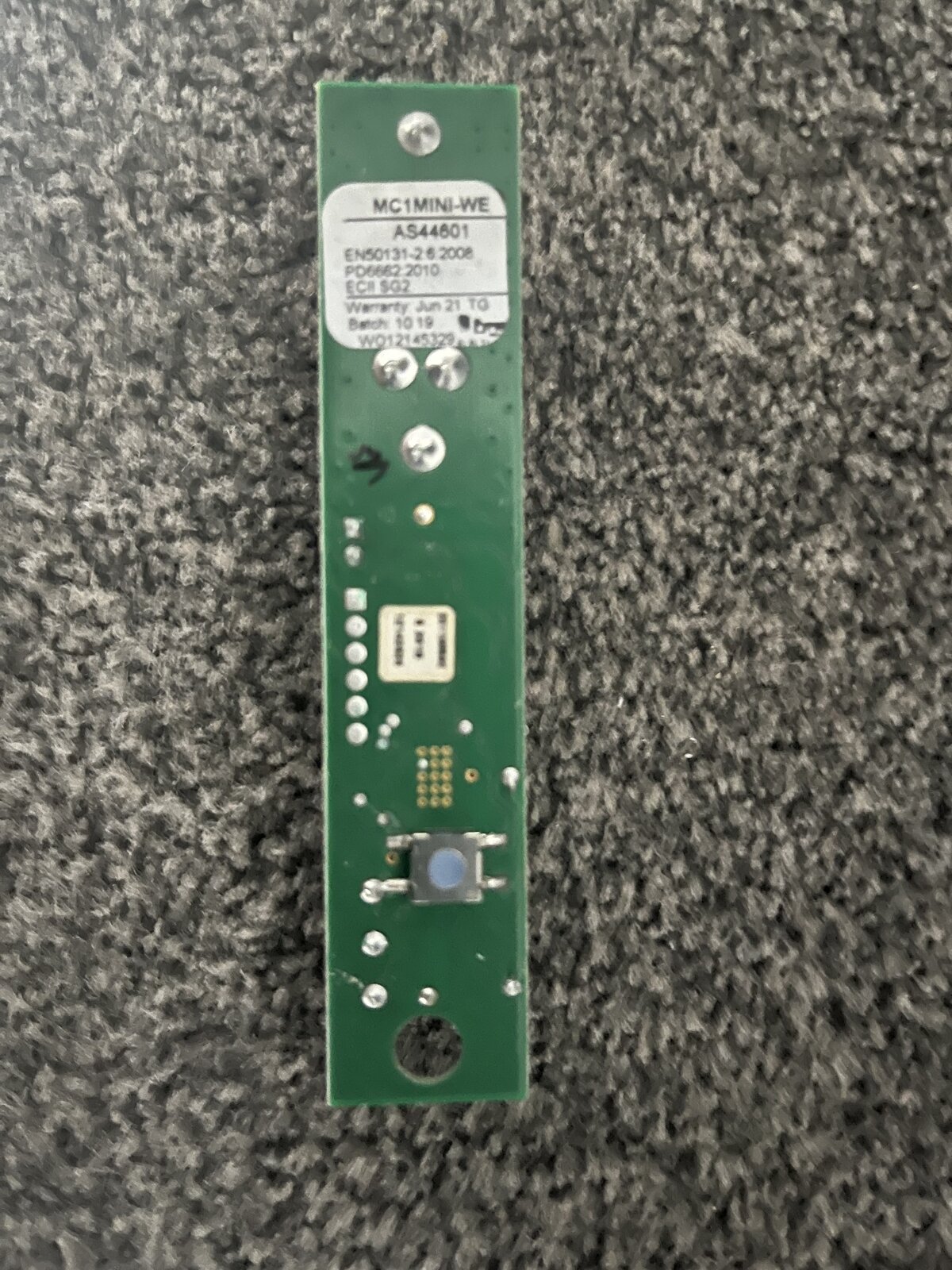

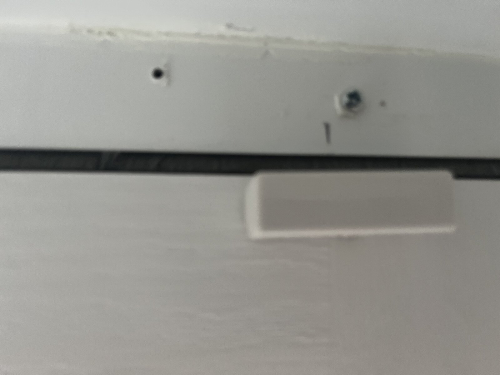

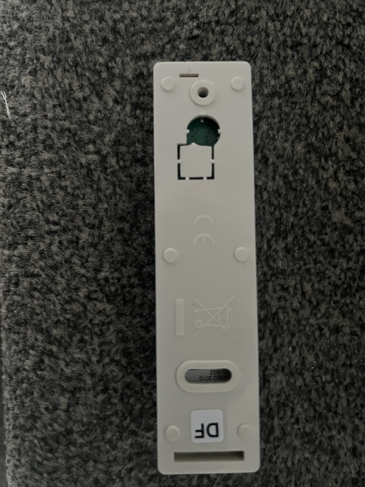

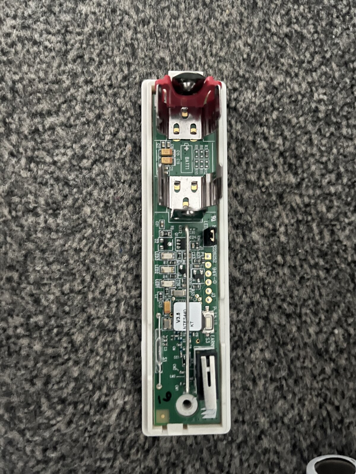

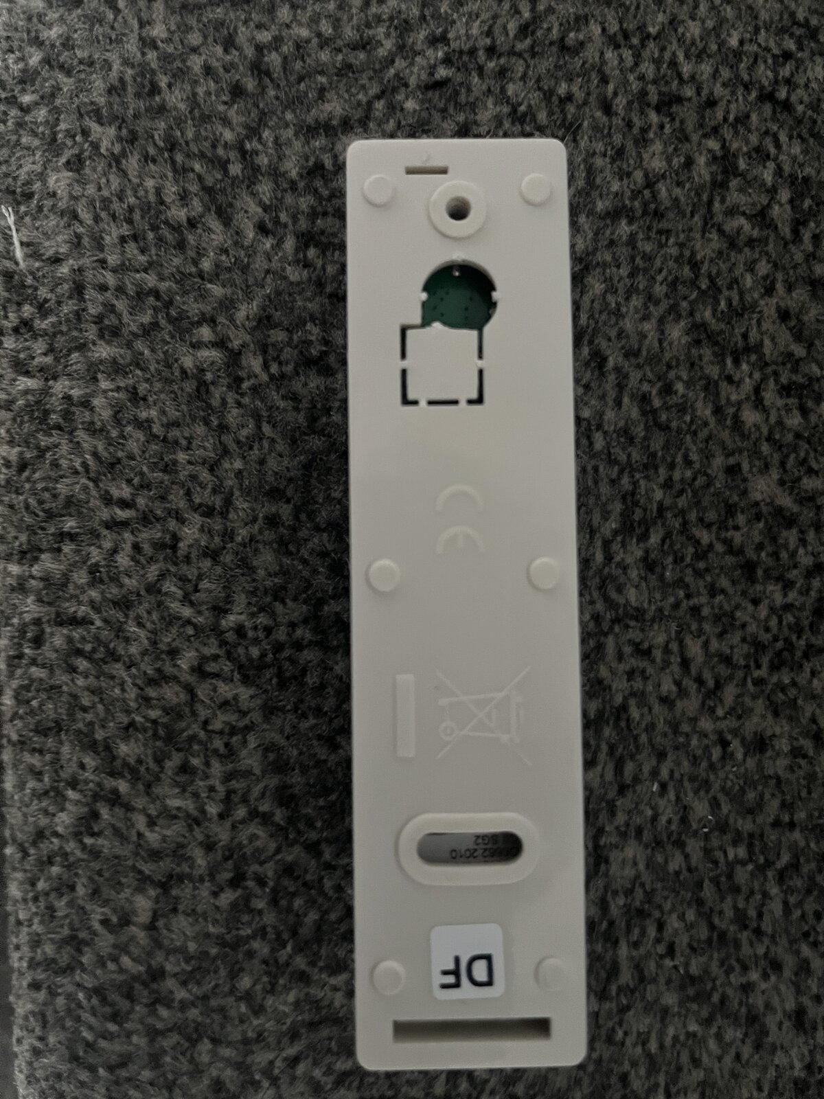

Pyronix door sensor. Exit, final exit timer and detection doesn't work. Tried relearning.
Take the cover off , take the pcb out , post picture of backplate on the door and the pcb , front and back
Attached I hope this helps.
The blue light does come on and off as I open and close door . But it's the setting when I configure as final exit / or 10 - zone er, I don't get the timed exit countdown and the alarm goes off, saying tamper on front door

Rear back tamper plate broken .
You need a new plastic case to solve your tamper fault.
You need to be very careful when fitting the screw as this has damaged the back plate.
Ah cos I had a new door fitted
It was moved. So it's the back plate completely which needs replacing ? That screws onto the wall.
You will probably need a complete new contact,as you may not be able to purchase a empty case.

Who took the sensor off ? this is why I asked for picture as I get this all the time with door fitters and it ends in a charge to the company fitting the door …
Door installer. Yeh it's too late now as I have t really had need to use the alarm as been working from home etc irs been over a year
