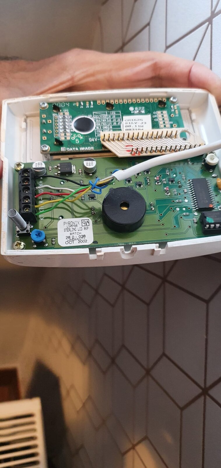

I have the same alarm and keypad, with the same issue. Some buttons don't register, I think the keypad needs to cleaned.
Apologies but I'm an amateur when it comes to DIY. Would anyone be kind enough to explain how to take off the front panel to be able to access the key pad to clean underneath? I've attached a picture.
Any help much appreciated.

I did undo the metal screws but I still couldn't separate from keypad.
Change code to number that works . If you damage/break keypad then you will need to replace the main panel and keypad as no spare parts are available for the sterling 10.

If you have a keypad problem with your Sterling 10,then you need to change the control panel and keypad.
The euromini was the replacement, but now obsolete due to covid component shortage.
Pyronix 46s is now the replacement.
