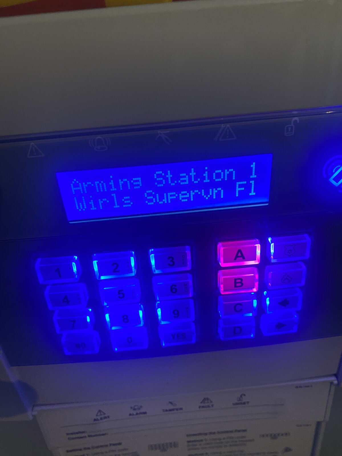

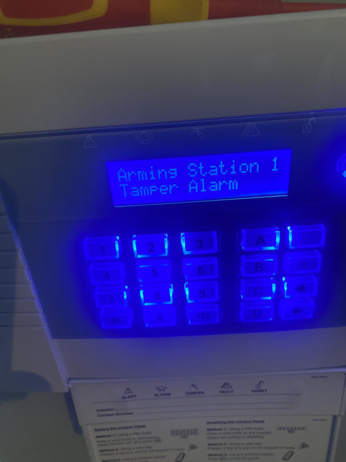

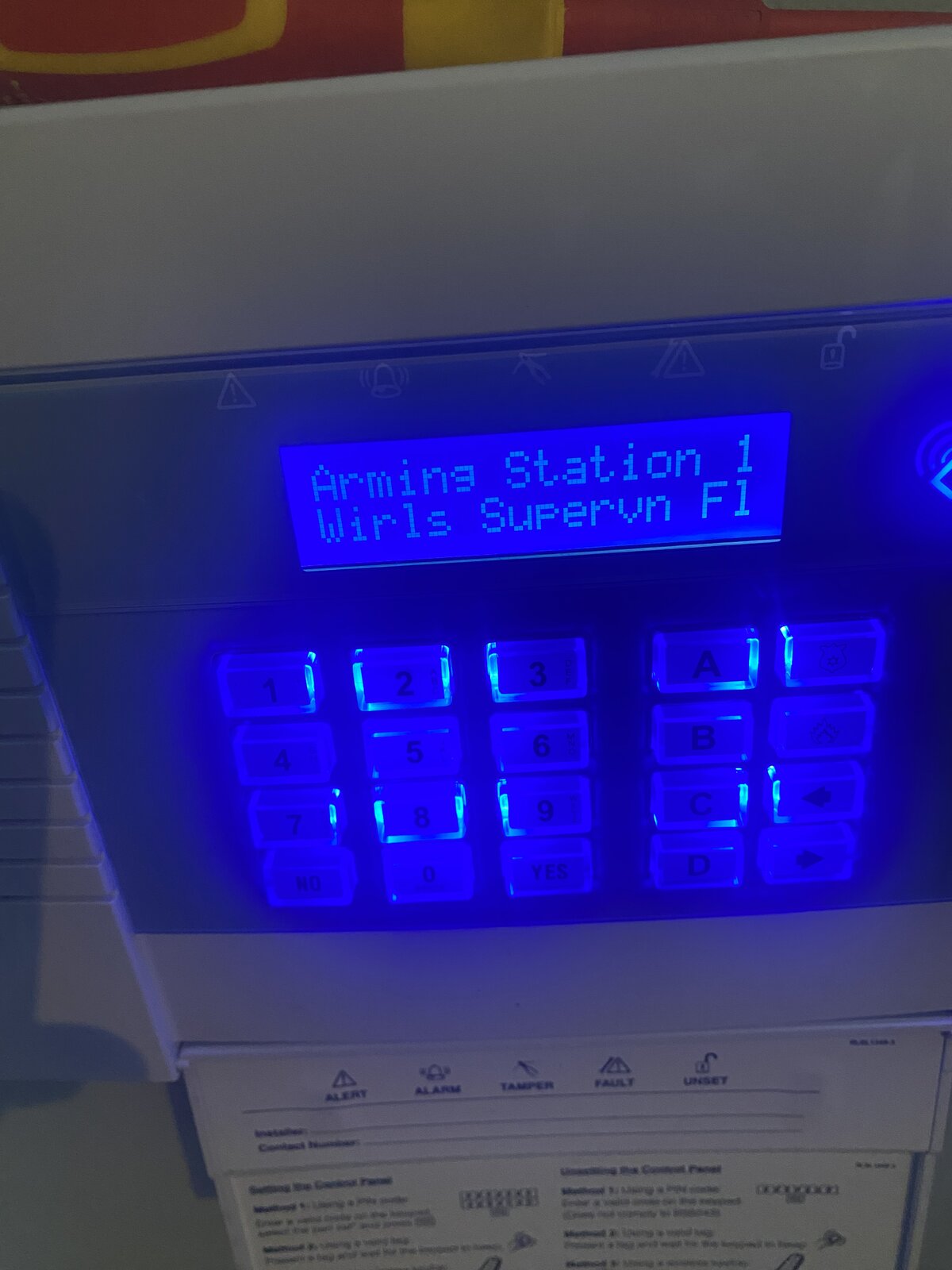

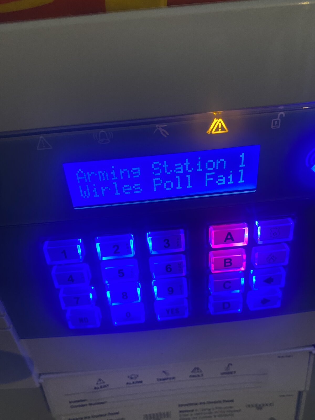

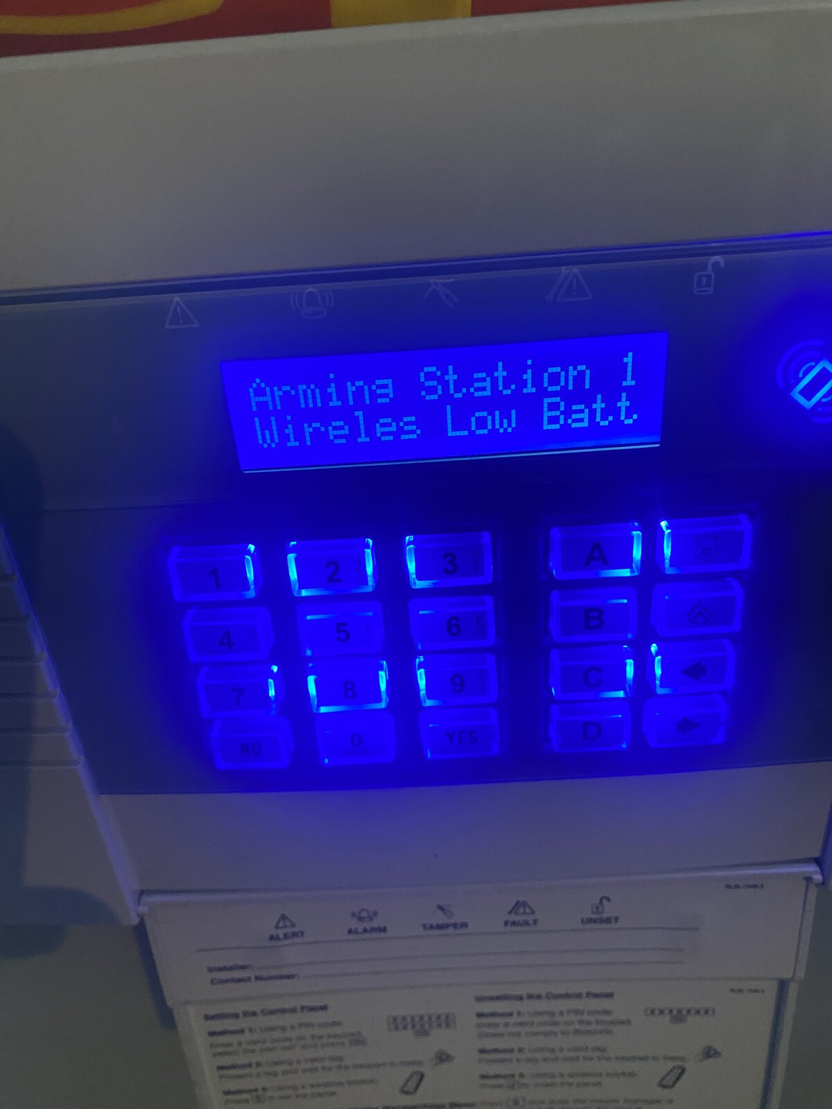

Hi,
My enforcer alarm has been done for almost three years. Recently the error message appear was that arming station 1 had a low battery. I swapped the battery in the keypad/ reader near the door then swapped the battery in the main alarm and now I cannot remove the following faults.
Works supervn f1
Wirles poll fail
Wireless low batt
Tamper alarm
It may be coincidence but one of the exit doors has also stopped bleeping
I have been through the engineers menu looking at the engineer reset options but I am drawing a blank.
Maybe the new battery is defective?
I may have not reset the tamper properly?
Can someone please advise.
Thanks very much.
Thanks for the response but the control panel doesn’t mention siren battery low.
Please see attached pics

Hi,
I have disconnected arming station 1 and the alarm is working again. I had changed the battery for a brand new one and checked the tamper and they seemed fine. The alarm seems to have disconnected from the home control app but I will try and resolve that separately. I am assuming that the arming station is knackered.
Thanks for your help
