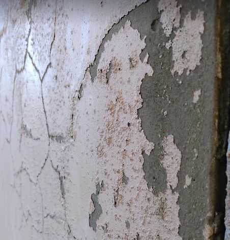

Our neighbours had PP and built an extension, the external side wall was mostly existing and was extended and guttering installed. This is in keeping with previous works before we moved in, no issue.

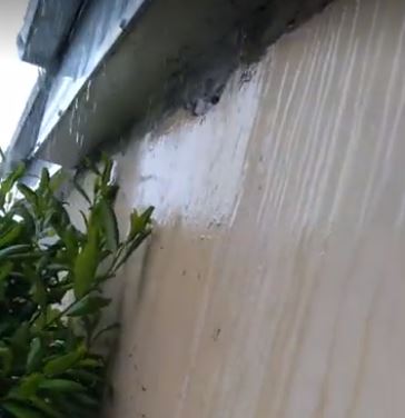

However, the new roof and guttering is poorly done, in heavy rain 1/4 of the roof run off is guided through one tile "dip" and hence a huge amount of water just pours off and clears he gutter.
In light/medium rain, water goes between the facia and the gutter (and down the wall) and also, we think, below the tiles onto the felt (which is lower than the facia/gutter) and hence water goes down the inside of the facia down the wall.
We believe the roof tiles are normal roof tiles and not designed for very shallow flat roofs, they are also badly fitted. We believe the guttering is too small, under spec, no membrane etc - and only one downpipe (that until recently went into an overflowing water butt).

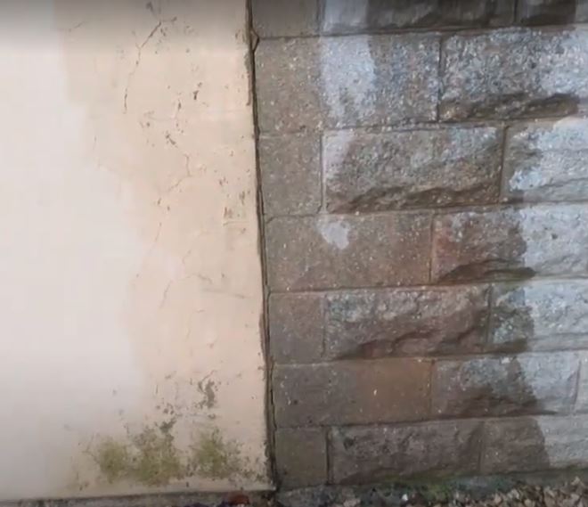

4yrs after initially telling them of the water overflowing, the wall is damaged, paint/render cracked and coming off, and green alge at the bottom, of the wall and lots of excessive water on our land.
A builder found nothing wrong (lol) and now covid is stopping any action (yeah right)
The wall is on boundary but only we see it - we maintain other garden walls and are happy to paint - but I'm not wanting to spend time/money repairing/repainting their wall every couple of years due to damage they cause. Also I get excessive rainwater literally pouring over.
No comments on deeds or PP
4yrs is enough patience and putting up with poor excuses.
But what are next steps? Have a more formal argument? Report to building control? Legal house insurance avenue? Or just put up and look at a grotty wall?
(pic below shows some of the damage and obvious areas where water is running down. Its worse in other places. Water can be seen running down the wall and "clearing" the gutter - just hard to photograph when its raining!)

1 - the roof/guttering structure is not fit for purpose, so rain water pours down damaging the wall, causing paint/render damage and algae to grow (arguably cosmetic - only we can see it - arguably damaging our "garden wall" (aka "their house wall" - same thing - it was a garden wall they simply used to put the roof on to.
2 - there is excessive water from the roof that in heavy rain, the water clears the gutter and pours onto our garden path under 1m away from our house, and by pour I mean pour - a torrent - and I do not wish to start suffering from water damage

The felt-covered roof wood is sadly about 1.75" BELOW the top of the gutter - with the ends of the tiles on top of two battens above that. So the eaves trays would only work between the battens and tiles and indeed stop 50% of the issues. (tested with some water proof gaffa tape which has proved point of principle to reduce the water) If this would solve all I'd JFDI.
40% of the issues is the water running under the tiles/battens and to the back of the facia and then out the bottom/against the wall - and not really a way to get that back into the gutter - without having the entire end of the roof redone, facia lowered, guttering replaced etc which I could not do without other imacts)
(10% of the issues in heavy rain could be sorted by a "plate" to catch the torrent and divert back to gutter, though that'd then probably overflow the entire length.)

As a taster, imagine standard double roman tiles on a 10' slope with 2x 50mm high battens on top of each other supporting them, and under that, flat roof with felt. So tiles >2" above the felt. Vertical PVC fascia board boxes in who knows what, and ends just under the tiles (hence 1.75" drop on the inside to the felt. And the guttering at the top of the fascia board. (not supported enough so it bows, not wide enough or deep enough for the flow off the roof.
Cosmetically, from ground level looks OK to be honest. Hides a multitude of sins!!
