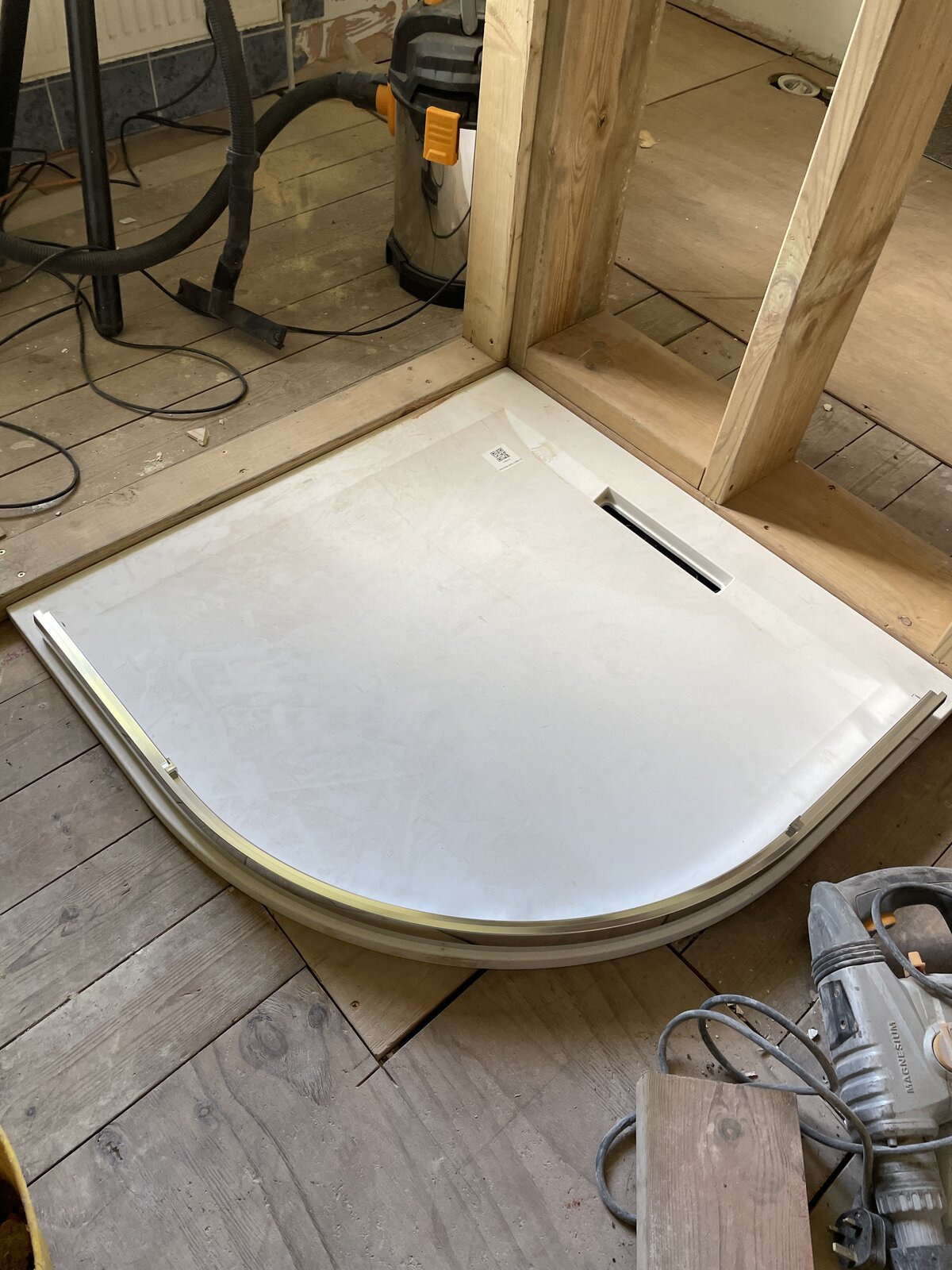

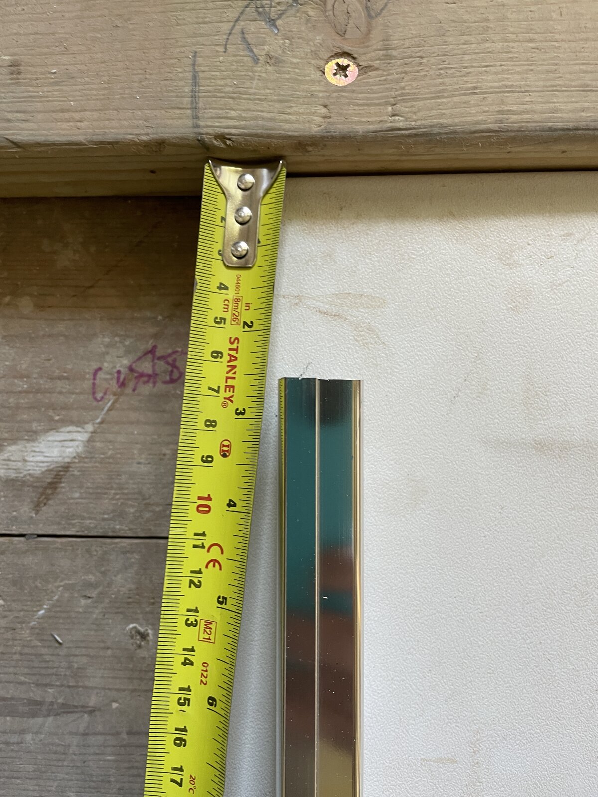

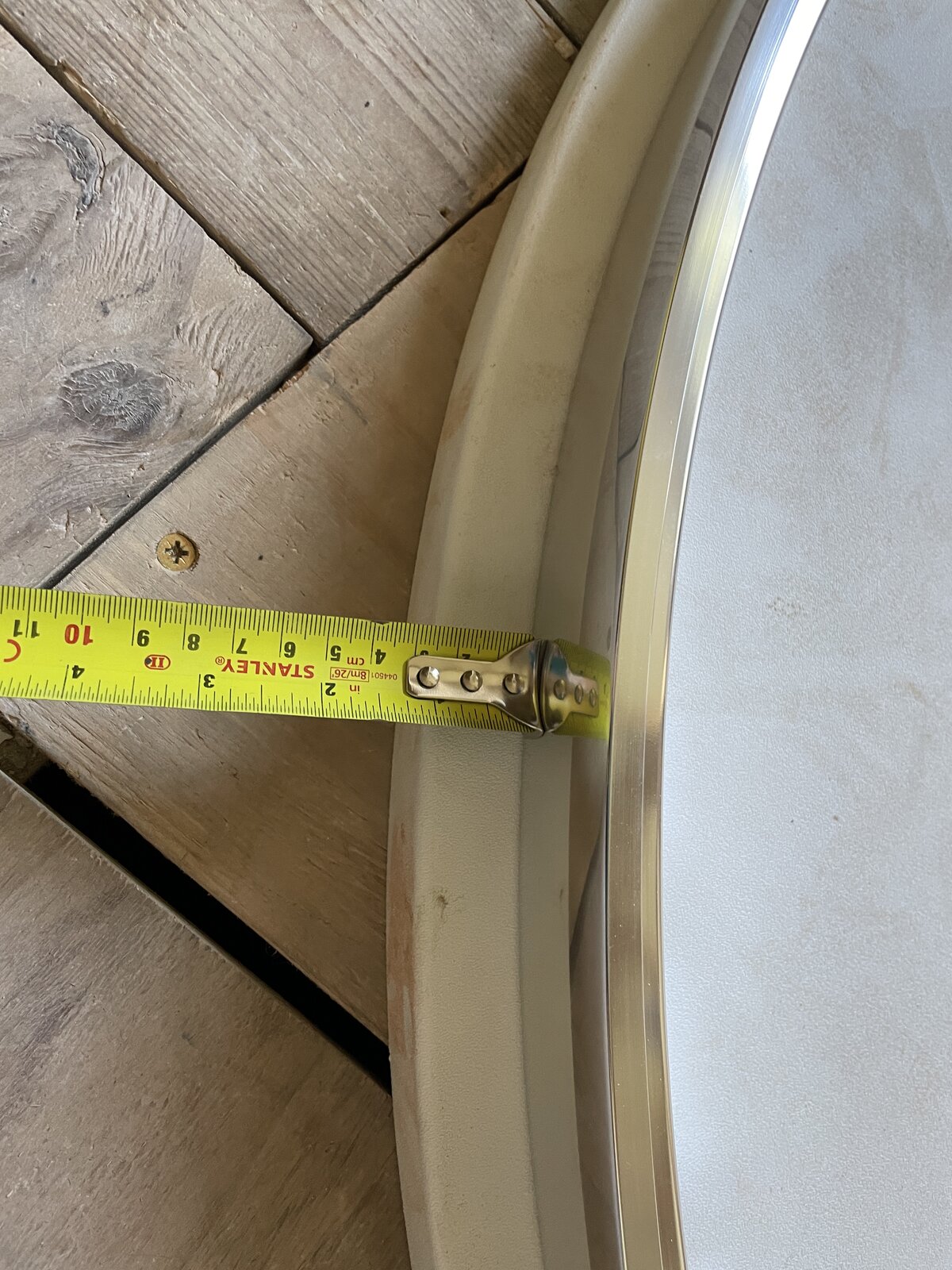

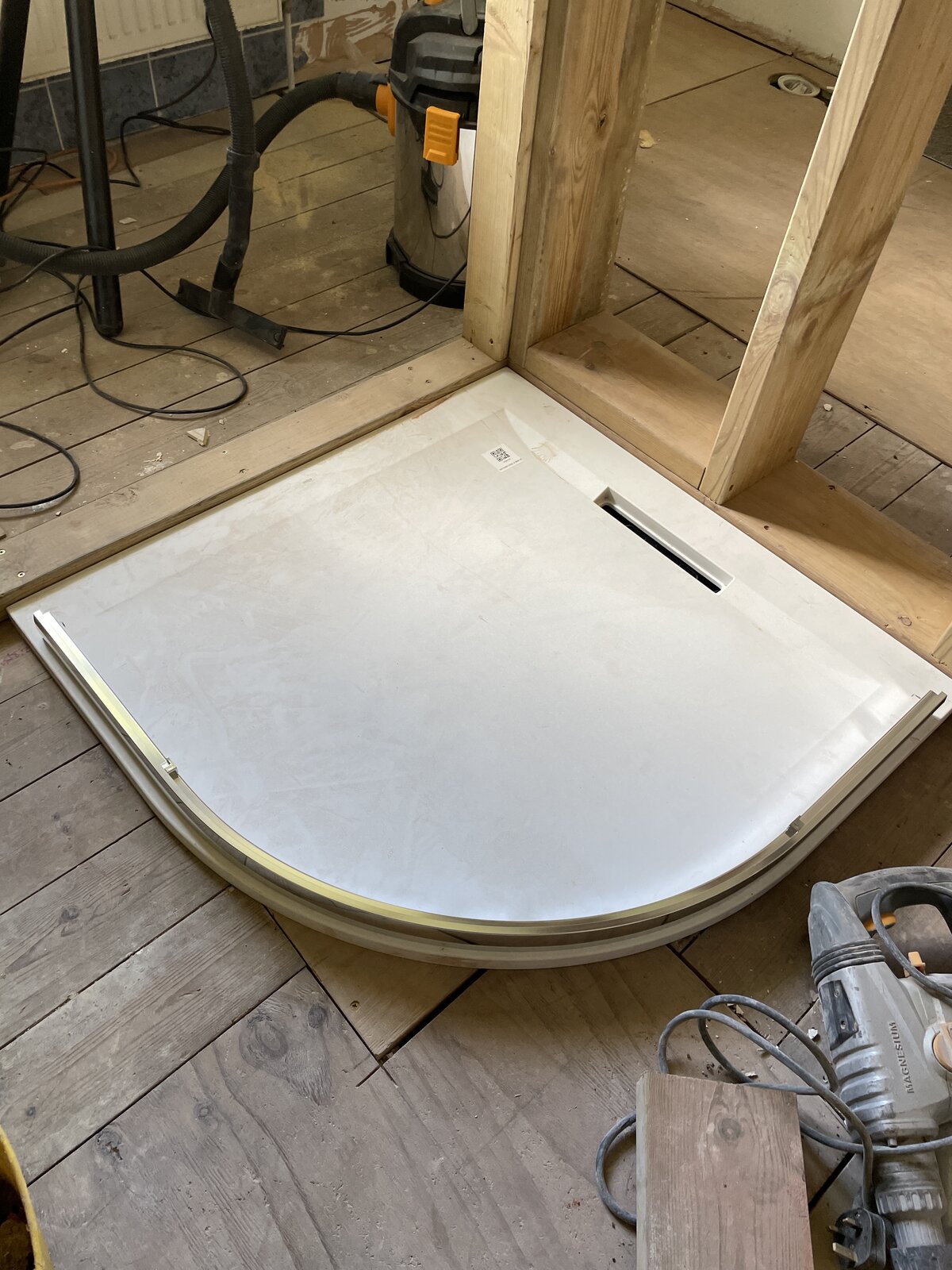

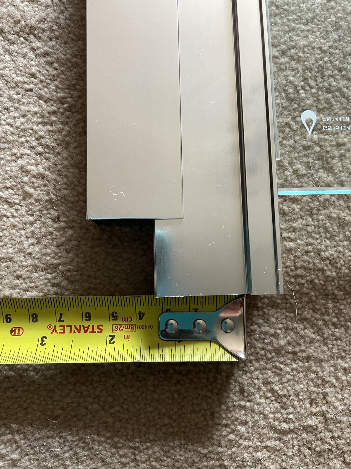

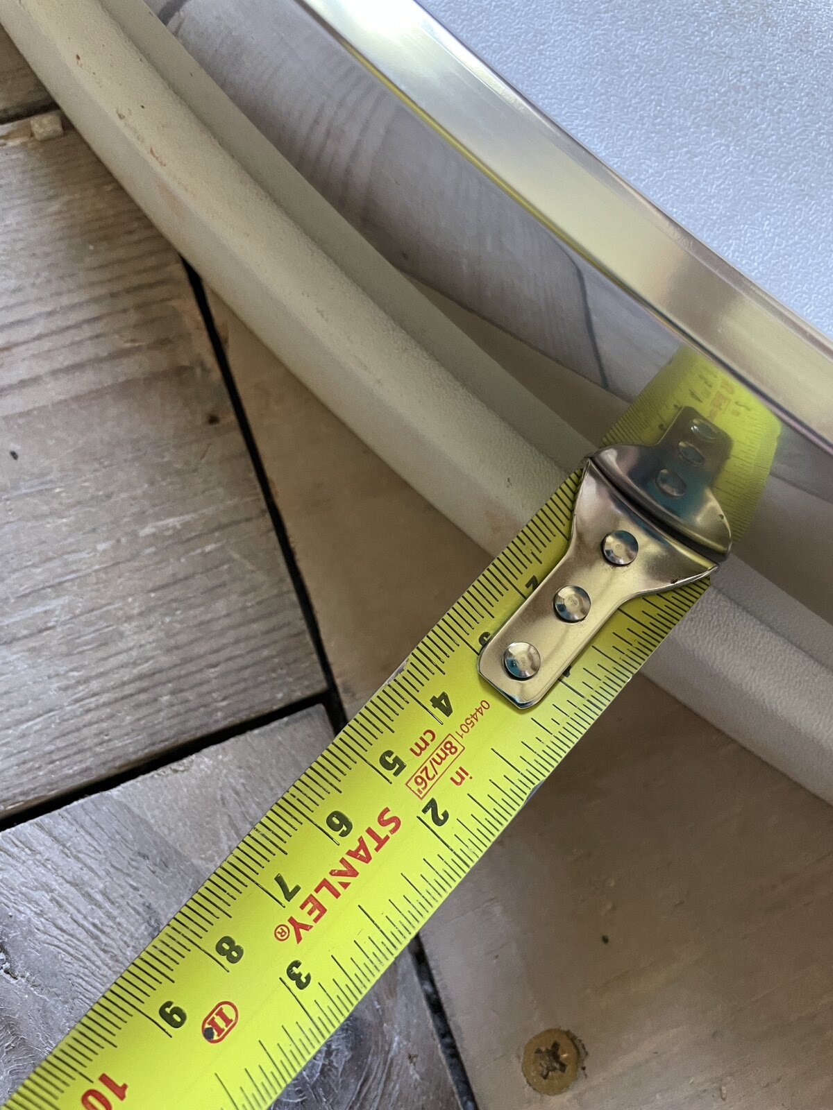

Might be a silly question but is the curve on a quadrant shower tray the same across brands?
I have a Mira shower tay and an Aqualux enclosure. Im have trouble getting the enclosure to fit.

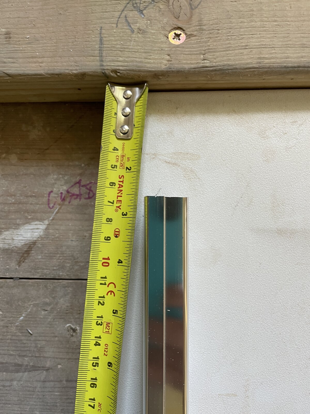

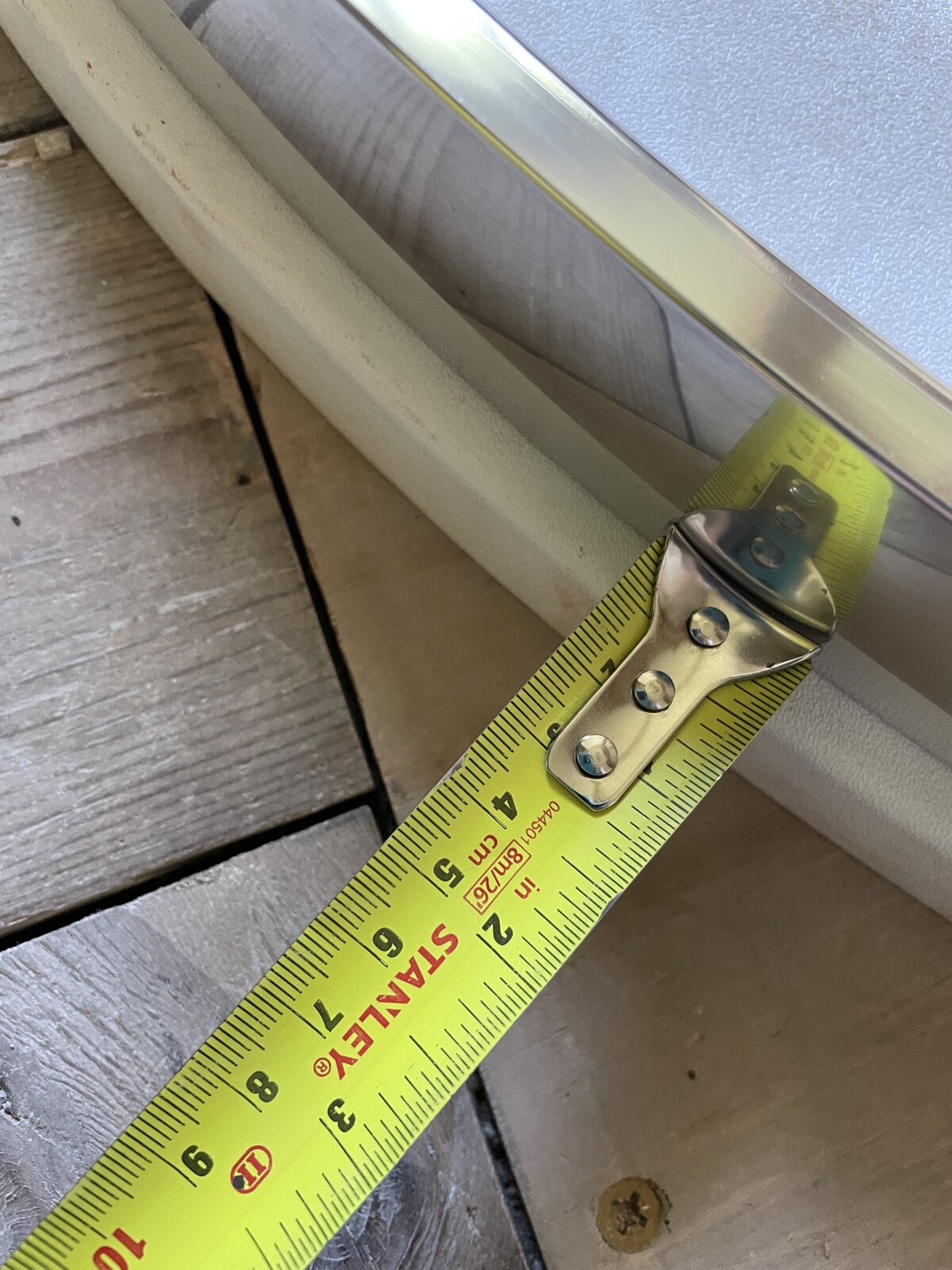

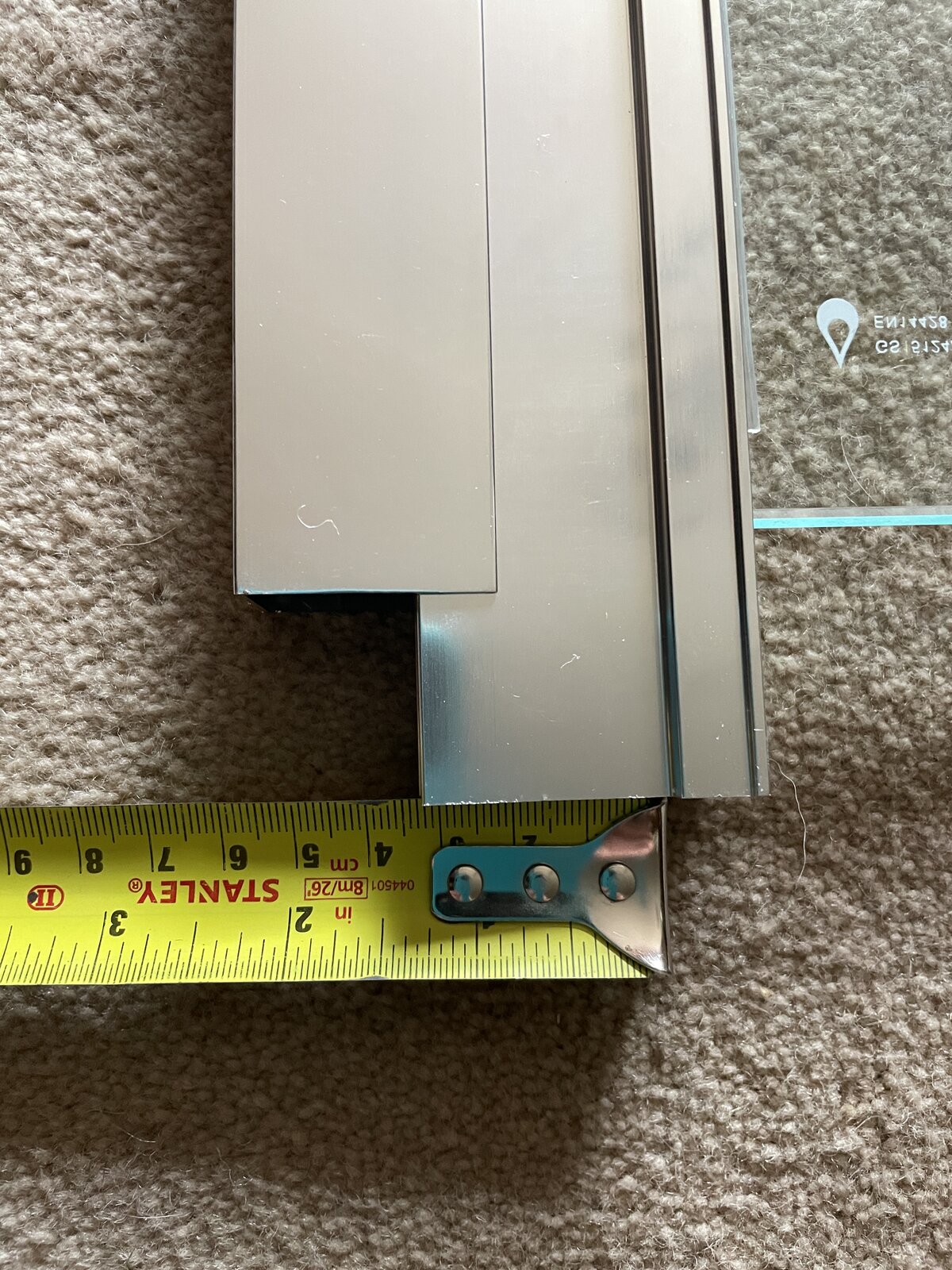

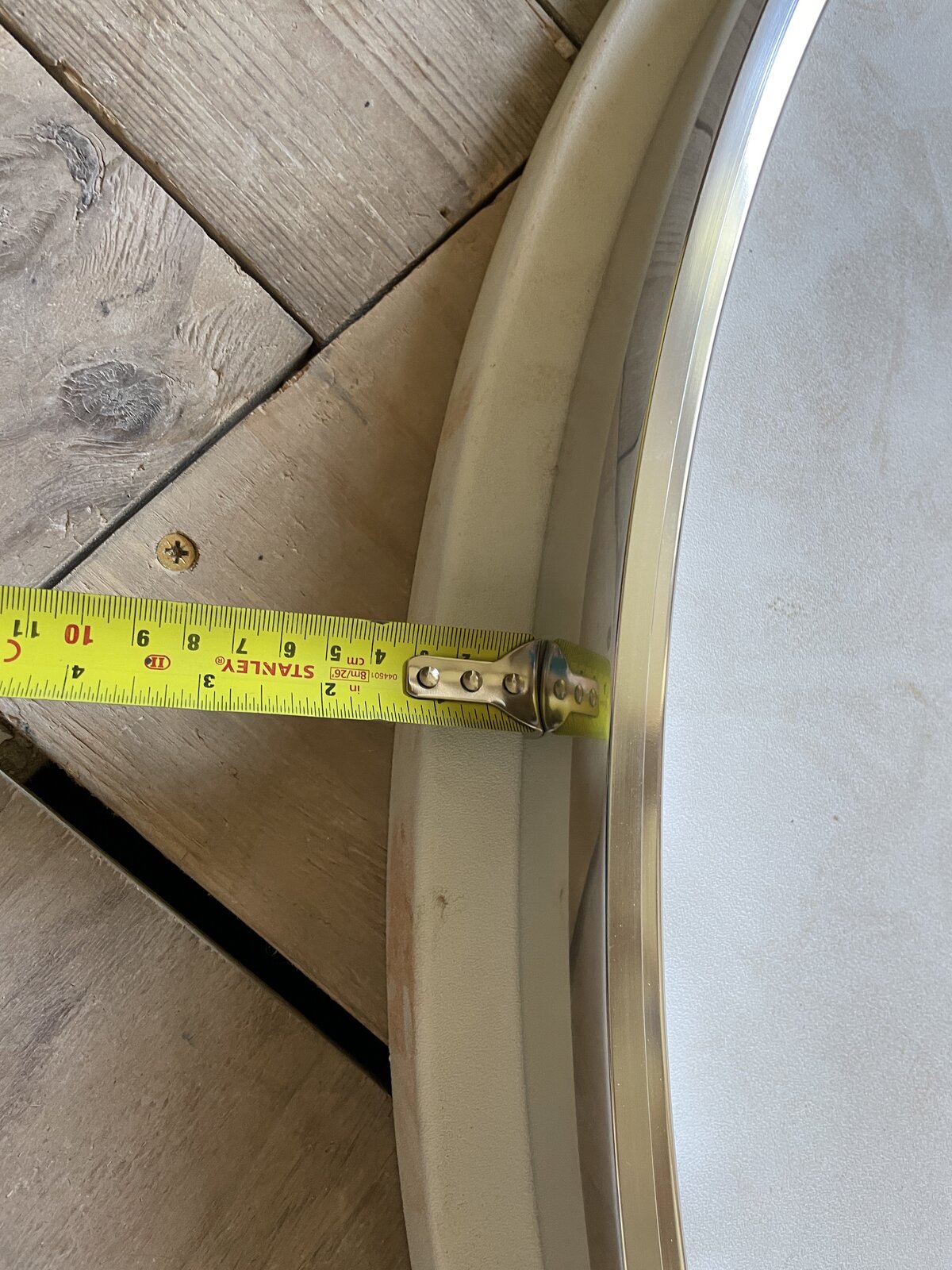

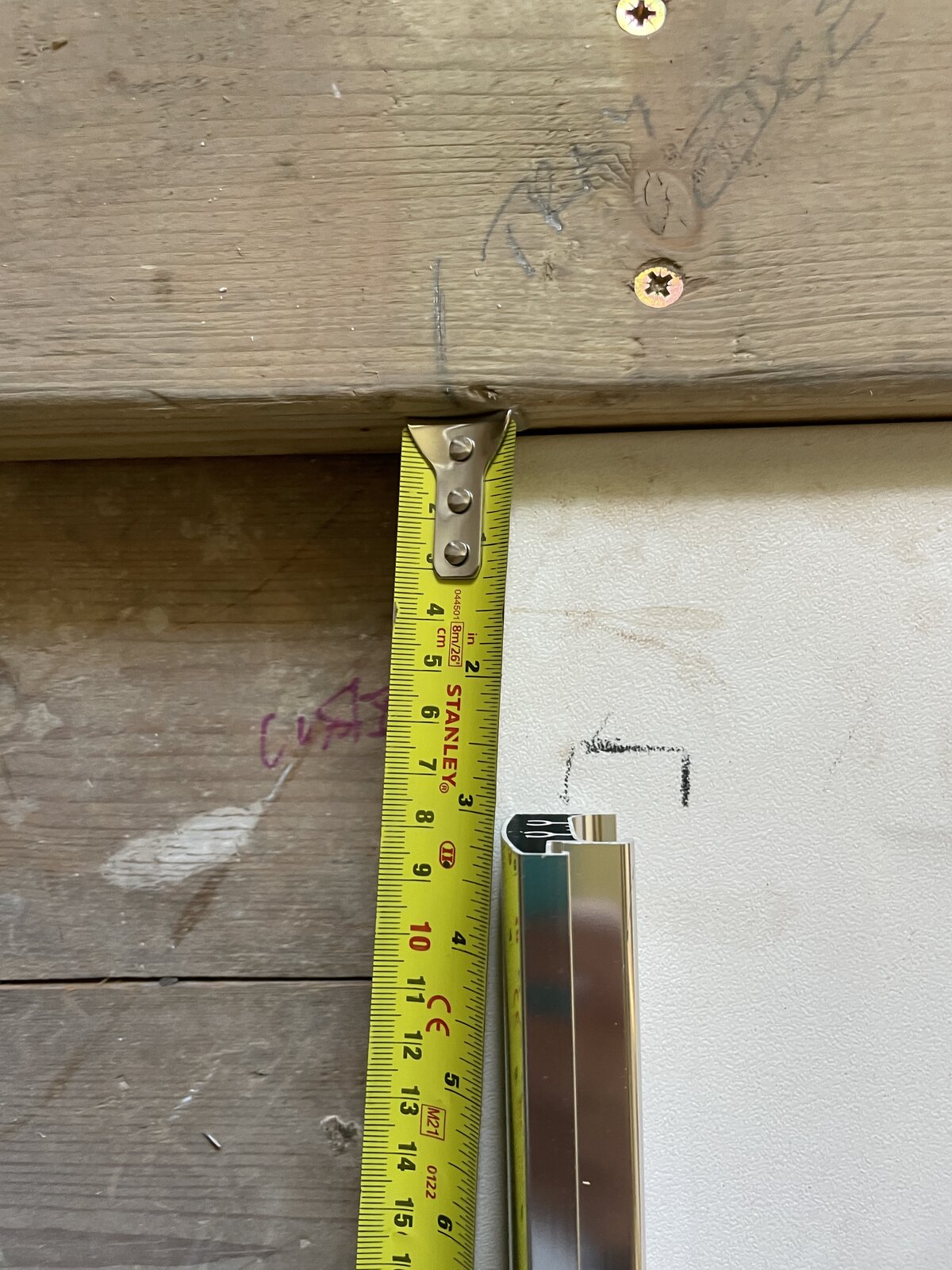

As you can see in my attached photos if I place the quadrant enclosure base onto the tray it sits approximately 80mm from the edge of the wall. The side panels are approx 30mm with an extension of around 25mm.
Allowing for a 10mm shower panel I still can’t get the edge to reach the wall. If I move the base inward and expose around 30mm or tray (reducing showering area) the I can just about get to the minimum but obviously this is not an ideal solution.
Thoughts?

25mm panel? Was planning on 10mm max probably have to run12.5mm plasterboard on top of the tray as well.
Might just get there, still not sure why they think I would have 50mm of wall thickness on top of the tray, (not allowing for the extension).
