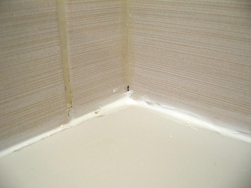

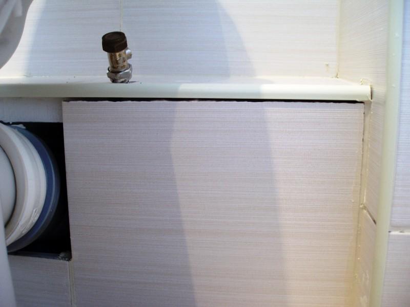

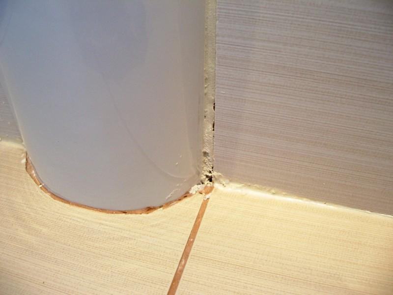

Spent yesterday afternoon washing down the walls and uncovered what I consider, admittedly as an amateur DIYer, to be sub-standard work and incomplete tasks.
Typically these issues are spacers visible in the grout, holes in the grout and sealant, grout lines incomplete, varying grout line widths and tiles misaligned. Photos attached.
I’m reluctant to give him the opportunity to rectify the work and more inclined to make good some of the corners with skirting, quadrant tiles, etc. myself.
In advance of the bun fight that will take place on Monday when I tell him I've stopped his cheque does anyone have any comments or advice ?

It's certainly not a pro finish but that quote seems a bit on the low side to me. How long was he there?

An awful shoddy job. I'd not only stop the cheque, i'd stop him breathing too, so he couldn't do a job like that for anyone else,,,,,, shocking!!
CFRB
thats as rough as a badgers a@@e mate...wow..
anyone thats uses spacer inserted between tiles is dodgy to say the least,when tilie fixing you should always use the spacers as pegs,so things like this dont happen..
as for the rest of it...jeez!!!!
think you should get "roy rodgers" back and speak/show.. him the errors of his ways..and ask him to rectify the problems,if he says its ok,then dont pay a bean...

you have to give this "tiler",,(i say this lightly).. the chance to redo his work,..(at his costs i may add and not yours)..
if he doesnt redo to a very good standard..then you are within your rights to withhold payment...
or you could get another tile fixer to view his work and give you a written document off works that need redoing etc...
Fair comment CFRB. Word of mouth/personal recommendation is always the favoured option for most people looking for a tradesman, rather than a shot in the dark, although you can get lucky sometimes, and get a good tradesman. I'd get another opinion from a local company, to add a bit of weight to your criticism of his work.

I'm trying to source a local tiler near Weegie-ville to view the work using friends, colleagues (and voodoo) just now.
An independent & confidential opinion and report would be a great starting point.
As for the original contractor making good...
You’ll understand my fears on that one, but I’ll at least give him the opportunity.
However, given there is barely a square metre that I think is better than average, rectification to a professional standard could require a rip out.
