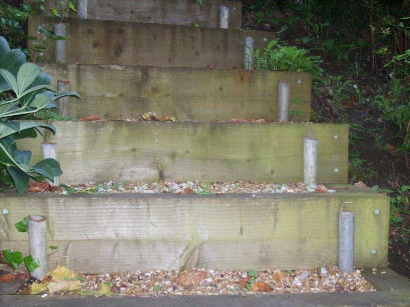

I am building some steps up a steep slope
I am basing the design on our next door neighbours (pic attached) and I was wondering how to drive the metal posts into the ground. it looks back breaking! and also where to get them from - or any oher alternatives you could think of.
bare in mind I haven't done this before, so i don't have much equipment...

would it be very hard to just hammer them into the ground with a mallet? i think they are around 4 cm thick
do you mean the metal posts? probably not that difficult, so long as you don't hit a rock on the way down and the posts are strong enough not to go out of shape when hit. I'd have thought that the difficulties might arise from (a) acquiring suitable metal posts -- though you might already have some (b) cutting them to a suitable length --- difficulty will depend on how strong the posts are and what tools you have available and (c) getting them to hold the timber nice and firmly.
you might have a look at this where they didn't have any supports at the front at all but used rebar (steel dowel) and bolts
http://2minutegardener.blogspot.co.uk/2011/04/garden-elements-landscape-timber-stairs.html
this design actually looks like the one in your photo minus the metal bars. whoever built the ones in your picture used what look like timberlok screws --- should be easy enough to screw through new softwood sleepers if that's what you'll be using.

Sleepers are often fixed as mentioned by drilling holes and simply hammering pins/rods through them into the ground.
I would be careful using sleepers as treads for steps because they are deadly slippy when wet or at all green/ mouldy.
Your neighbour looks to have used off cuts of scaffold tube. This would not be that hard to hammer in with a sledge hammer.

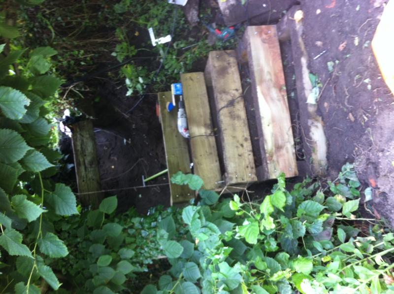

In the end i went with the concrete option. A friend told me about postmix - i never knew how easy it was! ive put up a pic of how far i have got..
I have drilled holes in the undersides of the steps, put some steel bar in the holes, and then pushed the step through the postmix into the ground, and then watered the mix....i think this is the correct way of doing it...
i have also screwed each step to each other using landscaping screws.
Im a bit worried about the underlying soil as it is very soft and sandy, and is basically just crumbling away..
I would have painted the sleepers with creosote had i read this earlier...although i was looking elsewhere and it said its hard to put anything on to sleepers until theyve been hanging around for a year or so. do you think i need to put something on to reseal the exposed wood where i have cut the sleepers?

sorry for the sideways pic!
also to answer the other things. i have twelve steps to do (7 left)...and they are softwood.
