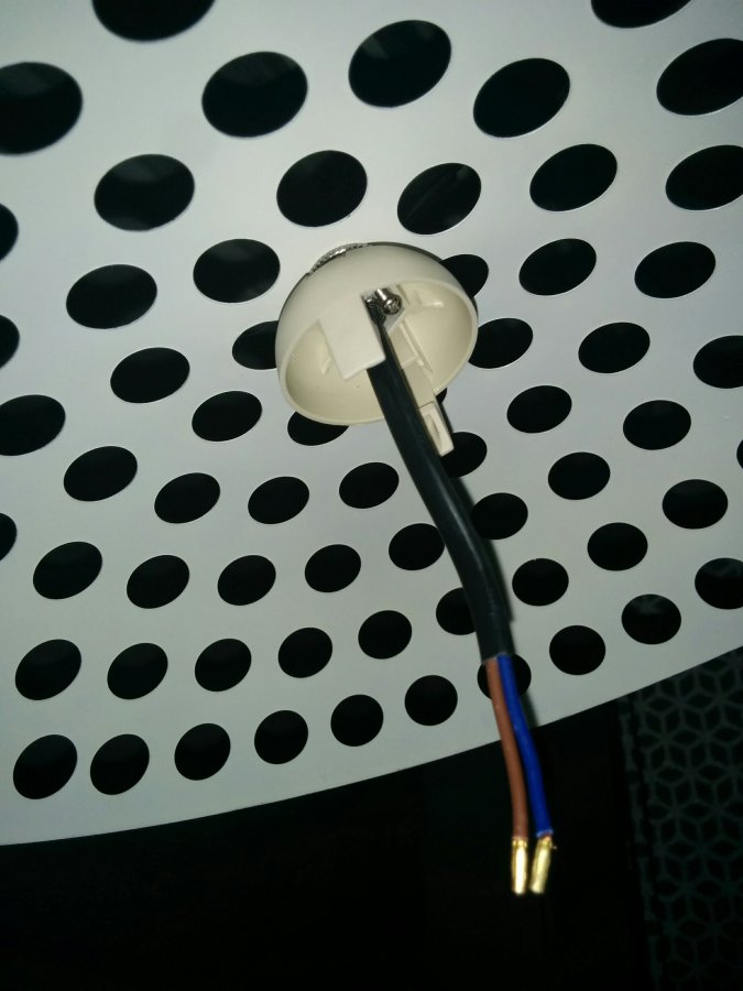

Question re lamp wiring
11 Jan 2017
3

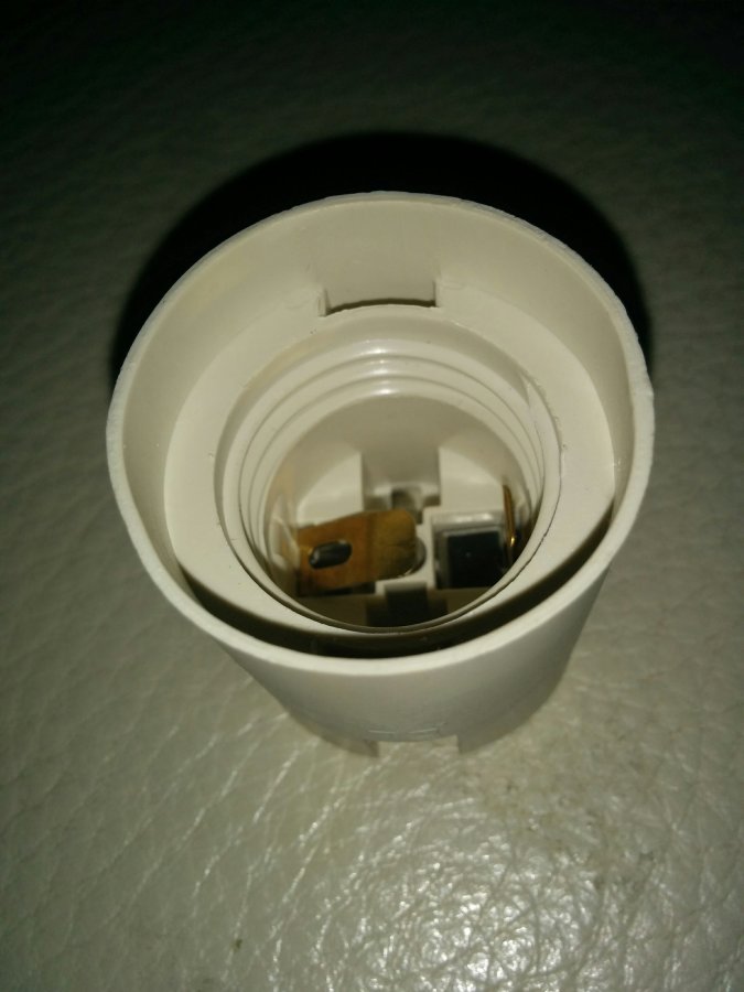

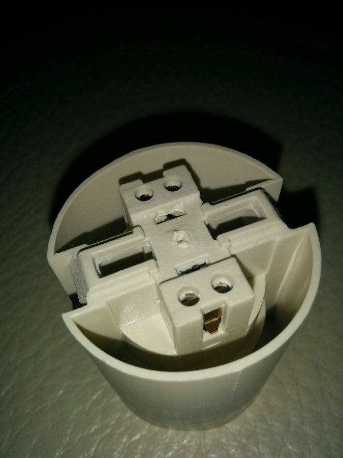

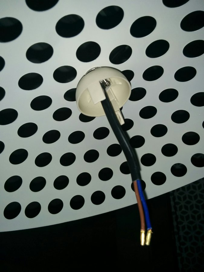

I'm trying to write an Arco lamp safely but it has a lamp socket connection I haven't come across before, see pics. Can anyone give me a steer on which wire's go in which holes and how to secure them? 1484167300172-772219704.jpg 1484167364771-1450301149.jpg
looks like a maintenance free push fit terminals - one wire in one of the small round holes on each side and and polarity shouldn't matter (open to correction)
If it is an Edison screw lamp holder, the line should be connected to the centre contact.

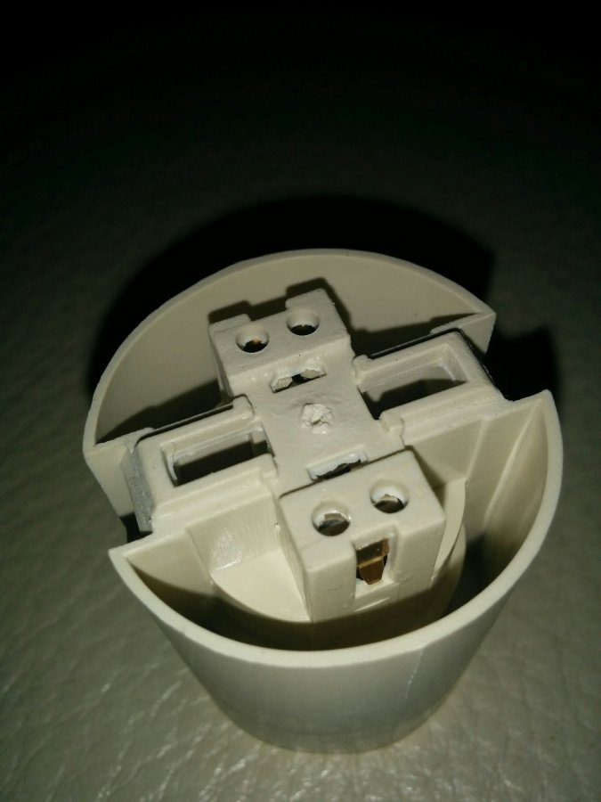

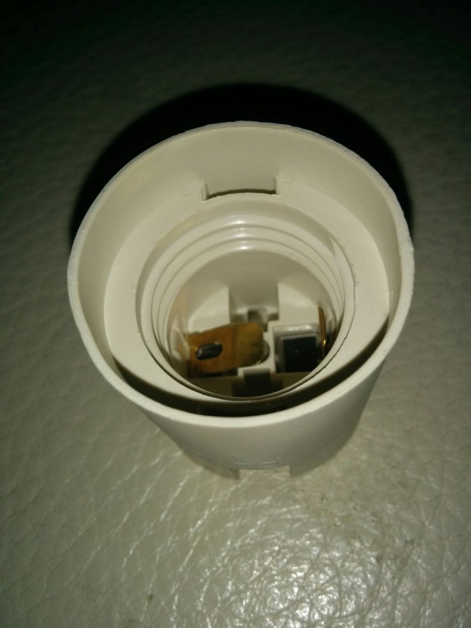

Photo of the other side of the lamp socket

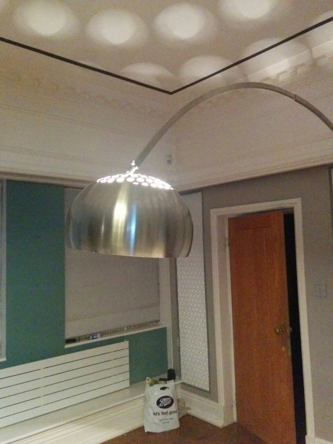

Thanks for all the advice. That's done the job!
