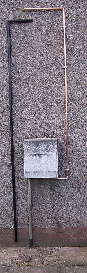

Hi
I have just had a GCH system installed, and on inspecting the work I noticed the outside copper gas pipe going from main gas box to the boiler upstairs has no cover over it. I am just wondering is this normal practice - I would have expected it to have a conduit of some sort over it?
Also the black condense pipe from the boiler stops short of the ground - I thought this would be buried into the ground.
I am just wondering if I should take this up with them, or is the norm for GCH installation ?

The gas is okay (as far as no cover is concerned).
The condensate most definitely isn't - does not comply.
Is the ground a walking route? It will be an ice rink in winter.
Also the condense water is acidic so will eat away at the path.
The gas pipe could do with some identification tape on it aswell.
It should be fairly obvious it is gas without awful yellow tape all over. ID tape is not required on domestic
Thank you very much - I think I will take up both these issues with the installer. I think the gas pipe would certainly look a bit better with a conduit.

you can paint the gas pipe black to match your condensate pipe, it will dull down over time anyway and be a bit less in your face bright.
the condensate needs to go into a soakaway like this.
if it isn't you can expect your concrete to be eaten away by the acidic water
Thank you for this information. So my question now is - are the central heating installer company obliged to install a suitable soakaway, as described in the diagram gasmanstu72 posted above ?
And is this a requirement for building regs ?
What type of company did the install?. What is the rest of the system like? (just being nosey).
They should certainly have complied with the requirements regarding disposal of the condensate. There is sometimes more than one option available, obviously we cannot see which were available, but yes, he is responsible for doing the work correctly.
I would be more concerned about the winter slip hazard than degradation of the concrete - he probably thought it would soak away through the impressive making good of the path above the gas service;). It may not do the brickwork any goo though.
As Dan suggests, any attempt to clad or cover the gas pipe will not improve it. You might, however, be concerned about toe rags nicking the pipe, but that is not the installers issue, unless it was pre-discussed and agreed.

Wouldn't that also be at risk from freezing in winter unless it has trace heating or other anti freeze mechanism/lagging? and it should normally be increased to 32mm too if run externally?
It looks like either 32mm or 40mm. Regardless of the pipe, the ground will be a bit slippy. The OP has not said whether it is a walkway
