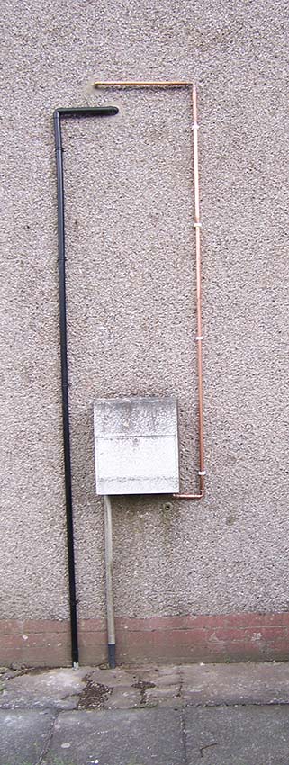

I thus have 3 issues - the shower, the copper pipe showing outside, and the condensate pipe stopping short of ground with no soakaway.

For the umpteenth time, there is nothing wrong with the copper pipe. Yes the condensate drain needs sorting, but there is no point getting neurotic over things unnecessarily as it will lessen your position on the things that DO need addressing.

Regarding the copper pipe - on driving past some neighbours houses today I noticed a couple of them with a gas pipe from gas box going some way up wall and into house, and this gas pipe was about same diameter as my copper pipe, and apparently painted black - so that would appear to be the done thing. The issue of some idiotic person trying to steal the pipe is a fact - there have been issues of burglary in my neighborhood recently, and also 'metal thieving'. What kind of paint would be most suitable ?

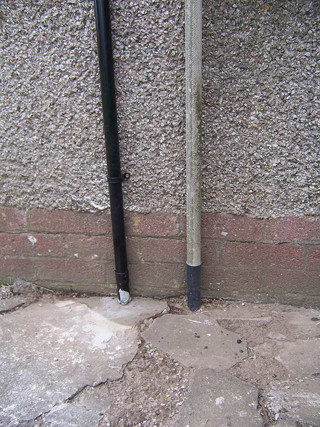

However they came up and fixed the condensate pipe, which now goes some way under the ground into the earth, and has been concreted over - though the guy did not put lime chippings onto it. I have trusted he has done it satisfactory, and hope there will not be any problem with it. I did some research and found the pH of the condensate is about 4.8, whilst rain PH is between 4.2 and 5.6 (ref http://www.epa.gov/acidrain/education/site_students/phscale.html)

One point of confusion was re painting the copper gas pipe - the surveyor/boss guy said I shouldn't paint it and it would dull in time - and I think he said acid in the paint was bad for the copper pipe. However I asked the engineer who came up to fix the condensate pipe and he said I could paint it if I wanted with metallic paint. I notice that a couple of neighbors have black painted copper pipes.

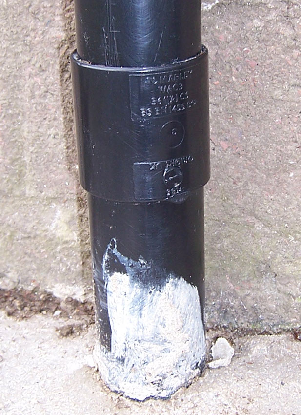

Looks like theyve drilled a hole in that coupling so when it backs up it overflows out? And no its still not installed correctly if theyve not put a soakaway in and some limestone chippings
There is no hole in the coupling - that is just part of the moulding (see photo).

I bet they have jst broke through theconcrete and tuck the pipe in, it needs to be a purpoe made soakaway or one made from some soil pipe to the correct spec it Must have lime chipping and also be a certain distance from the house, still dosnt look right to me.

they've bodged that condensate pipe for sure,
they soakaway has to be at least 500mm from your house (a little under 2 feet), there's not any evidence that i can see of them digging anything up that far away.
i bet all he did was to dig a small hole next to the wall and tuck the end of the pipe below the surface, thats no good.

In freezing cold weather the trickle of water in that condensate pipe will freeze and eventually block the pipe. The condensate sump in the boiler will then become flooded and the boiler will at best shut down ( safety device operates ) or at worst the burner / heat exchanger will also become flooded and damaged.
Thawing out that length of plastic pipe will be a nightmare task. And it will just freeze again.
It should have been run inside the house with the absolute minimum exposed outside the house. It could be routed to discharge into a sink or bath drain pipe. Then the risk of freezing is almost zero.
An air break at the point the pipe leaves the house ( such as a tundish ) will provide a route for condensate when the pipe freezes but will mean some staining on the brick work when condensate runs down it. ( but at least the boiler will still be working. )
