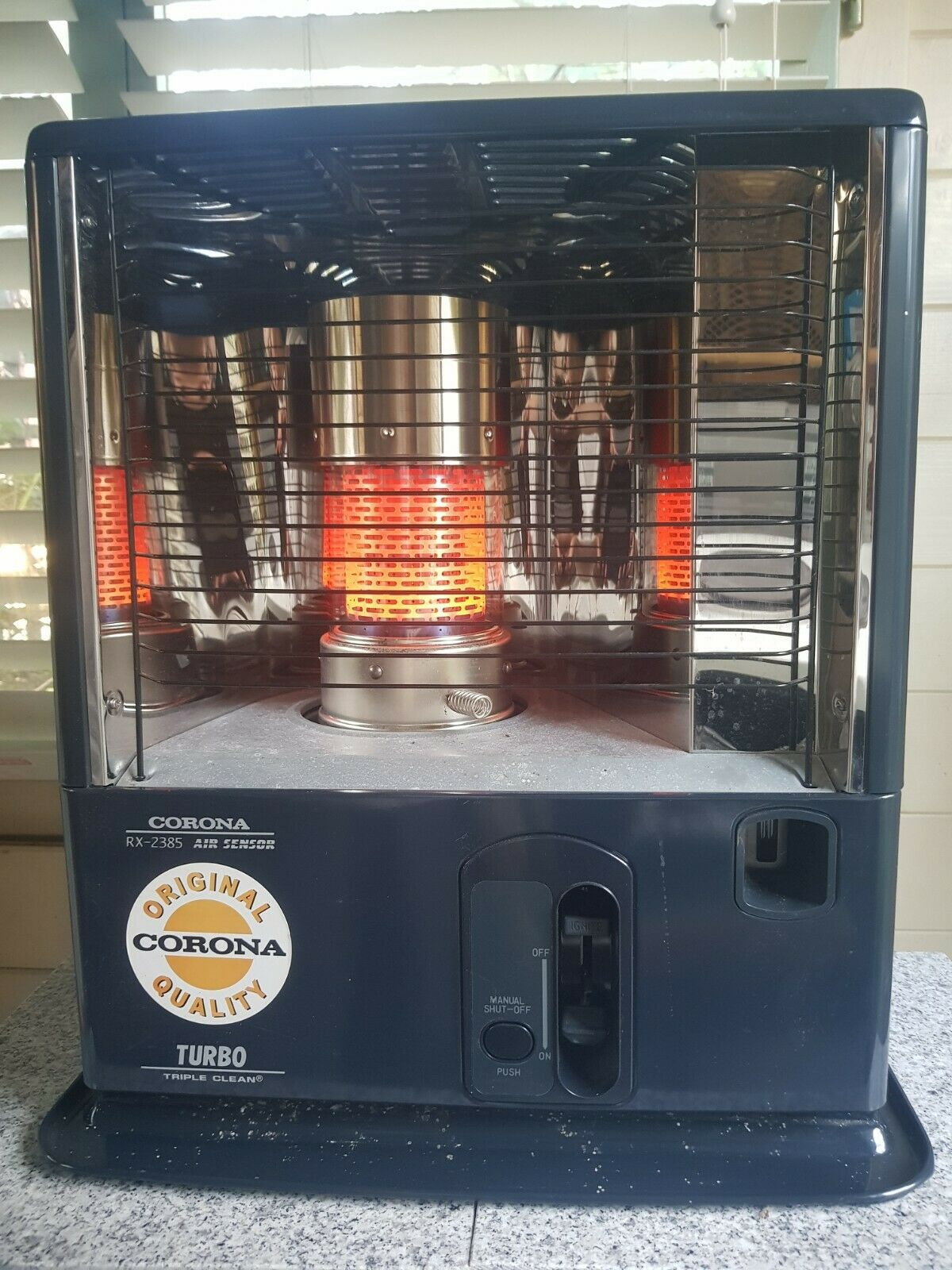

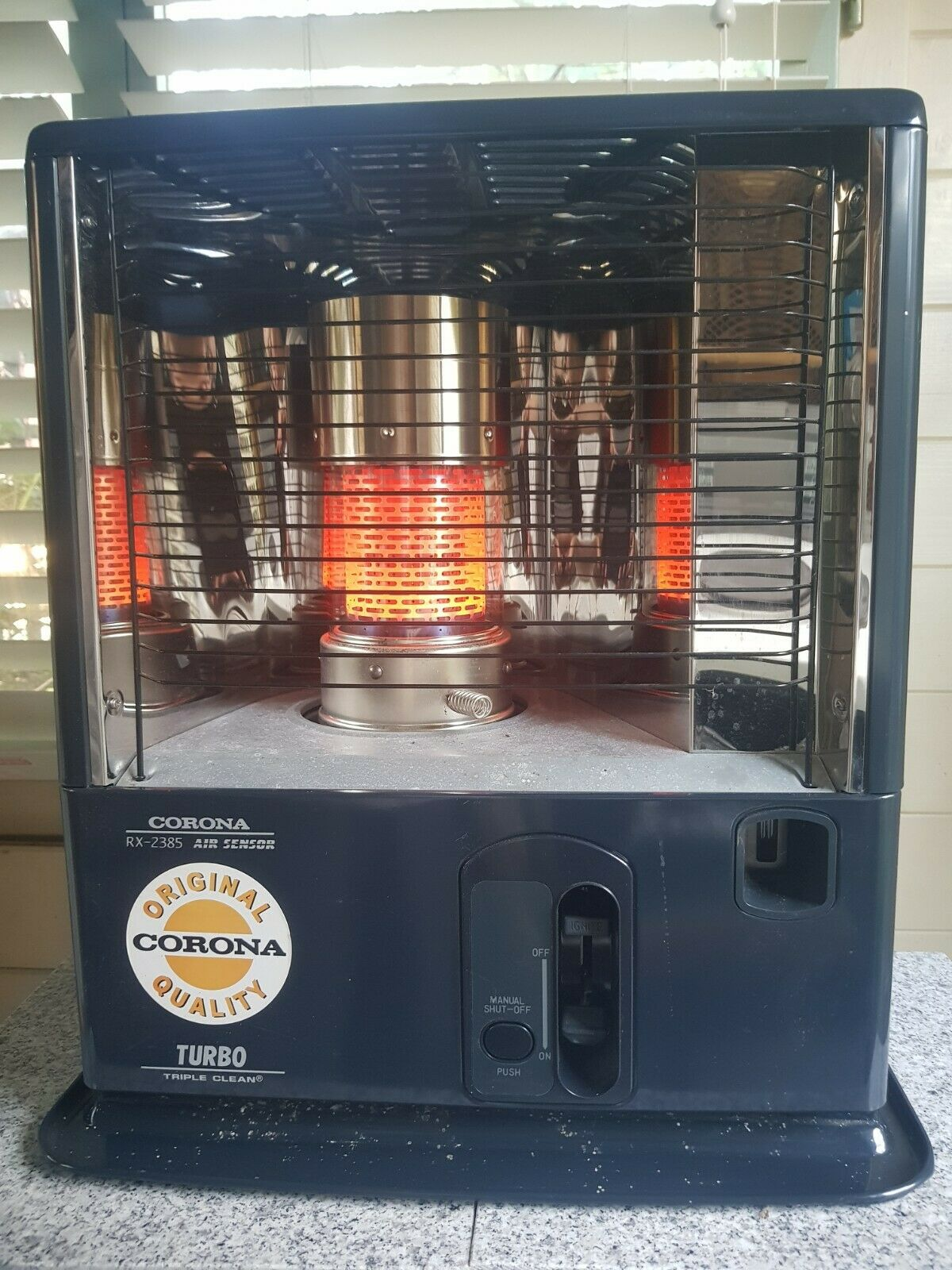

Oh yes oil heaters may be cheaper to run I use one myself, but unless they have a flue the home can get very damp, upload_2022-1-9_18-2-10.png this may look good, but I would not want one.
Very funny, seems it did work, wonder if still used today? Would not think so.
