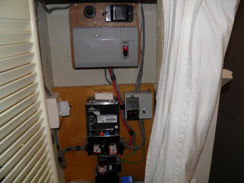

As always, pictures of consumer units and metering would help.

Thanks everyone for all the replies, I have uploaded two photograph to my profile of my meter/fuses as advised.

The single C/O to the left is for the electric shower.

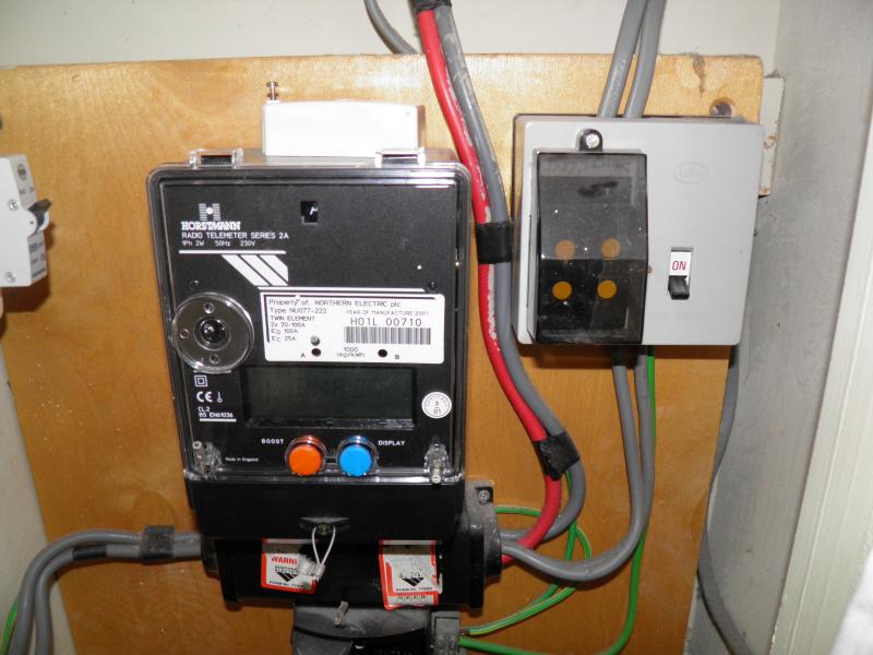

So is there definitely a teleswitch there and if there is a fault with the teleswitch is it Npowers responsibility?
Anna
Difficult to say from those pics - can you take a shot below the teleswitch?
Where is the meter? Photo of that? Or is it part of that teleswitch (actually, looks like it is). Difficult to see the bottom terminals of the meter.
I don't suppose you have neon indicators on the switches supplying the heaters?
I would assume the two way consumer unit is supplying your heaters, but that would need confirming - can you turn that off and see if the heaters stop working? It looks like it has the incorrect fuses, but that would not prevent things working as they should...
Assuming that two way CU is connected to the switched output of the teleswitch (seperate from the other tails to the other two CU's, then it should be being switched during cheap rate - this would be NPowers responsibilty to sort out.

As per above, could do with that one more photo, but it really does look as if your meter should take care of switching the E7 supply to the small consumer unit on the right.

I have put three new photos on my profile. The meter is on the original photos but the new photos should be better quality.

There is a switch on the right of the consumer unit with a label above it saying "ON". If you push the switch up, there should be a label below it saying "OFF". That's it.

You actually appear to have 3 consumer units, a large one above the meter, a 2-way one to the right of the meter and a 1-way one on the adjacent wall to the left of the meter. The 1-way unit has had the fuse replaced by a miniature circuit breaker (with a little black switch). It might be that only this 1-way consumer unit is switched by the supply and that could be your hot water immersion heater.

The small one way consumer unit to the left of the meter is for the electric shower. I recently had the fuse replaced with the miniature circuit breaker because I had two fuses which blew while I was in the shower.
Now that I know which is the two way consumer unit I can switch it off and see if it stops the storage heaters working.
