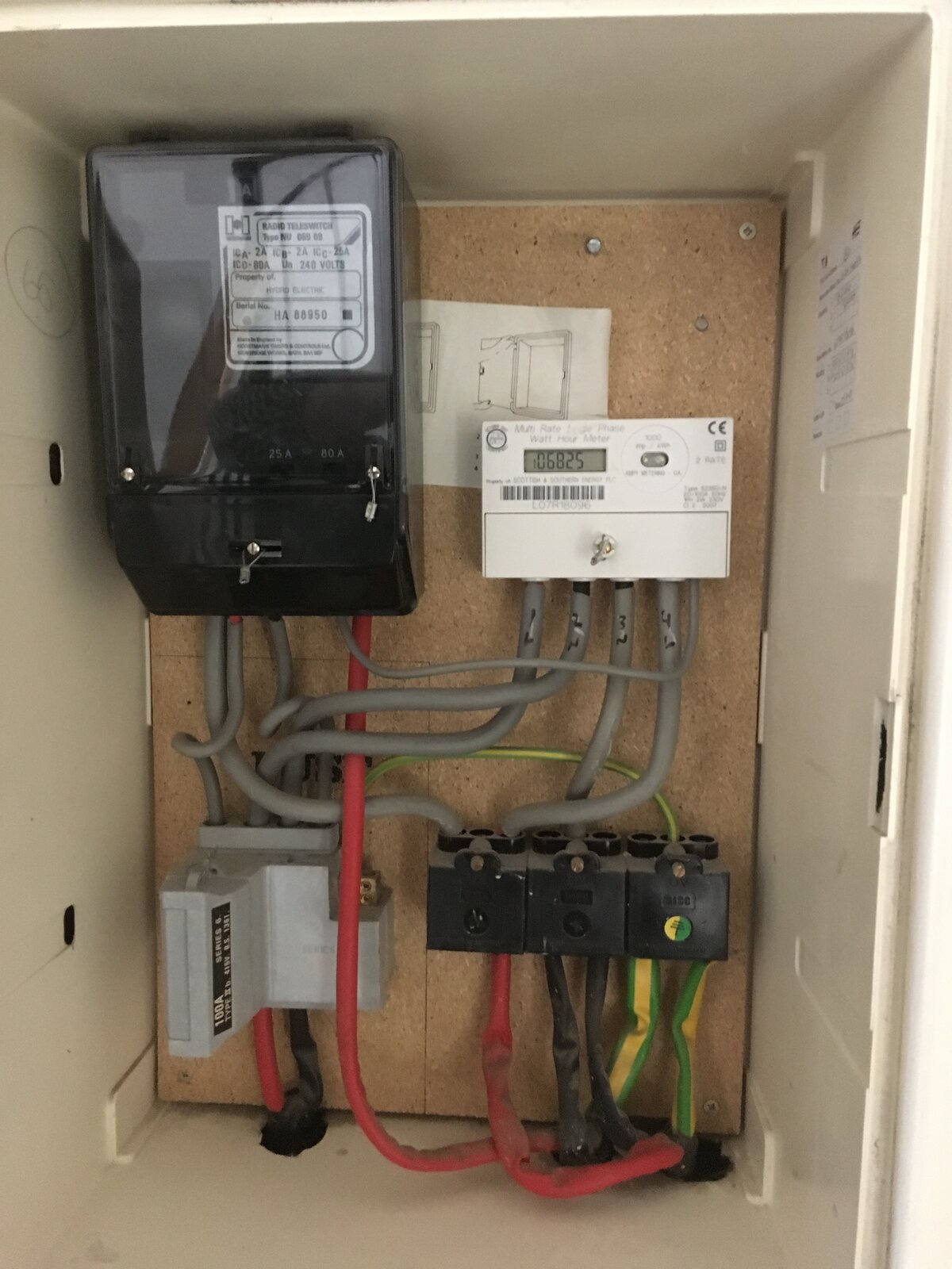

Thanks for the reply. Each flat has it’s own meter cupboard (photo attached) the first photo shows the cupboard as it was originally, the second one shows the replacement meter which replaced the time switch and meter (I don’t have a photo of the cupboard after the meter change).
It looks like there is no cheap rate connection, but need this to comment further:
Separate supplies to the flat in the first pic then so no contractor.
As already mentioned, need the full shot following meter change to see what’s happening with those connections at the bottom right.

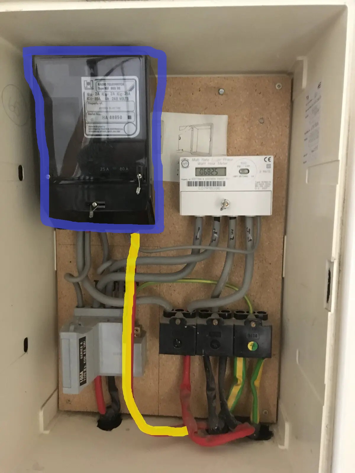

The black box highlighted in blue is what used to switch the storage heaters.
The wire highlighted in yellow was the supply to those heaters.
The new meter appears to have 5 wires connected - if that heater supply is one of them, then either:
the consumer unit for the heaters is switched off (solution - switch it on)
or the meter is not switching the output (solution - contact energy supplier as meter isn't configured correctly)

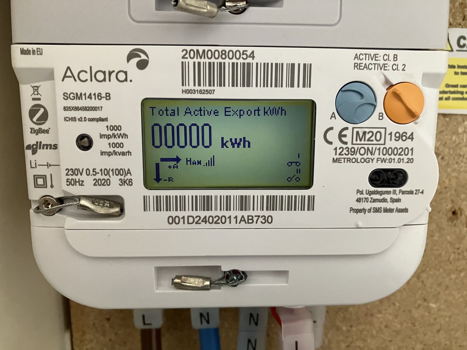

If the flat had a duel rate meter previously then if the replacement is a 'smart' meter then the people who fitted it have fitted the wrong type - they should have fitted a '5 lead' meter (according to the last fitter who didn't fit a meter in my house because he didn't the right meter with him).
I also had the guy who came to fit meter refuse, saying job came on phone not tablet as reason, and it seems like wrong meter brought with him.
I know there are AMI and AMR meters, but it seems there are more than one AMI types.
The new meter does have 5 connexions and one looks red but without a wider picture we can't tell.
FINALLY! After another electrician’s and an OVO engineer (actually from Morrisons) visited the property and a threat of involving the ombudsman the off-peak is working.
Bizarrely (not) nobody who has visited the flat has actually “done” anything to the system.
It is a 5 lead meter, this was checked (along with everything else in the property) when the issue first occurred.
