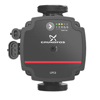

Hi, Pricey but good, I installed this one last year to replace an old noisy one. Virtually silent, sometimes worries me as I can't hear it start up!
Grundfos UPS3 15-50/65 Domestic Heating Circulator 230V | Central Heating Pumps | Screwfix.com
