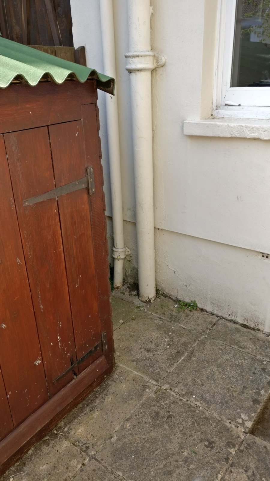

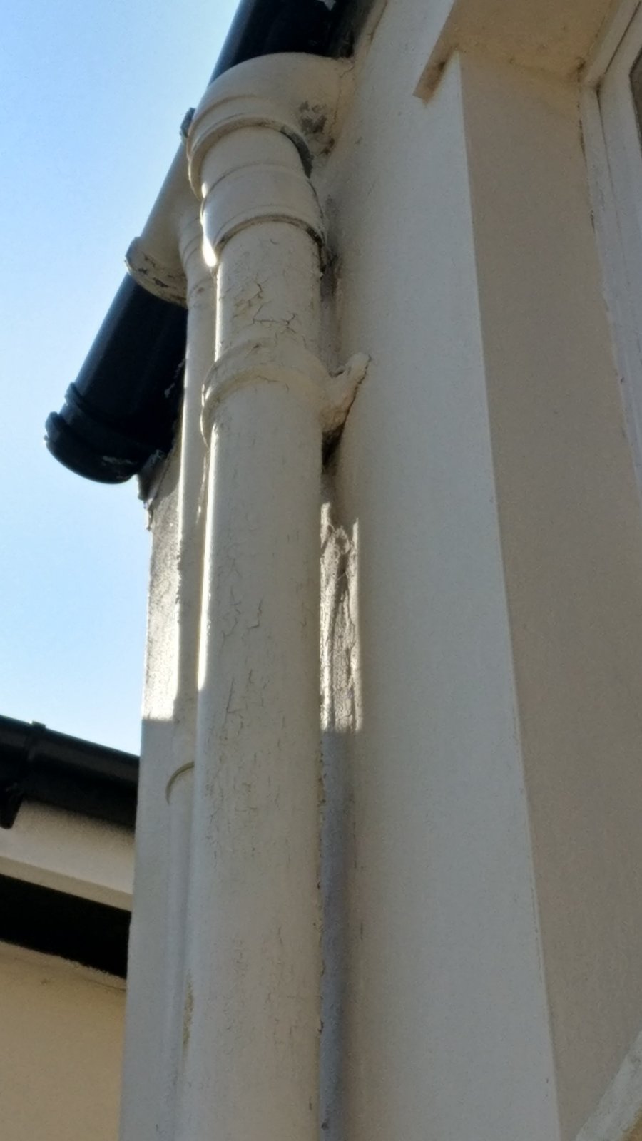

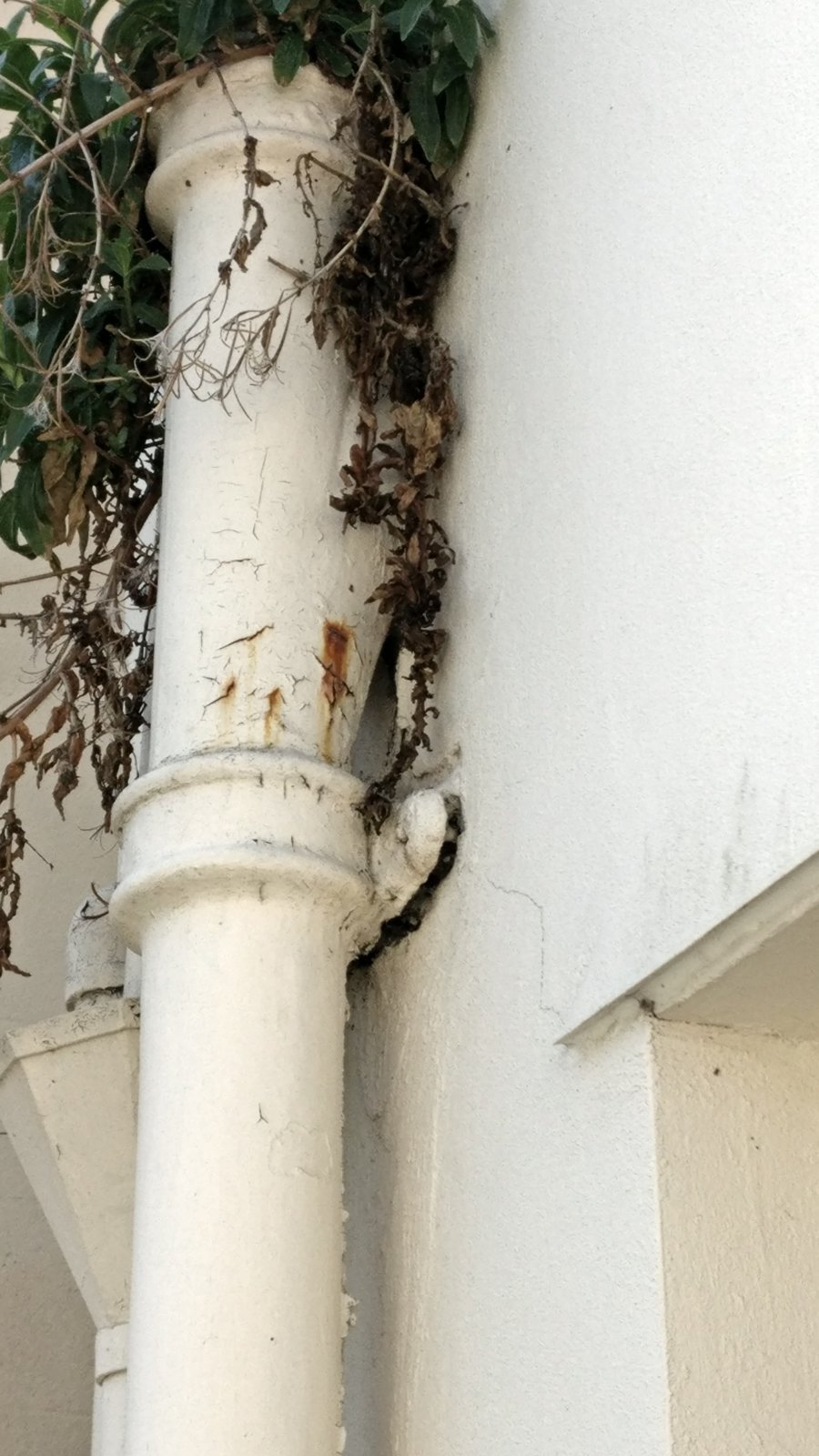

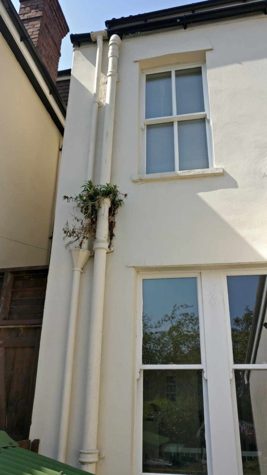

Thanks for your replies. The reason I haven't had more quotes is that it's difficult to get people to come and look at it at present. The existing stack is cast iron and I guess the branch to the first floor WC pan probably is too. The loft connection is via a timesaver coupling as I assume the ci pipe is imperial guage. I've attached a few photos for info.

dea81,
No problem at all with that location - for erecting an alloy tower to safely cut and remove the stack - short section by short section from the top.
That CI stack is rotten and great care will need to be taken in case whole sections shatter and collapse.
The first floor WC connection can wait until the stack has been dropped.
Once the external connecting bend is cut/removed the en-suite can also wait.
Where the pipe enters the ground it will have to be dug out - all the way down to the connection with what should be a slow bend.
It could be a salt glaze bend with a hub connection - the whole bend will need removing and replacing with a plastic bend.
If BCO is involved they will want to see the bend.
Dont allow the plumbers to just cut the soil pipe above ground.
