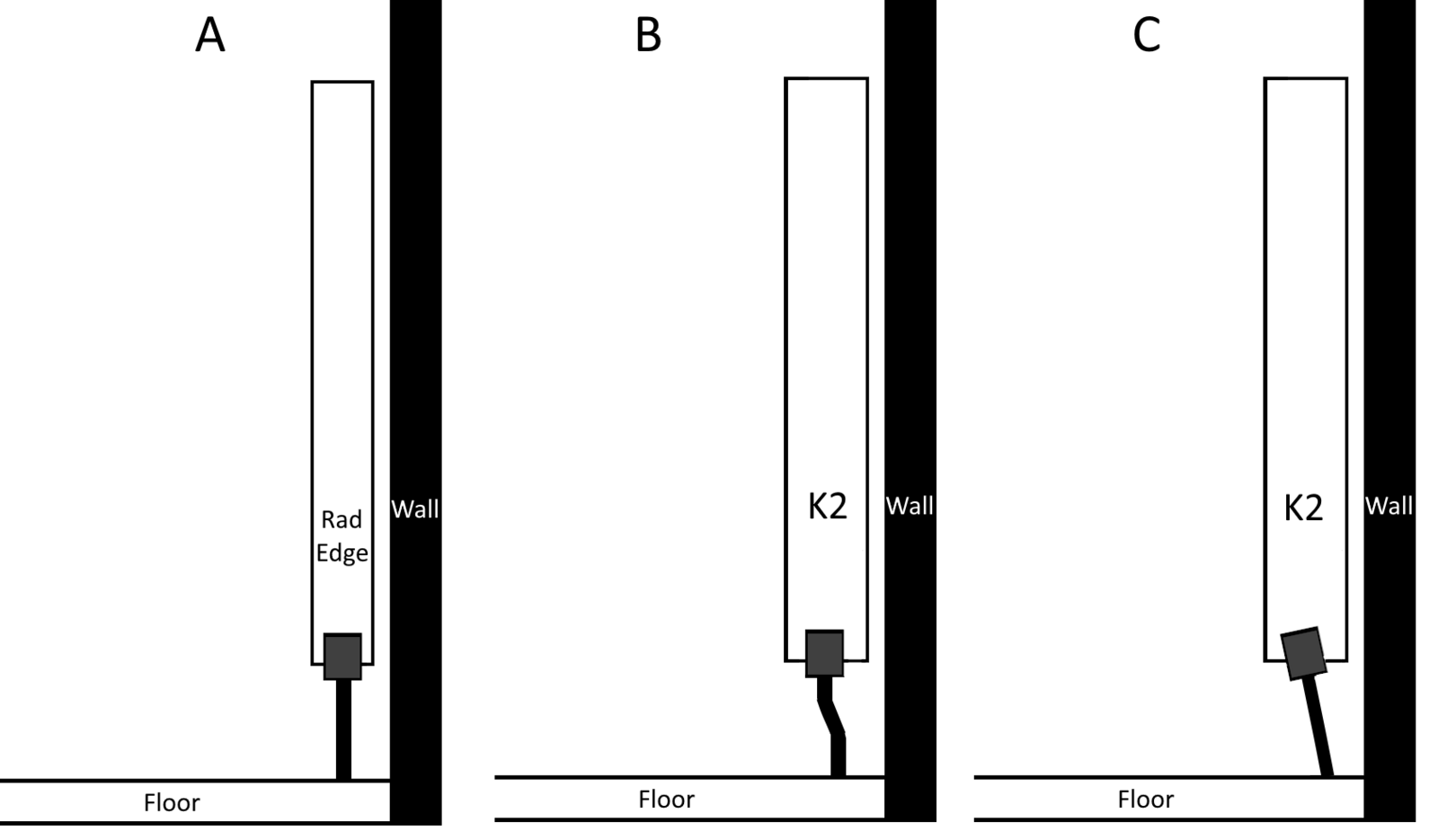

I’m replacing two slimline rads with K2s (A in the image). I’m wanting to avoid draining down if possible plus the F/R pipes are under laminate and screed. I’m opting for option B where there is room to use pipe benders.
Where using the benders and soldering is not an option would C be okay until I can rip the floor up in the next 18 months?
Alternatively, any other suggestions
