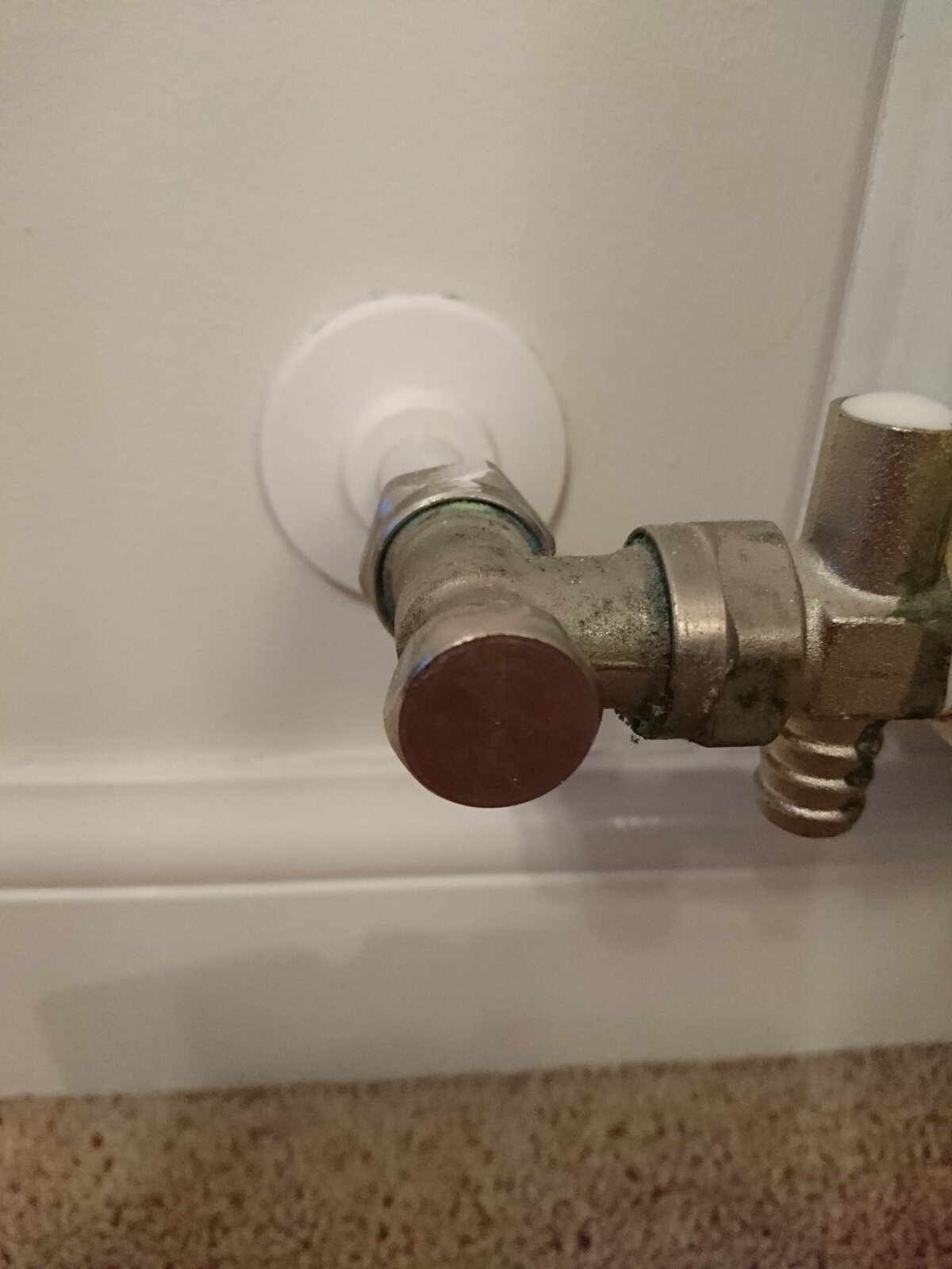

Hello All,

I have a radiator with a slightly seeping air bleed valve (sorry if my terminology is incorrect, it's one of these: https://www.amazon.co.uk/dp/B007JX6CVM/ref=cm_sw_r_cp_apa_i_Q2i.FbB2M1MZF?_encoding=UTF8&psc=1 )
It's nothing major, just want to fix before it gets worse.
I'm ok with trying to replace this myself, but want to make sure I'm prepared...
My question is... How do I turn off the radiator? On the right side is a thermostatic valve which is self explanatory. But on the other side there's just a plate with the word Danfoss on it. I can't find a tutorial with a similar setup anywhere. I've attached a photo.
Thanks for the advice.
Take off the cap and screw down the innards with an allen key or sometimes a flat screwdriver.
Ah! So it's just a cap? Sorry, never even considered that. What an idiot. Thank you!
No doubt I won't have something that fits, but at least I know to check now.
