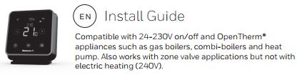

I'm currently looking to install some infrared panels in 3 rooms. Previously there has been no permanent heating in these rooms.
I'm looking to use a Honeywell T6R Smart thermostat but my question is, do I need one of these in each room connected to one of the infrared panels or can I have 1 in a central location and then a more "basic" thermostat in each of the other rooms?

As well as Infrared Heating being locaialised and not normally controlled by thermostat as explained by oilhead, the instructions for the Honeywell T6R state that it is not suitable for electric heating.
This is probably because the switching contacts are only suitable for the very small currents associated with boiler control circuits, and will not withstand the current required by an electric heater.
