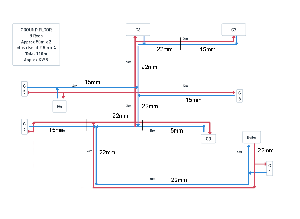

Am starting a new thread as, based on the advice I got (thank you), I need to upgrade my central heating pipework from 15mm to 22mm.
I'm hoping to find out how much of it can stay and how much of it needs changing.
In total there are 21 radiators totalling 23 Kw, across three floors including loft.

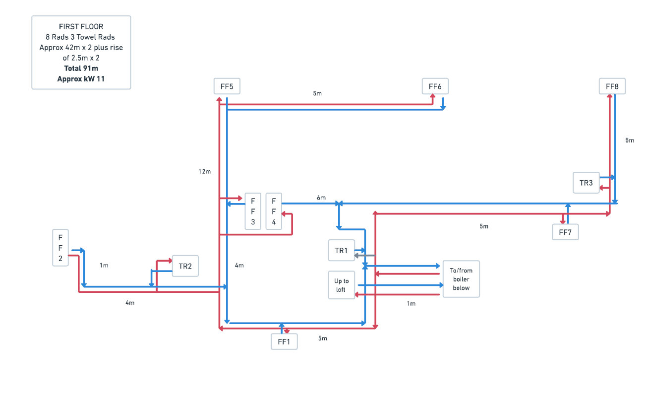

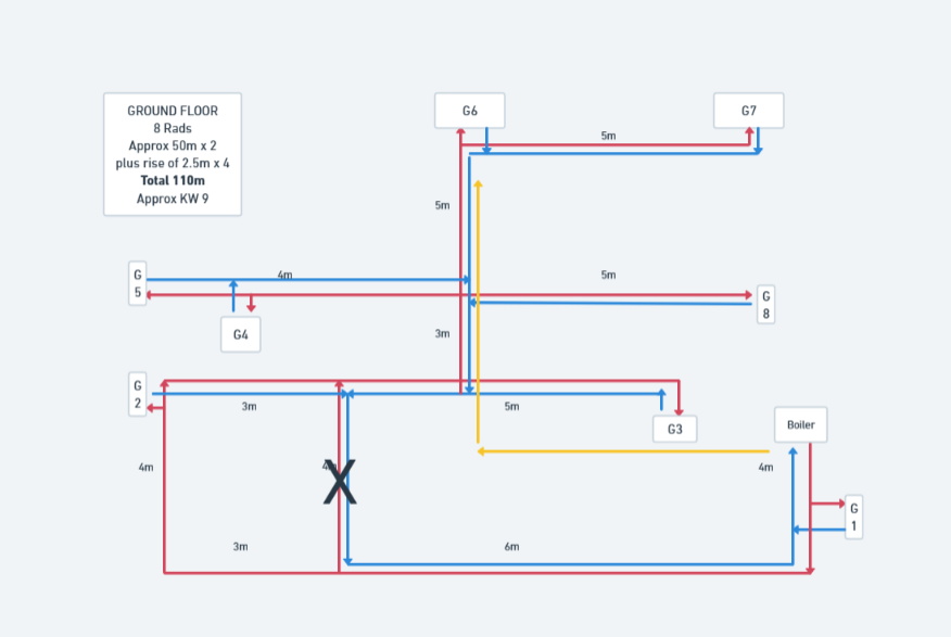

Ground floor: 8 rads 9kW (G1-8). Flow and return pipe run 110m

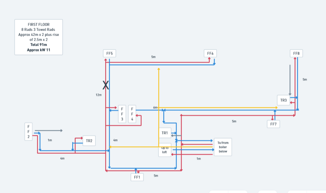

First Floor: 8 rads plus 3 towel radiators, 11kW (FF1-8 TR1-3) Flow and return pipe run 91m
Loft:

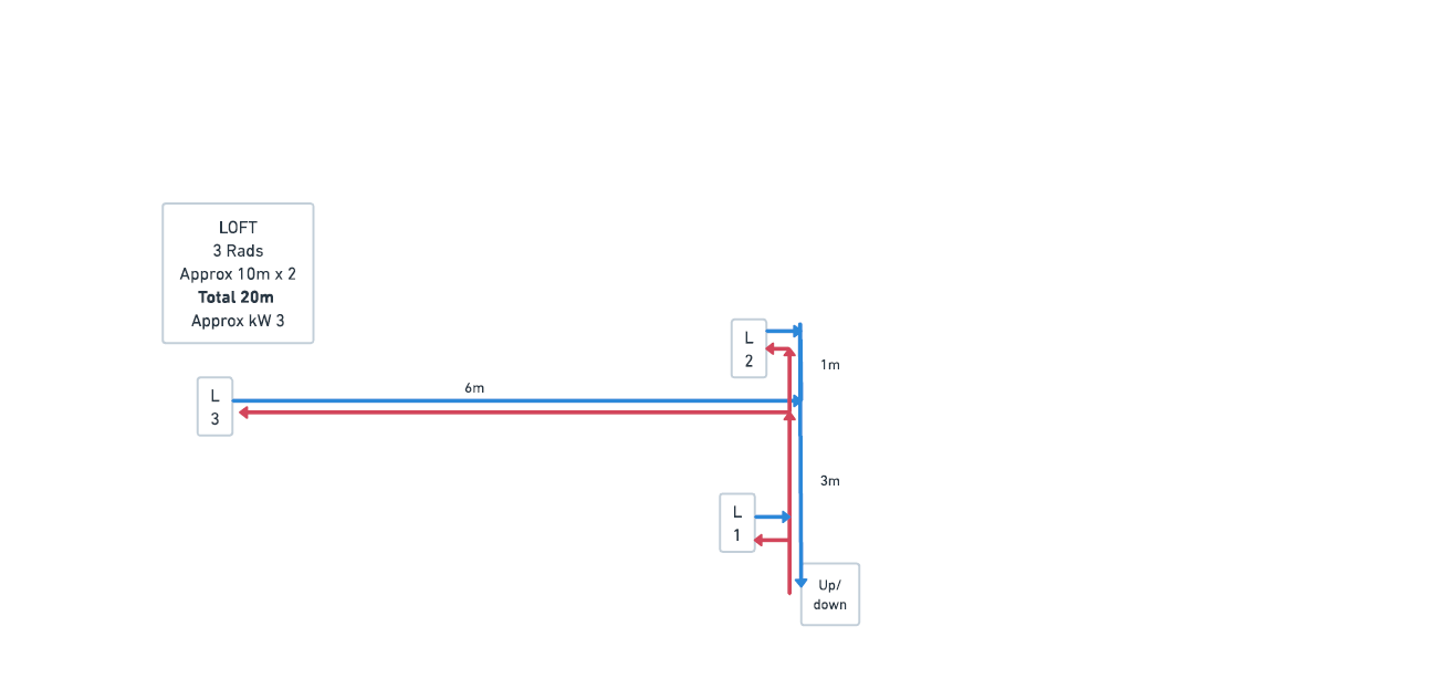

3 rads 3kW (L1-3) Flow and return pipe run 20m

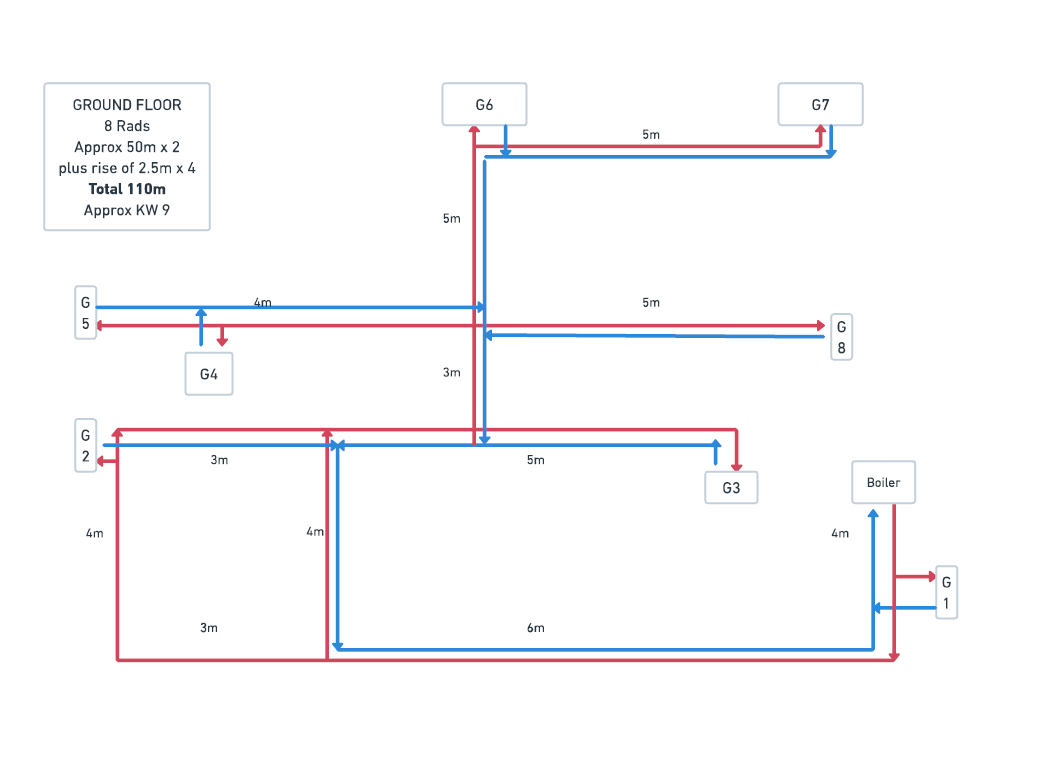

I've cobbled together a diagram which I hope helps. It's not exactly to scale so I've added approximate lengths of pipe run as an indicator .
From what I've read you need have the 'backbone' in 22mm and you don't want 15mm pipe to more than 3 radiators on any one branch, but I'm not sure how close to the radiators you need to get. For example I have a branch (First Floor FF7, FF8, TR3 - Landing, Bedroom & Towel Rad), but the distance is approx 11m - does it all need to be 22mm? It would be great if someone could highlight the areas that need to be 22mm but any advice at all would be gratefully received. Thanks!

OK - the rule of thumb is - 22mm run from top to bottom and out onto each floor and then branch out in 15mm to each rad on each floor. Try and keep the 15mm runs similar lengths, this will allow the rads to heat up at similar rates.
Ideally you would have 22mm on each floor running out to a central location and then 15mm runs, as equal length as possible, from there out to the rads. A lot of the time that's not feasible though so the 22mm may have to travel a bit and try and get the branches as centralised as possible. All else fails then as short a route to the rads as possible but do know the more uneven the lengths of the 15mm runs out to the rads are, the more balancing that needs to be performed. I would recommend no more than 2 average sized rads (600x1000 K2) from a single 15mm feed.
The ground floor flow seem to be short circuited by that 4m length running from between G1 and G2 up to the length between G2 and G3? The 3m>4m length between G1 and G2 would probably be removed
Funny you should say that- it's the only run of pipe that's in 22mm!

Grnd floor - a 22mm spine right up the middle with 15mm supplies out to the rads - just because they are 5m doesn't matter, it's the similarity of the lengths that would matter, even then a m or 2 out towards the rads will help massively but not needed right out to the rads

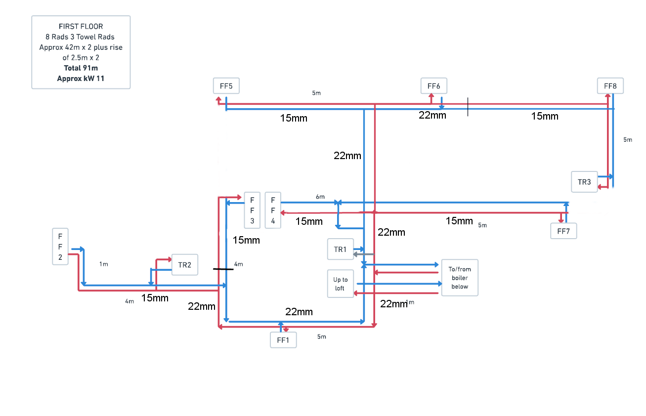

First floor - same again - extend the run on TR1 up to the run on FF5/FF6, 15mm left to FF5 and elbow 22mm out to FF6 then drop to 15mm to FF8 and TR3 - also take the 22mm out left towards TR2. FF2&3 off that 22mm and then drop to 15mm to feed TR2 and FF2
Loft is easy - 22mm up to L2 and elbow left towards L3 then drop to 15mm
There may also be a case to add a supplementary pump, depending on available head and overall height.

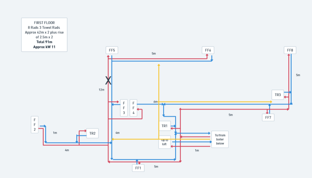

Thank you Madrab, I mistakenly thought that if there was a radiator within 12inches of a 22mm pipe then all rads needed to be within 12 inches. If I'm now understanding it correctly, if I at least get 22m whereby there's a similar run of 15mm to the furthest of a 'family' of rads, even if it's 5m, then it will help things massively.
Taking that on board, and mindful of where I can and can't access, I've modified it slightly. For example, FF8 is the extension area with chipboard flooring and the joists running the opposite way so it would be difficult to join that to FF6.

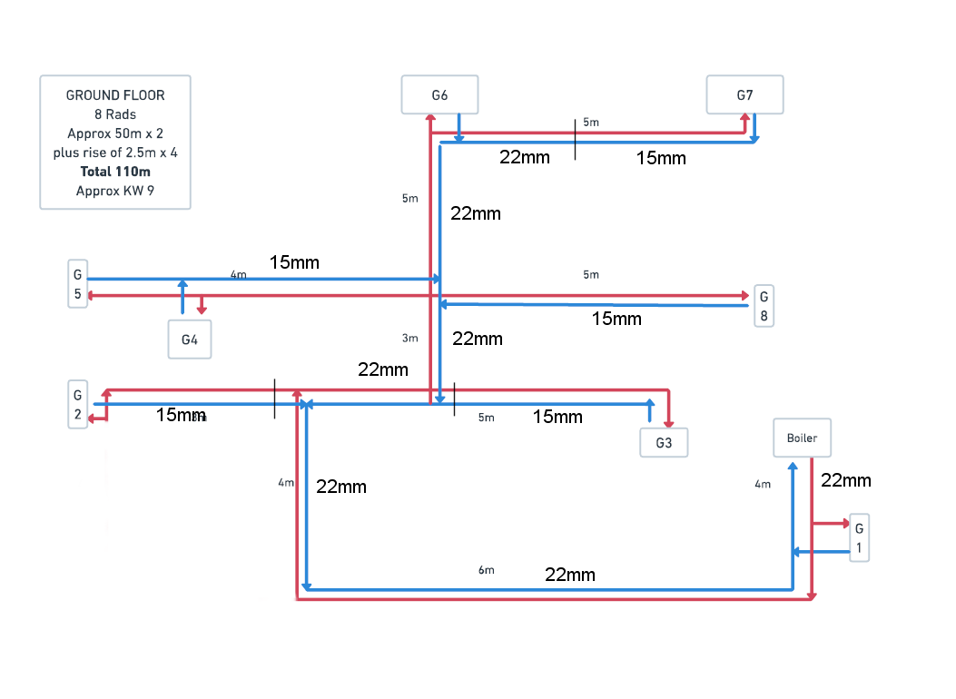

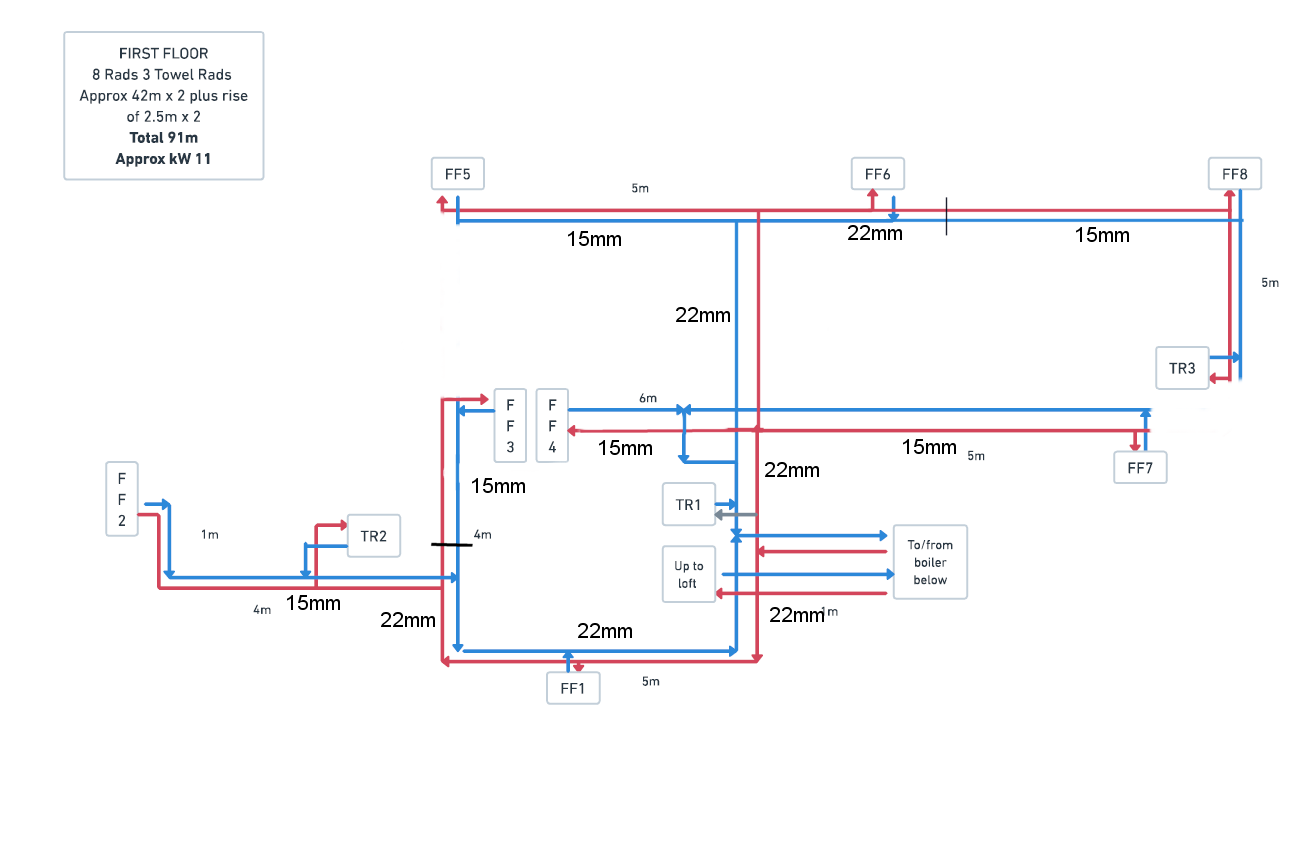

You've already been very helpful and I don't want to hog your time, but would you mind casting your eye over it to see if it's adequate? I've marked the 22mm in yellow. Either way, thank you very much.
First Floor

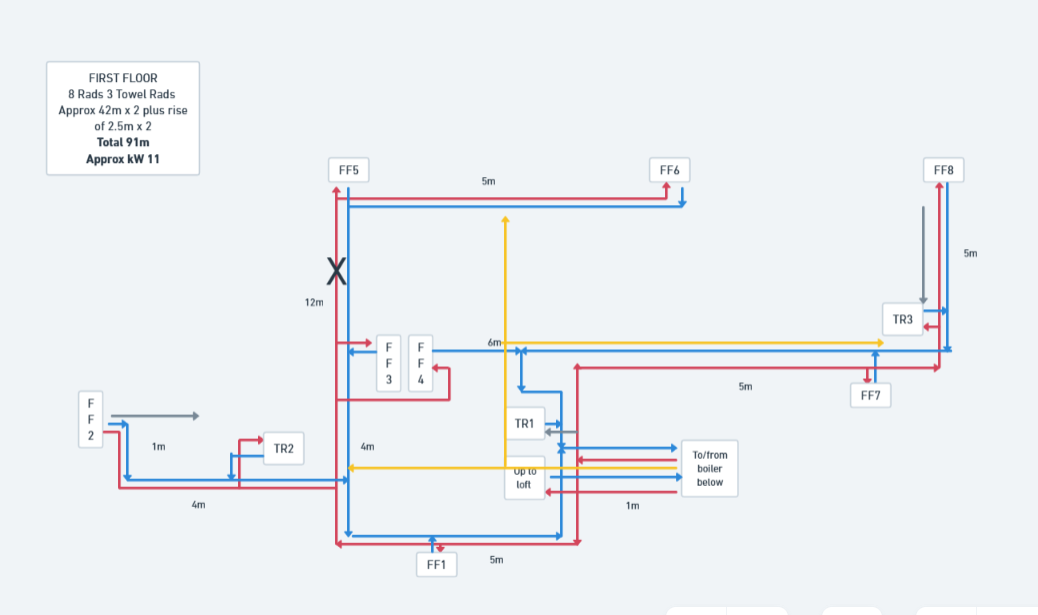

More like this I would think to even it all up. Then 22mm up and out into the loft. If the loft is struggling to heat up then a supplementary pump may be solution to overcome the height

Madrab - Thank you very much for taking the time to update the diagram, I am very grateful.
I have one radiator (G2) which is 7000 BTU/2kW. G6 and G7 are both in the region of 5000BTU/1.5kW so together are 10000 BTU/3kW so I presume that would be inadequate if it was 15mm but okay if upgraded to 22mm.
None of it will be easy but the most challenging would be putting a run between FF6 and FF8 (because of a brick cavity wall, chipboard flooring and the joists going in the opposite direction). Far easier would be to upgrade the existing run between FF7 and FF8, where the joists are in its favour, would that work?
Not inadequate per sé but ideally 22mm up to G6. The best practice for any central heating system is to minimise imbalances and maximise flow, especially when the run length become longer. The ideal is to have a 22mm backbone to a central location on any given floor and then all the 15mm feeds are as close to the same lengths as possible. This allows the system to balance itself and allows the radiators to warm up at similar times.

If FF7 and FF8 is easier then run 22mm out to FF7 then just after that drop to 15mm for TR3 and FF8, keep FF5 the same and run a 15mm feed to FF6 off the 22mm
