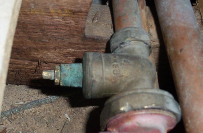

Th pump is a Grundfoss or something like that. I think the guy who fitted it said there were 3 settings and he had it on the 2nd position (middle).
There is also an odd looking valive on the boiler side of the pump which this guy did twiddle with on a return visit - can't remember what he was clled back for now. Ill try and photograph it tomorrow and post the picture here
OK so I took a couple of photos of the pump and the weird looking little valve(?) next to it. Most pumps I've seen have very simple in-line isolating valves like those you'd fit on the pipe leading to taps etc, I've not seen one of these before. The boiler position relative to this photo is on this 'valve' side of the pump about 2ft further along and then a 2 ft drop down into the kitchen.
