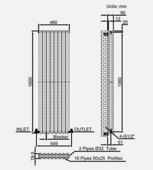

Yes they are crap at giving out heat I agree with you on that!
