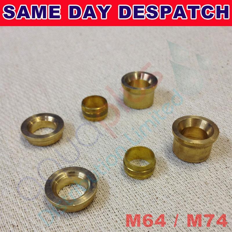

Ive been told about olives and bought a standard one which doesnt seem to make any diffrence being to big for the radiator.
The first picture has an olive similar to the one which sits on my pipe when being inserted into the radiator. the bottom left.
Im not sure if its meant to sit on the pipe or be fed through the pipe.
The pipe has zero grip on the olive.
What you show us there is a reducing set - the sort of thing that allows you to fix 10mm pipe into a 15mm valve and so on.
The other pic in your profile is how to fix plastic pipe to standard copper pipe, using an insert within the plastic and the traditional olive fixing.
Give us a pic of your actual installation, if you will, with the pipe sizes.
