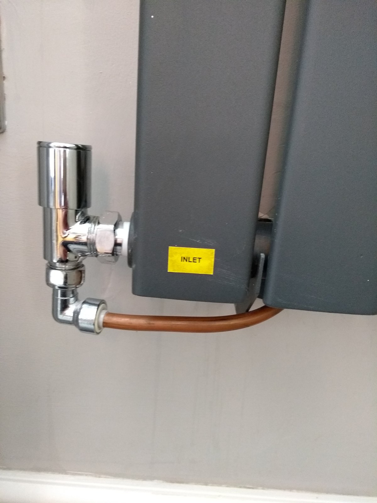

I have 2 tower radiators in the living room, 1 is boiling, the other rarely gets luke warm. I have drained it and refilled it, bled the whole system, yet it still fails to heat. The inlet pipe us really hot, yet the return pipe is cool. I have turned all rads off in house, including both valves, to try and force the water through and that does help a little as the rad gets hot, but as soon as I open up the rest of the rads the tower 1 goes back to being useless. Any advice greatly appreciated as the missus wants the xmas tree in the living room so will have to turn the hot 1 off!! Thank you
If you turned both valve off on all radiators, the system will no longer be balanced - if it was already balanced - so you wil have to rebalance the system. This ensures that each rad gets its fair share of the heat being circulated.
Some tower rads have a baffle fitted and can only be installed one way round, the two pipes from the rad are flow and return, the flow is the hottest,if both rads are the same make, feel the one that is working and find out which side is the flow, then feel the other and see if the flow and return are the same way round
Thank you. I will try and balance them, they have been like this since I moved in. The rad has a sticker reading inlet on the left hand side, which is also the side where the hottest pipe is, so can I assume it's fitted correctly? Thank you for taking the time to help.
