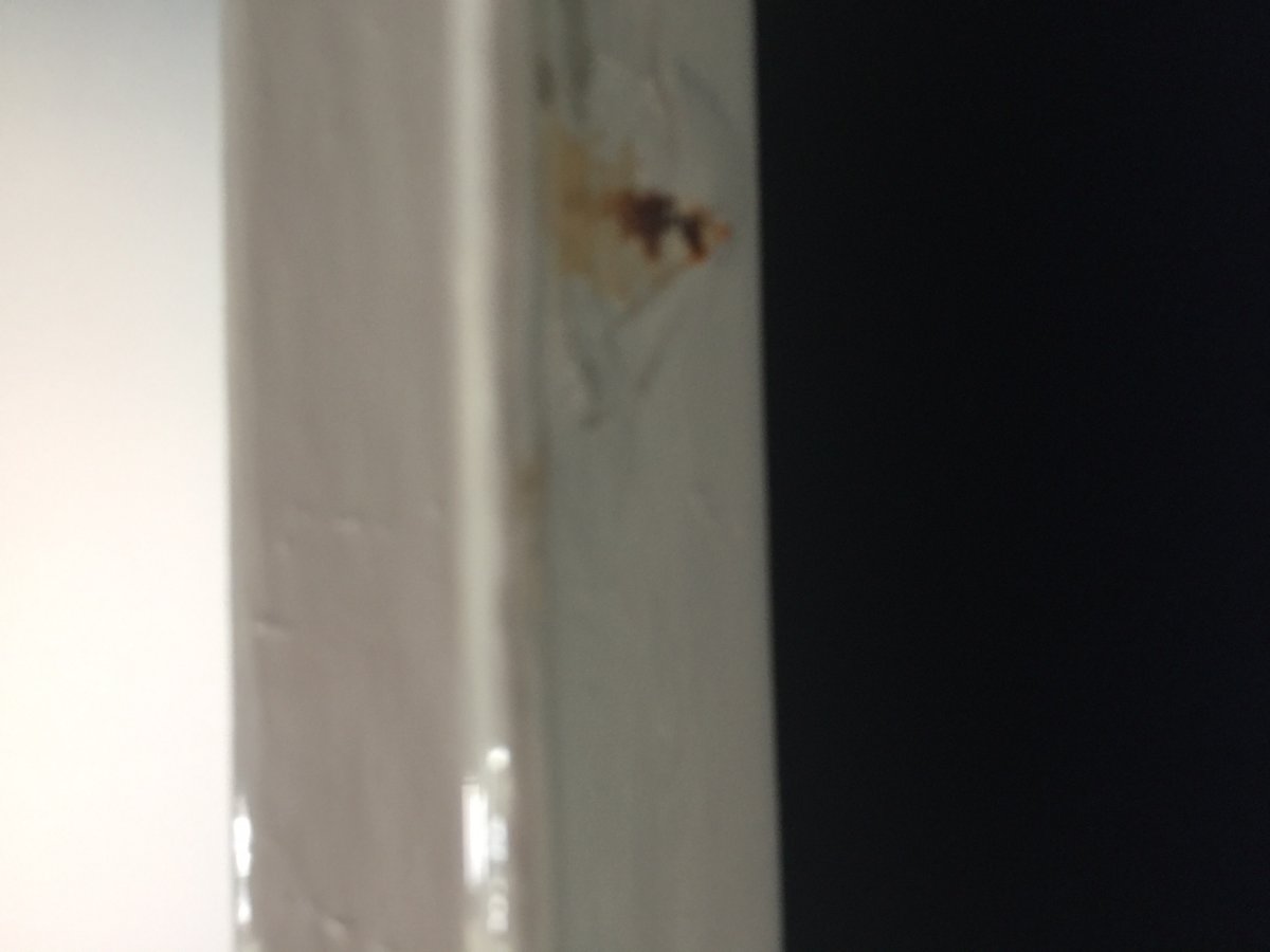

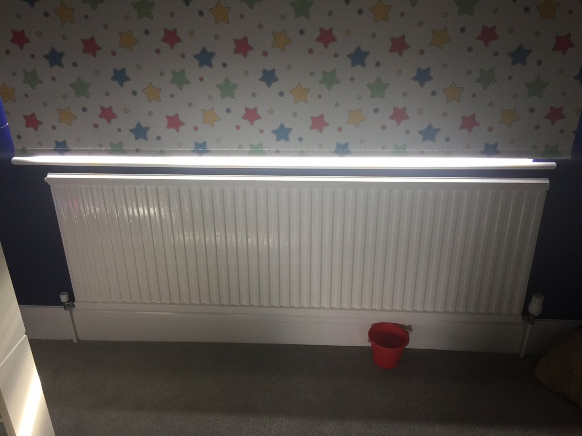

Hi all,
I recently moved a radiator that had been in the kitchen for years, to a new bedroom. The radiator matches all the other radiators upstairs.
It seems that whilst the radiator has been stored that it has got damaged on the bottom or it has a corrosion issue, as I now have a tiny leak right at the bottom of the radiator. This is on the underside of the radiator on the wall facing section. See the picture - the leak is where the bucket is positioned.
Now I've read the advise and I know that the best solution would be to replace it from a long term perspective, but I'm loathed to do that initially as it matches the rest of the radiators upstairs and I need to focus on other jobs.
What I'm considering is seeing if a product such as the below will fix the issue?
http://www.screwfix.com/p/no-nonsense-central-heating-leak-sealer-concentrate-310ml/90485
http://www.screwfix.com/p/no-nonsense-central-heating-leak-sealer-500ml/88705
Any other advice on an attempted fix would be very much appreciated.
Jon
I have successfully used araldite to cover a pin hole.
But that is only possible on a flat section as I use a small coin to add strength. But that's after grinding down to the bare metal.
Usually araldite on its own does not work well.
I don't know about the products above because the commercial solution is to replace the radiator.
You should consider the water treatment aspects as that may have been the cause of your leak.
Tony
