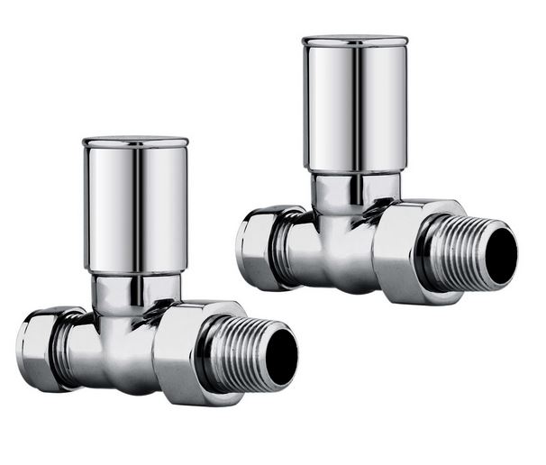

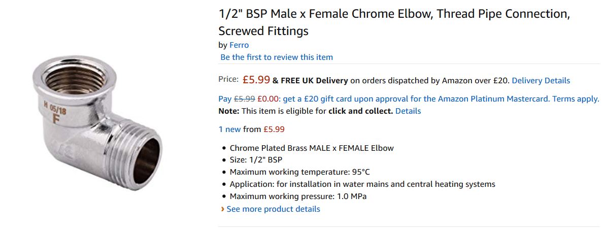

I'm fitting a vertical radiator within a shallow alcove with minimum clearances left and right. The radiator will not fit if I fit both tails and valves.
Is it possible to fit valves directly to the rad without the tails?
I'll be looking for suitable valves with vertical 10mm feed/return.
Cheers all.
PS - Its a designer rad so a narrower rad is not an option :(
Nope, ideally you need a rad tail to provide a metric pipe stub or a male flange and nut for the valve and it's compression/female flange end to fit to.
Would a male ended valve fitted into the tapping of the rad work, who knows, never tried. Certainly not ideal, different threads etc.
You do get vertical rads with top/bottom and centre tappings these days.
2 of these,
and,

Thanks Foxhole - The elbow fixing suggested previously is my solution as I didn't know they existed. The flexible hoses was just an ignorant query as I have them already as left overs from a previous DIY job.
