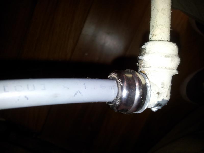

My mission for today is to get a downstairs rad working - it currently has no flow (taken pipe off the TRV so not the TRV) so guess the pipe is blocked.
This rad is piped with 10mm plastic pipe, each pipe is about 4.5m long going up the wall into the bedroom above and is tee'd into the rad there (which is all in 10mm copper). I am assuming the long run to the rad downstairs gives little flow and therefore the pipe has got blocked. Dont know why but feels like plastic will clog easier than copper??
Anyway, I can see the 10mm copper upstairs disappear way under the floor so not sure where it connects to anything bigger. Is it a reasonable idea to change the 10mm Tees to 10-15-10 (if such a thing exists!) and run down to the problem rad all in 15mm copper? I assume copper is a better bet than plastic?

ok, I have got the pipe open at both ends and found the blockage somewhere in that 4.5m of plastic. Ill try and find something to poke down it.

Got some washing line through the top end of the pipe, need to have a go at the other end but there is a stubborn push fit elbow - any idea how to get this off?
Maybe better to cut higher up the pipe and rejoin...
You need a special tool to remove this. Cut it off and replace, you never know this might be where it's blocked ;)
I cut it about 1 metre above this elbow and all the stored water above it came sraying out :D It was either the elbow itself or just before the elbow where the blockage was - now clear.
