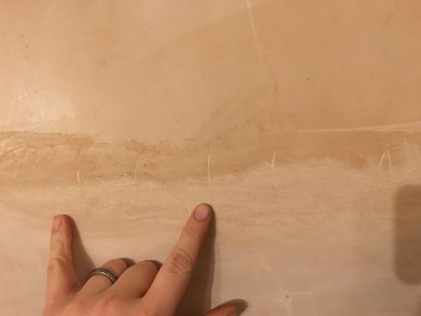

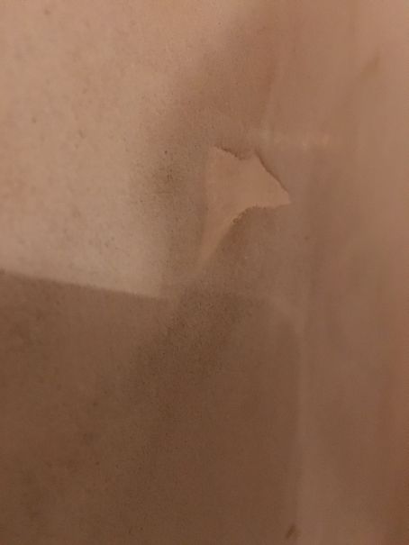

Scratches on New & Old Plaster:
I don't know how it's happened but it's happened - there's scratches appeared on the plaster where it's been blended in.
If they'll all paint out & be hidden then i don't really mind but if they're going to show through paint then it's obviously a problem.
These are close up photos. I can get shots at distance if required.
Q1) Will these lightly sand out?
Q2) Would you expect any of this to show through paintwork as it currently stands?
This just looks like a different colour plaster but when you feel it it dips a bit

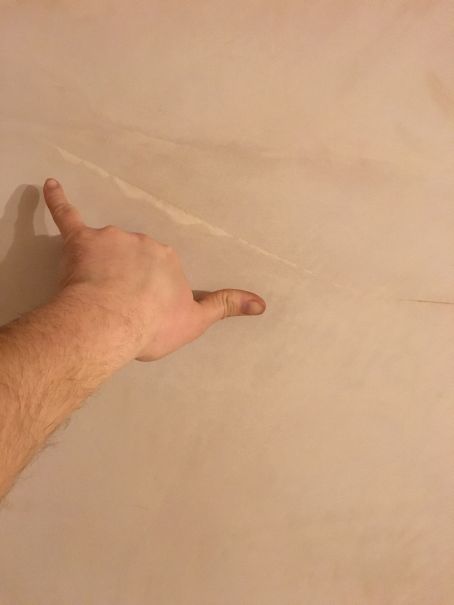

This is it whilst standing against the opposite wall...
There's a smaller one on the other wall...

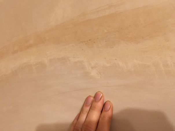

Then there's the scratches around where it's been blended in...

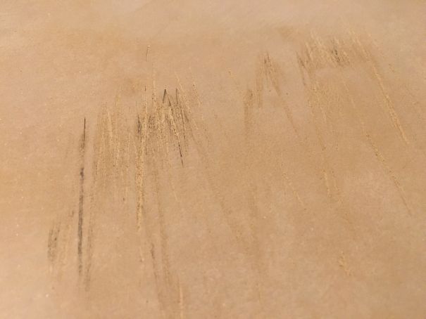

They just look like lines in the photo but they're actually grooves...

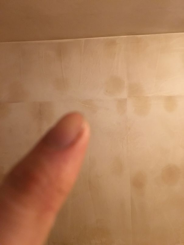

Dot & Dab:
I appreciate the dabs will take longer to dry out than the rest of the plaster on that wall. I just ask how much longer? (approx of course).
I was also told (not by those who did the work) that when it gets cold, even when they have dried out, that the circles can re-appear. Is this correct?
With everywhere these days having plasterboarded walls & so many with the dot&dab method, surely there isn't 1000s & 1000s of people up & down the land with circle patches all over their walls?
The circles could come back they can come back as cold spots or damp spots, that's a bad job you have there all the scratches and dips should be filled with easifill once mist coated also that's a bad dot and dab job you have you shouldn't see the joints of the plasterboard grinning through like that ,also because u can see the joints you can see they haven't staggard the boards you have a joint go all the way across the wall and I'm wondering if those boards are level because of the joints

Mist coat, then snag then another mist coat then top coat if your boards are not straight no amount of paint will make it look right are there any deviations on the boards? At the joints? Give them a feel and run a straight edge over the wall on the joints fwiw go to my profile albums you can see a 100m2 ceiling I done at SFC training ground in step by step detail with no joints showing through anywhere, where the boarders had done their job properly and I followed suit by covering the scrim then 2 good coats , was the boards that were dot and dabbed tapered? By the looks of it they wasent, sure your paint will cover joints but if boards are not straight it will look awful, also its not wise to have one joint go all they way across the wall

Well best you can do is mist coat the walls this will highlight the areas to be snagged also it seals the wall at the same time, get some fine grit and rub down the easifill then give a second mist coat which will seal the easifill then top coat job done tbh I wouldent be happy if that was my wall
