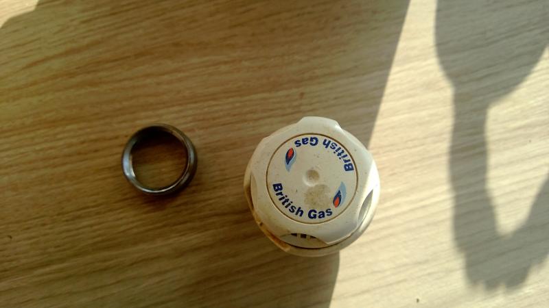

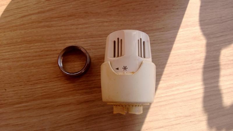

hi there yesterday while moving a chair I broke the plastic top of a thermostat which is on it says it was britas gas one can you buy replacement tops tia
http://media.dhttp://media.diynot.com/171000_170945_63761_32304825_thumb.jpgiynot.com/171000_170945_63762_63736264_thumb.jpgthere is only this one in the house put in about 5 years ago but not from BG
http://media.diynot.com/171000_170945_63767_29651519_thumb.jpgAre there any markings on the valve body?
I'm fairly sure they are re-badged Drayton:
http://www.draytoncontrols.co.uk/RT414ThermostaticRadiatorValve.aspx
(don't take my word for it though - just a DIYer)
It is a Drayton body. The head-thread is fairly standard M30 thread.
Most makes of head will fit. The main exception being Danfoss.
