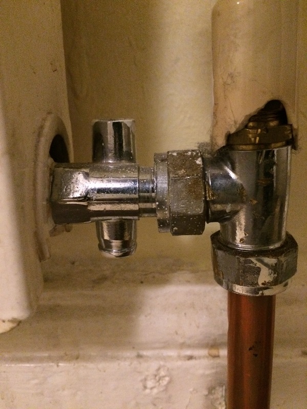

Hi,
Can anyone tell me what the following radiator valve fitting is?
It's located between the radiator and the lock shield valve - it seems to have a screw in the top but I've no idea what it's for as I've never seen one before.
Any ideas?
Thanks :)
Looks like a drain off tail for the radiator itself, so you can attach a house to the bottom, and open the valve on the top.
To the left is a drain off fitting.These can be fitted as an option to the standard radiator nut/connection.
Why do you ask ? some numpty has damaged the plastic top cover and started to paint the chrome lockshield valve.
If you want to replace the damaged plastic top cover,you can but the manufacture name is stamped around the top screw (thou it looks like a pegler terrier product).

I did suspect it was something like that but assumed it wasn’t as it doesn’t look like there’s much to attach a hose to. I wouldn’t like to drain more than the one radiator with it.
Unfortunately, it’s an upstairs radiator and there doesn’t seem to be any drain-off for any of the downstairs radiators. Two were removed at some point so I’m guessing one of them may have originally had a drain-off.
I need to drain the system due to an issue with a towel radiator valve so I’ll fit a proper drain-off then.

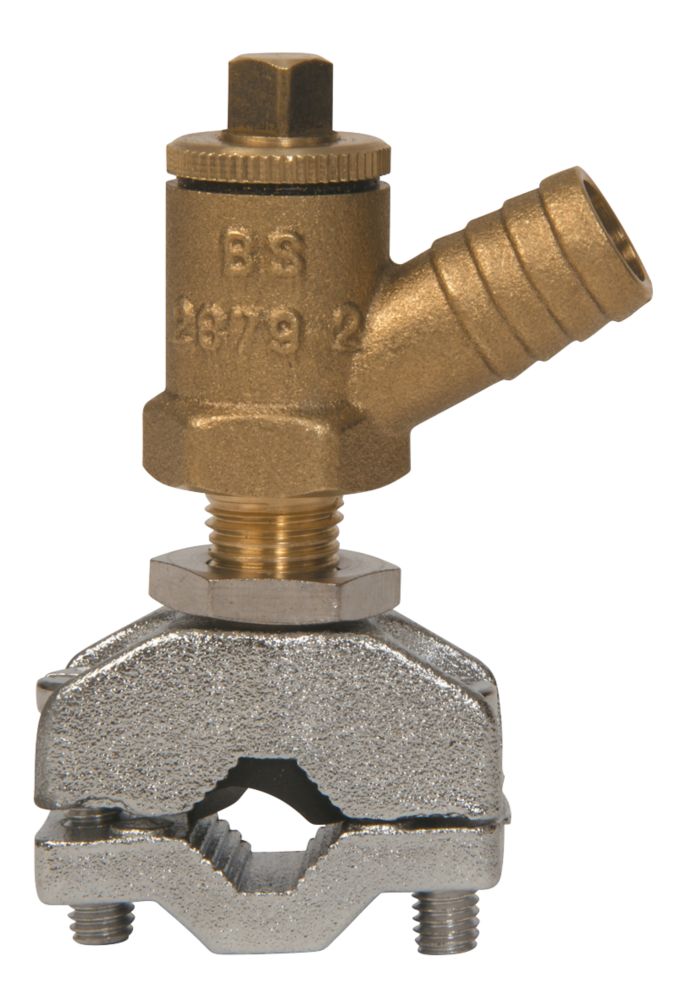

You can get self tapping drain off cocks. Just screw into the pipe then drain and it seals reasonably well round the pipe.
Theoretically you can leave them when you refill, but I just cut out that part of the pipe and fitted a normal drain off afterwards.
Thanks - I've bought one of those and there's a YouTube video of a guy demonstrating how to use one. It's a bit ugly though so I agree that replacing it with something a bit nicer is the way to go.
