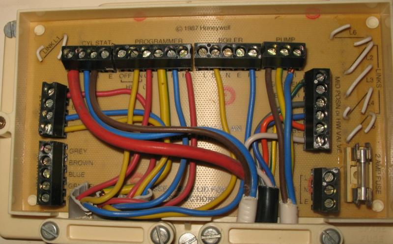

I had a bit of a further fiddle about and I'm confused. The guy who fitted the boiler came to look, told me the electrics were wired fine and it was the mid position valve that needed replacing.
However after a bit of researching I decided to check the valve was getting the correct signals. See photo below of my setup. First I checked the valve and it was working ok for the HW (live on orange, 0V on grey and white), but then it didn't seem to respond to any CH demand. The white wire was always at 0V with all combinations of room stat and programmer settings. This seems wrong?
Next I checked the programmer terminals, the one labelled HW ON switched between 0V and live with the programmer setting, but the CH ON one just stays at 0V no matter what I select on the programmer.
Does this mean the wiring is wrong somehow, or could a faulty valve cause this behaviour (by pulling the white wire to 0V somehow)? I don't want to try and argue against what the installer said without some confirmation or some other things to try.
The programmer doesn't allow the CH to be on without the HW, and the grey wire to the mid-pos valve is live when the cylinder stat is satisfied (assuming HW is on at the programmer), so I think this is ok?
Tonight I'm going to connect the white and grey from the valve to live and check it works as expected. If this is ok then I suspect the wiring under the boiler is incorrect somehow (the programmer is next to the boiler and all the wires go into a junction box).

I just wired up grey+white to live and it seemed to work as expected (boiler fired up and only CH side of the valve got hot). This seems like there is a wiring error downstairs, no?

Yes!
There should be a wire from terminal 1 of the RWB9 to Programmer HW OFF in the Wiring Centre.
Seems like I fixed it, when I looked in the junction box under the boiler there was a loose wire that had obviously come out of the connector block. When I traced it back it indeed came from the CH-ON terminal at the programmer. Connected it back up and works a treat. I guess when the installer pushed the junction box back up under the boiler it came out... :rolleyes:
