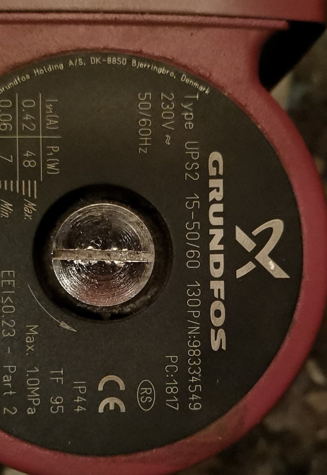

What is the PC number? (on the right.)
You say it is lying on the ground; but is it sticking up in the air with the data label at the top? A more general pic, so we can get our bearings, would help.
Hi have attached a clearer picture and the PC number is 1817, it is flat on the ground with label at top as shown.

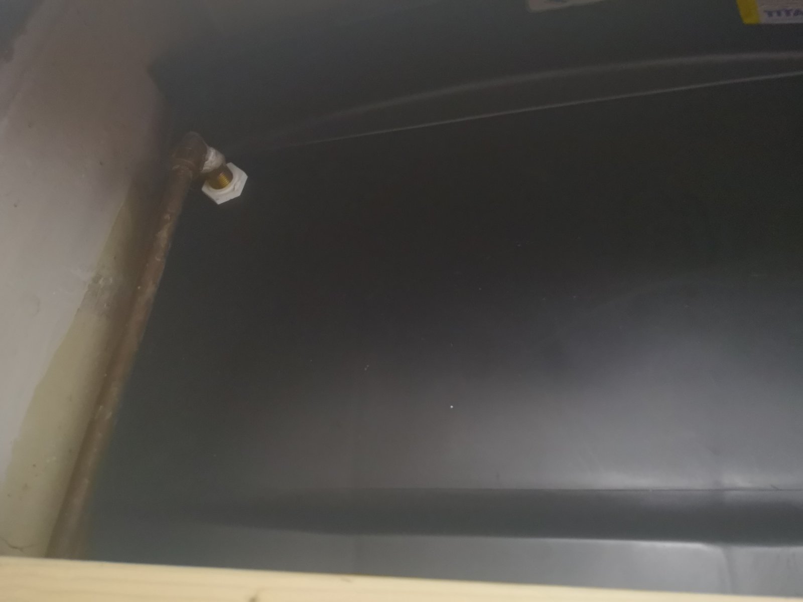

I can't see any feed/expansion pipes coming off the primary circuit to the cylinder. Is your "expansion tank" a cold water storage cistern with one vent over it from the top of the cylinder ? Meaning you have a primatic cylinder.
Hi yes that is exactly how the black plastic tank is, have attached image.
1817 means it was made in 2018 week 17. It looks as if it's lying on a floor board, with the body sticking up. If so this is all wrong as the shaft is vertical: it must be horizontal. Was the previous pump installed the same way, and had it failed? It needs to be rotated so the connection box is on the top; this may mean cutting away some of the floorboard.
