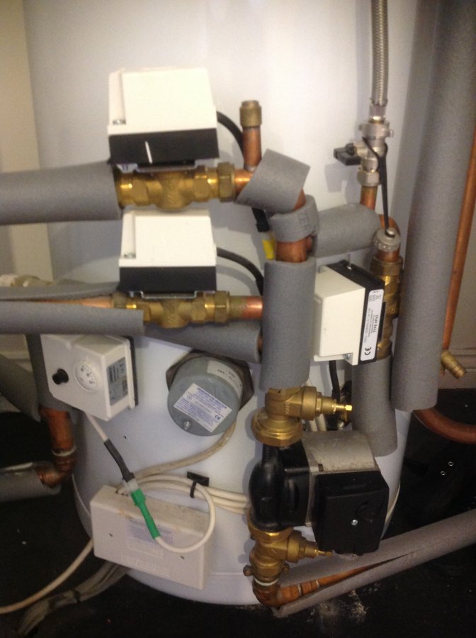

Hi, thanks for the reply. I've taken a couple of photos.

Thanks for the pics (saves 1000 words!).
I see three motorized valves (black and white boxes), which means you have one HW zone (pic 2, right valve) and two heating zones (pic 2, the two valves one above the other). The valves have a microswitch which turns the boiler on when the valve opens. The switch has probably stuck closed so the boiler lights even if the valve is closed.
Do you have a multimeter (and know how to use it)?
I would suggest one of the valves is stuck open. If it was just the microswitch staying on the rads wouldn't be hot as the valves would be shut, preventing unwanted circulation.
Do you have another room stat and are all the rads staying on?
Hi, thanks for the reply. no I dont have another room stat.....
What about the rads, do they all stay hot?
Are both the pipes, to left of the valves, hot or just one or even neither?
Mr Moashie: An answer to the second question would be helpful.
You said that the living room was 28C when it should have been 20C, but you didn't say what the bedroom temperatures were like. Were they also much higher than expected?
