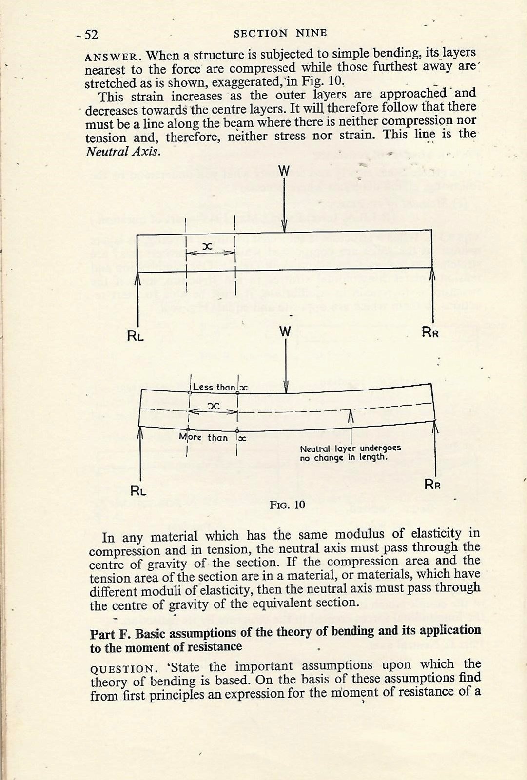

Excuse me, how can that happen? The rafter can't get longer to push the wall out. o_O
If anything it will pull the wall inwards, as the end points of a line that bends get closer together not further apart - but we are only talking about nanometres
Excuse me, it can and does get longer on the underside. This is of course more pronounced in timber than in - say - steel or concrete, which have much higher modulii of elasticity than timber.
It's just basic beam theory: when loaded, the beam deflects downwards, so the top shortens very slightly, and the bottom elongates slightly, while the centre of the depth of the beam - the 'neutral axis' - stays the same. See the lower diagram in the attached pic.
This is the reason that raised tie roof trusses are usually fixed to the wall plate with two-part glide shoes; the rafter chord is only nailed firmly once the roof is loaded with tiles and the bend in the rafter has occurred.
