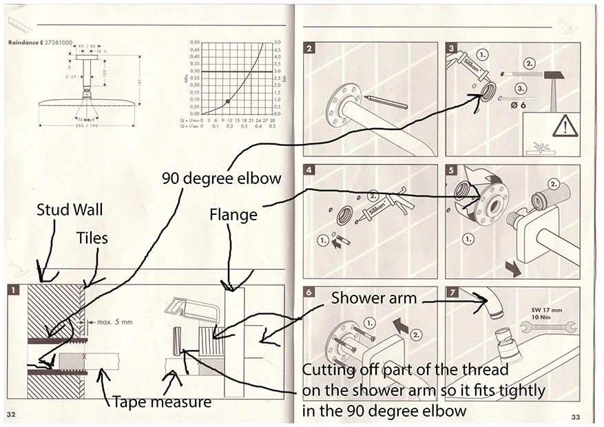

These are the instructions, annotated with what I think it means:

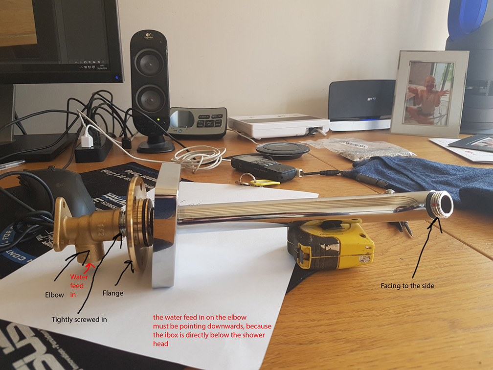

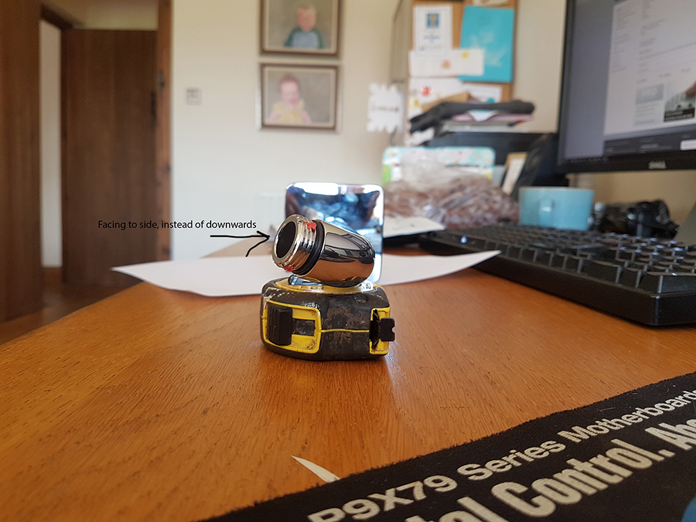

1: When the shower arm is fully screwed into the 90 degree elbow, with the water feed hole on that elbow facing downwards (my ibox, i.e. valve that mixes the water supply, is fitted directly below where the showerhead will go), the end of the shower arm that the shower head will attached to does not point downwards, it points off to the left and slightly upwards. I could correct this by simply not fully tightening the shower arm into the elbow, but presume that would result in leakage? But maybe this is irrelevant (see issue 2)

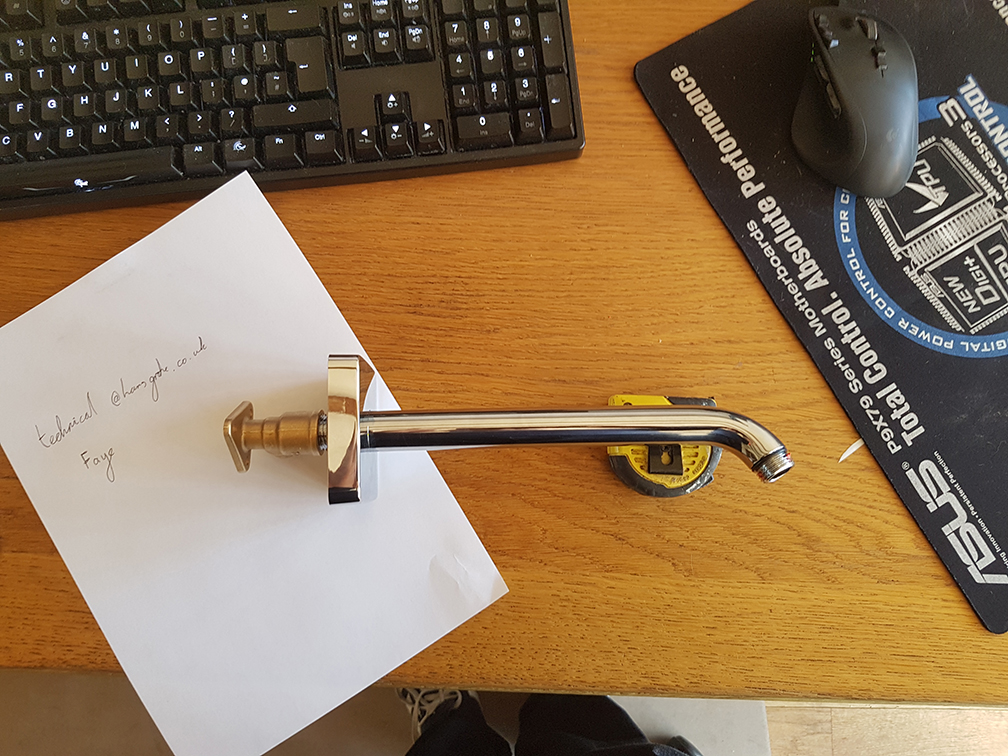

2. The way I am reading the instructions, they are advising me to fit the 90 degree elbow so the 1/2 inch threaded hole in it fits flush (+5mm max tolerance) with the face of the tiles on the wall. If I understand rightly, it is then telling me to measure the depth of the threaded section inside the elbow, then saw off part of the corresponding threaded section on the shower arm so that the shower arm will screw into the elbow as a perfect fit. My concern here is twofold: 1) that I am misinterpreting the instructions; and 2) if I am interpreting the instructions right, take the measurements of my elbow and saw off a section of the threaded end of the shower arm, once screwed into the 90 degree elbow, will the other end of the shower arm that the shower head is attached to actually be pointing downwards.
For info, Hansgrohe technical support said I don't need to saw anything, but then why is there a picture of a saw in the instructions?
