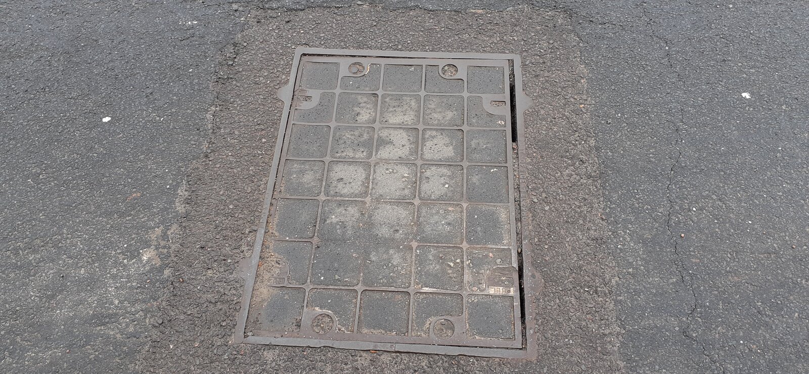

Having found the address on Google Maps, there is clear evidence of a sewer having been laid/relaid, coming out the bottom of Joiners Lane, crossing the central area of the roundabout before heading to a Manhole in the verge on the opposite side of Gravel Hill, which doesn't seem to correspond to anything on your map. Any surface water sewer would likely discharge into the nearby watercourse, any evidence of an outfall?

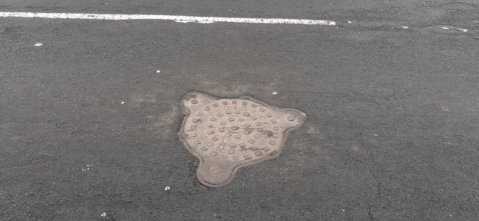

If separate systems, (i.e. storm and foul), then I would expect to see 2 sets of manhole covers, possibly of different types/shapes, which there seems to be. A 'Teddy Bear' cover in the middle of Gravel Hill, and a standard rectangular cover in the verge.

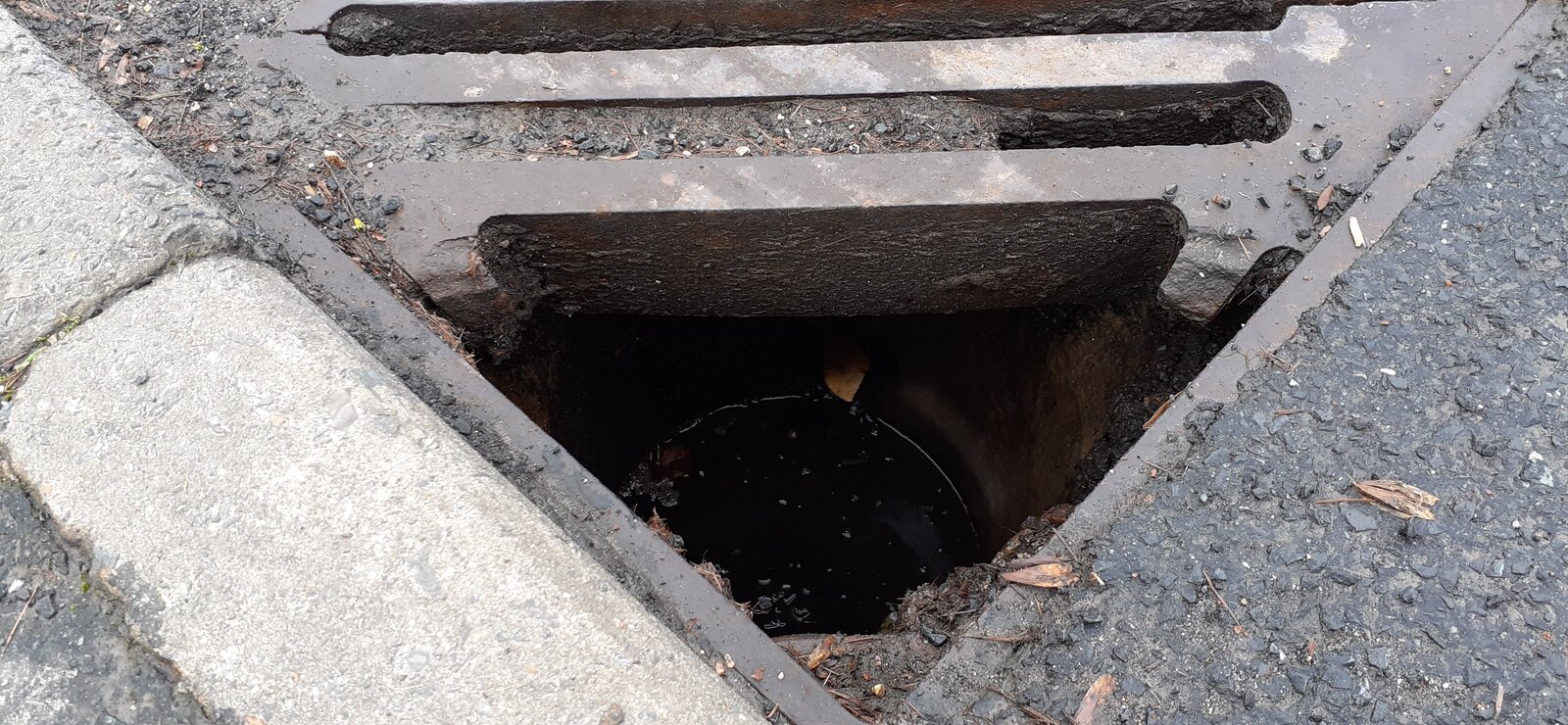

If you mean in series as in one runs directly through another, you could look into a gully, on the water level you should see an open pipe on the inlet and a capped access on the outlet (assuming they are clear of silts).

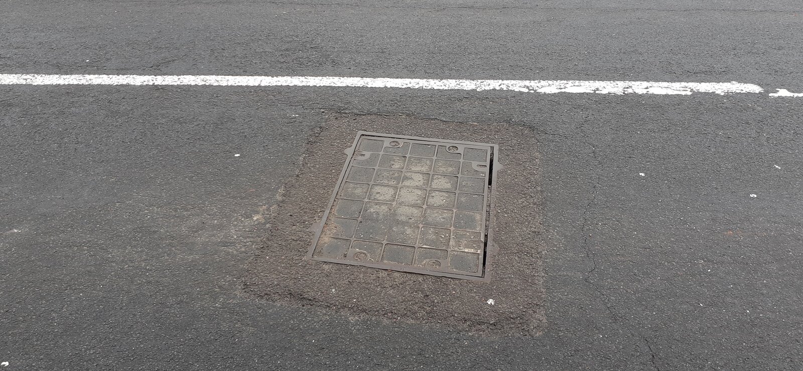

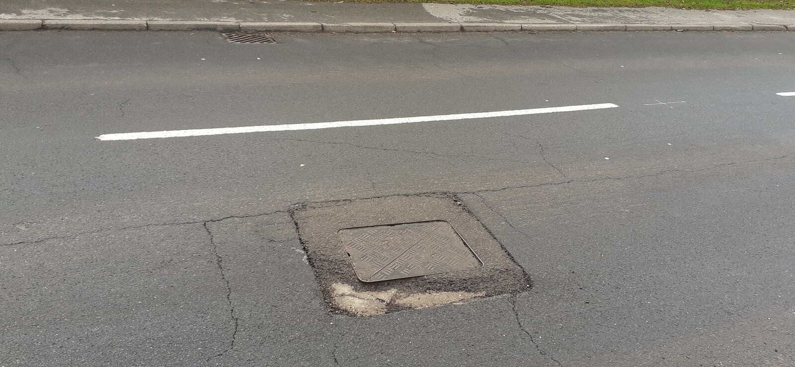

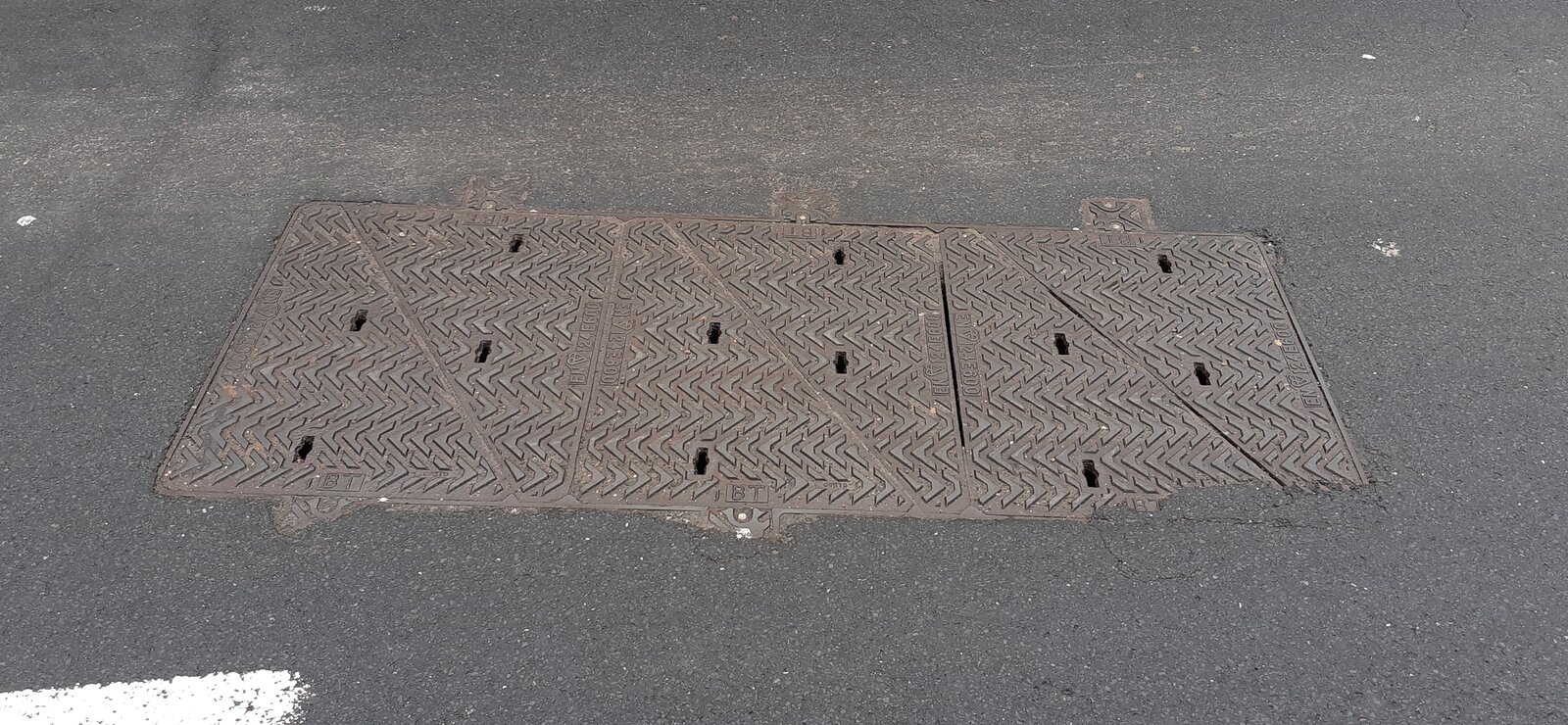

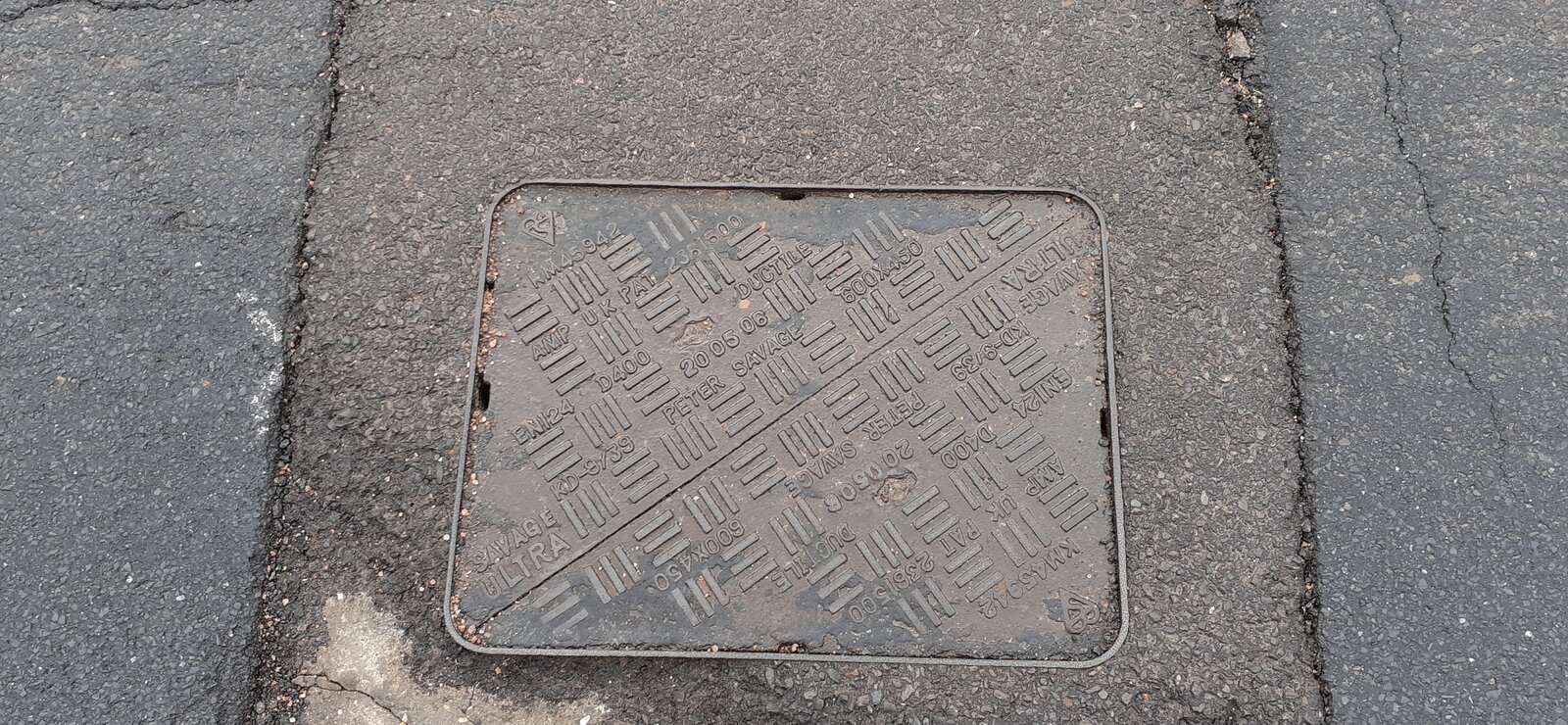

I have been out today and taken photographs of the various covers in the road. Just to reconfirm this thread isnt about toilet waste but is about drainage of rain water.
There are open grates where the road meets the kerb and then a series of different larger covers usually midway been the centre of the road and the kerbside. The broken open grate seems to have one 'outlet' pipe (in the direction of water flow) and does not appear to have an 'inlet' pipe.
